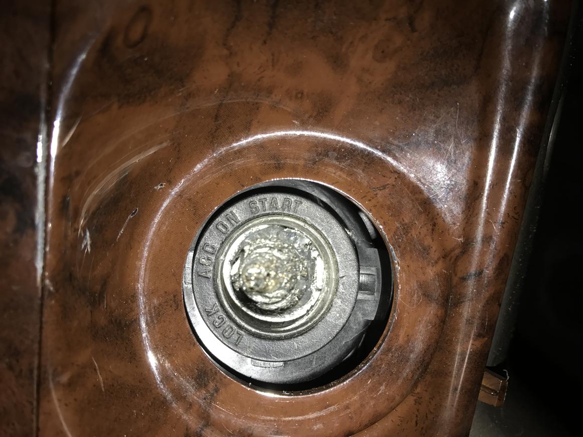

We had to drill it out to get it to start. Now all I need to start the truck is a flat head screw driver & the chip key close to the ignition:-)
But seriously, what could I do to fix this?
