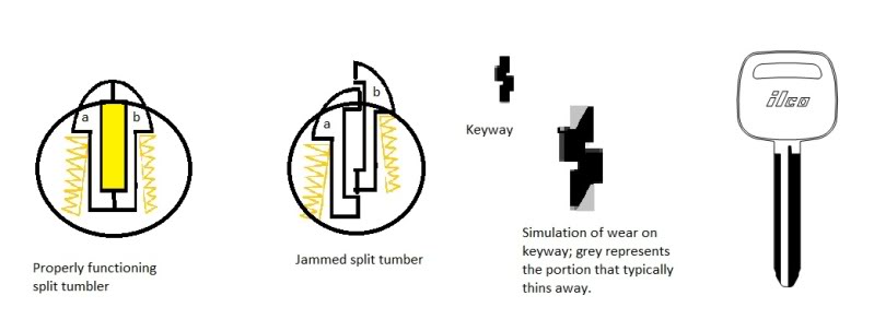

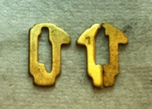

Ignitions are generally made with the wafer tumbler system and Toyota decided to get EXTRA complex and devise a split wafer system. (single on the left, split on the right in photo). So I don't know if the worn-down key is the chicken or the egg, but the split wafers get worn and dont respond accurately and slide into position so that the tumbler can turn, causing the jam we fall prey to.
If I can find a good locksmith I will find out if just the wafers or the keys as well need to be replaced...It sounds like both would make the most sense

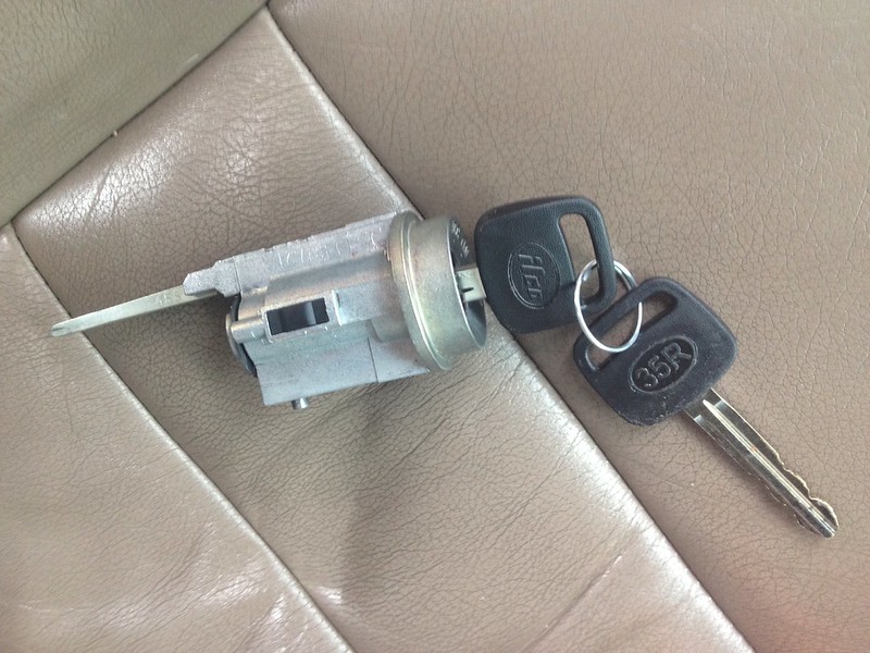

Just some more info on this matter.
I pulled my ignition cylinder and brought it to my local locksmith. They repaired the ignition cylinder for $20 and even made me a new key. A lot cheaper than replacing with a new cylinder and having to get re-keyed. Just thought I'd pass along!
