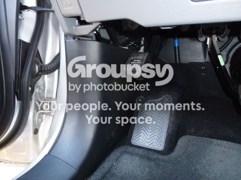

While working with the interior fuse box, I dropped a screw behind the driver's kick panel. No amount of inspection mirror and magnet could retrieve the little bugger (where do they go???). My background in aerospace will not allow my conscience to rest, knowing a piece of FOD is in the vehicle. To retrieve the screw, it looks like the kick panel must be removed. How is this done? There is but one fastener visible on the floor. This fastener is easily removed, but then what? How does the panel come out? Does snap on or someone else make a special tool to facilitate the removal of the panel without damage?

Pull up on the door sill plate and remove that first. you can wiggle you fingers under it and just gently but firmly pull it up. Once that is out of the way you can remove the kick panel once you have removed the screw.
In my signature below you will find a link to the 4Runner shop manual. Download it and make it your best friend :)

I've had my sill plates (and most of the interior) off several times. I use a panel remove to save my fingers but it's not needed to protect the sill plates. Just take your time and pull straight up.
thanks Okki,
Mission complete. Screw recovered and vehicle re-assemblied. Good as new.
