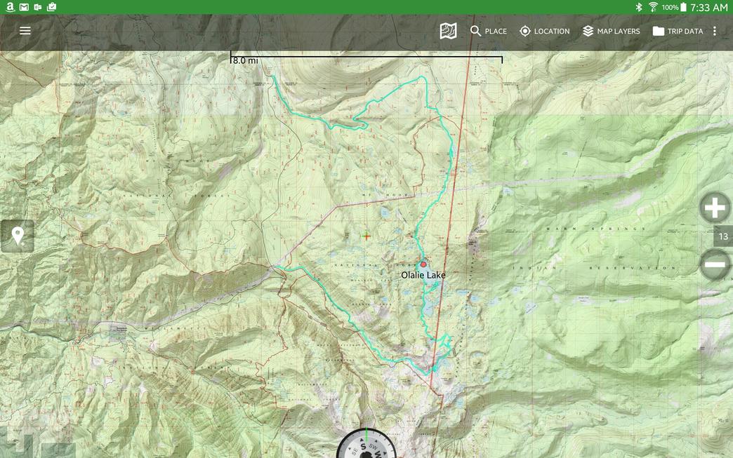

I run a smitty xc10k rated with a wireless control which I love! If you look at my story I used my winch for 2 hours straight on a single battery when in late June we ran into 6 feet of snow for almost 2 miles....
My winch isn't the fastest and even took it down to the last wrap where your not supposed to but had to due to limited strapping. Love my xc and now have a set of Maxx trax and started going out by myself. It's difficult when your..life is difficult and no one can understand, but I force myself. I record my ventures so my son can see them. I do always send my dad my route such as the picture below. It's a 6 hour route with 41 miles offroad!..
Any one in salem ever want to go I'm game, but please bare with me :( (most dont)
