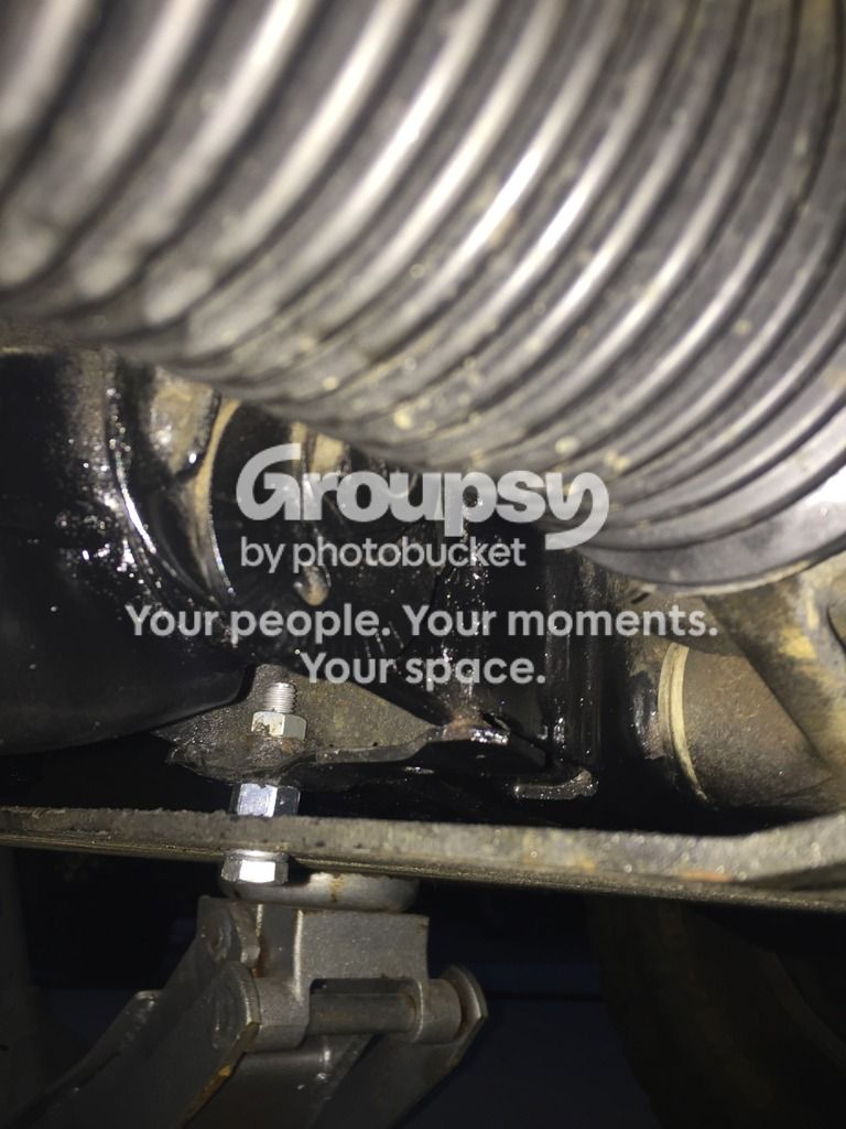

Fixed my skid plate bolt. It was stripped, the one on the driver side next to the lower control arm. I got a longer m8-1.25 bolt about 1.75". And didn't feel like re tapping the existing hole. So I managed to put a nut above the old welded nut. And also used a bigger nut as a spacer. Between the skid and the steering rack. Keeping a small gap between the steering rack and skid, without it the skid plate would basically be pushing on the steering rack.

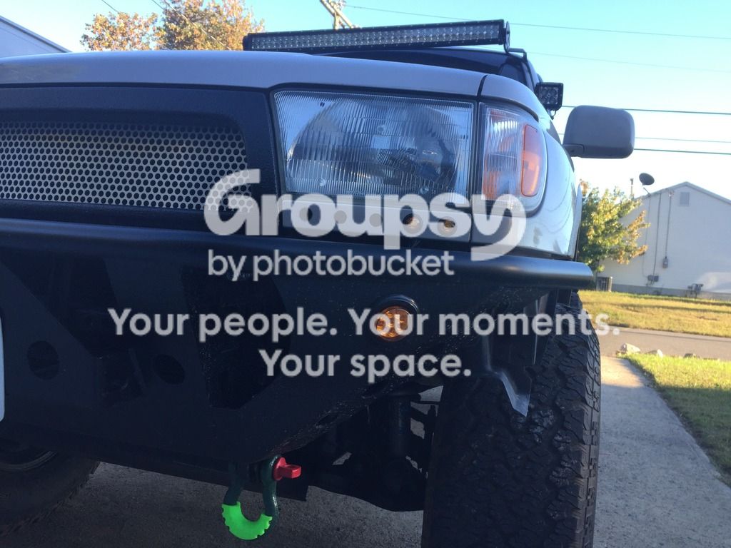

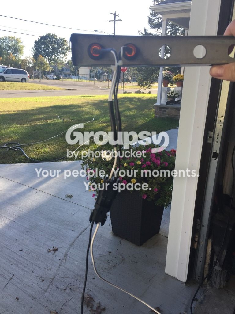

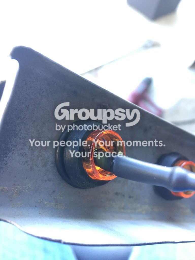

2 corner will be blinkers, the other 3 will be day lights. Or with the lights on.
I put a o-ring so it seals and holds the little lights better.

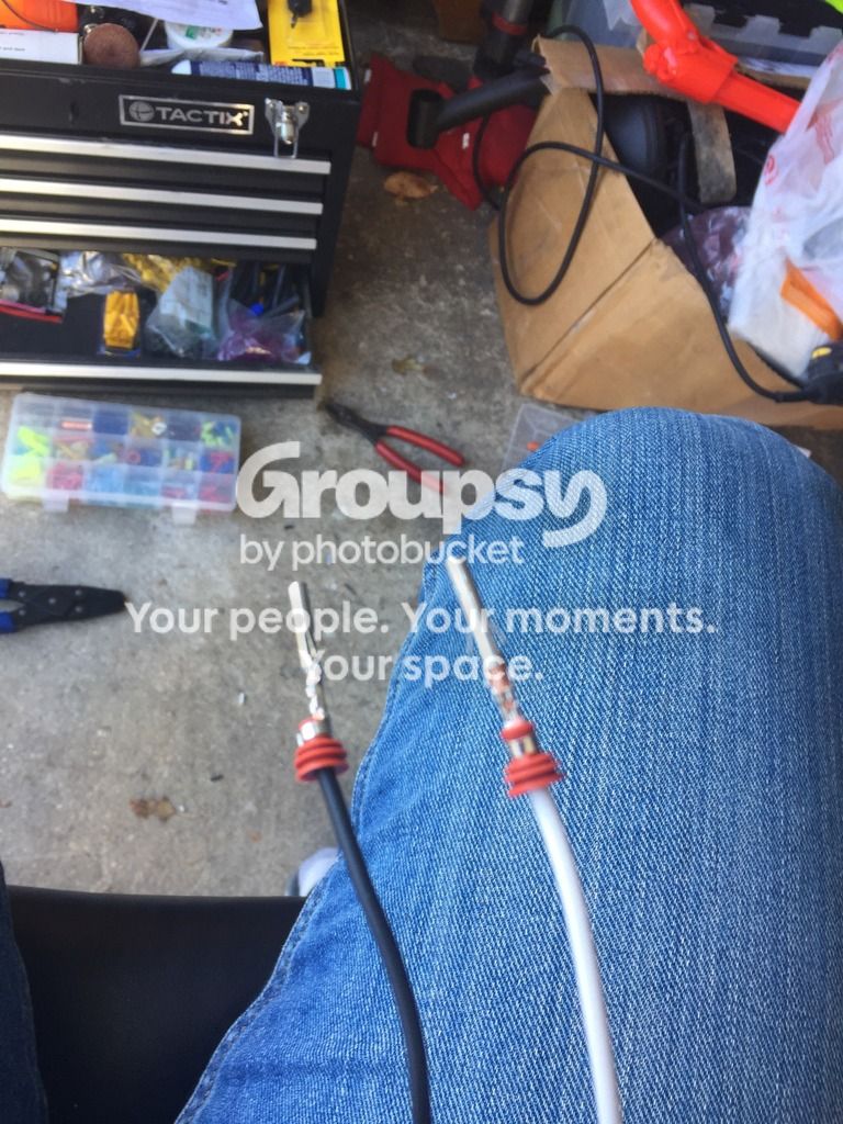

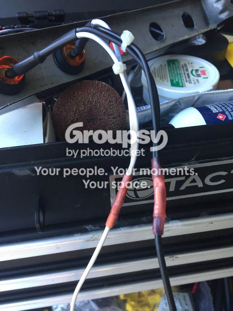

Putting the blinker lights into one harness and the white lights will be a separate harness. Incase you need to do maintenance or something you can just unplug it. So I put two wires together into one.
Bought a Delphi weather pack of Amazon for $10. It's like 10 dual connectors. 5 make and 5 female.

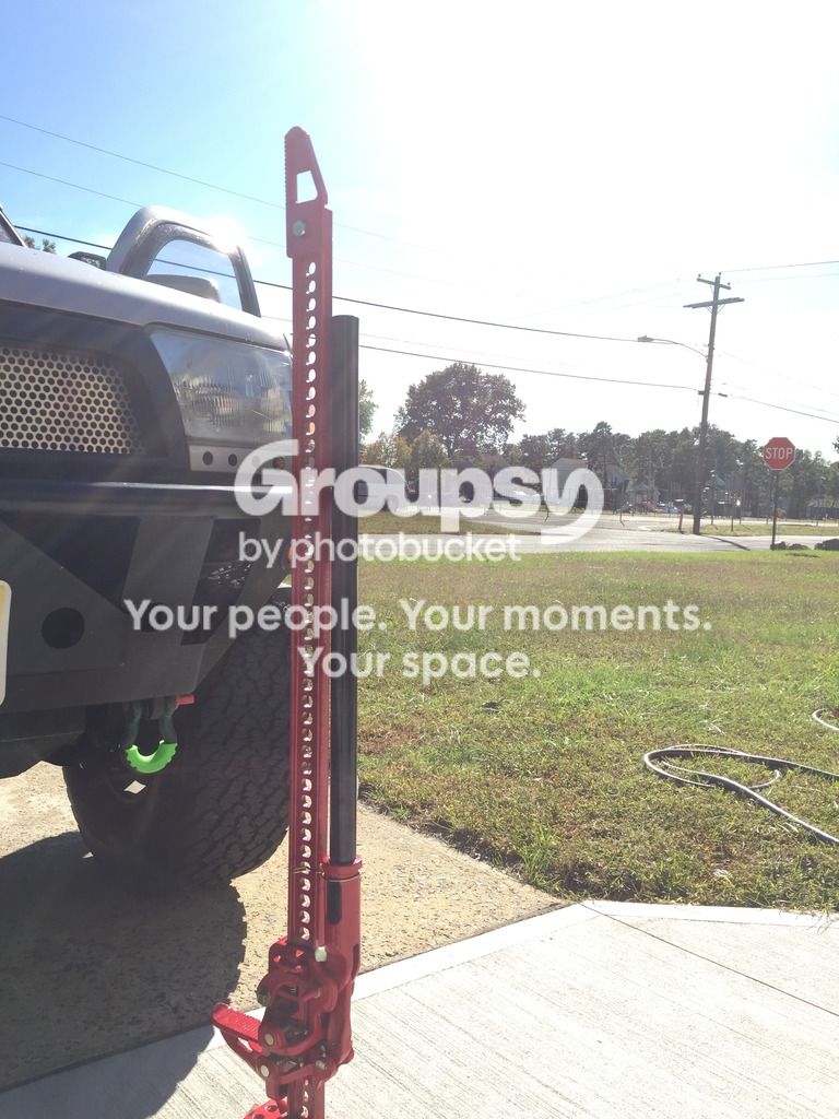

Got a 48" hi lift jack. All cast version. Also ordered Sonoran steel hi lift jack mounts for the back trunk.

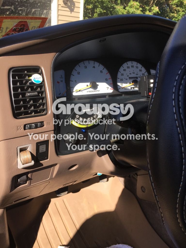

Installed this little level. I think it's good to have when your using the hi lift jack, or off roading on hills. Good to have. Used scotch 3M 10lb Velcro to attach it.

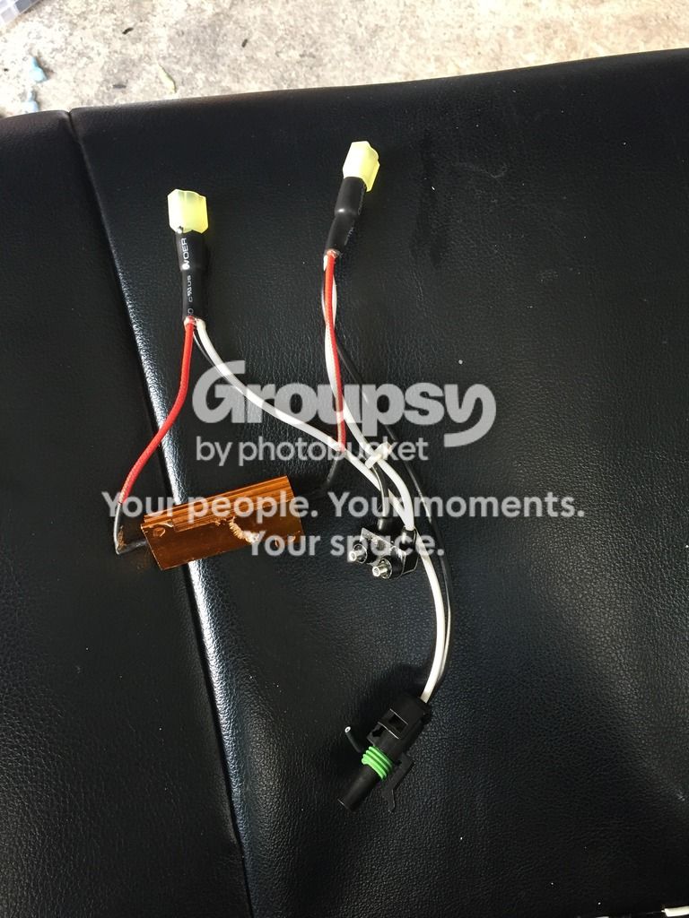

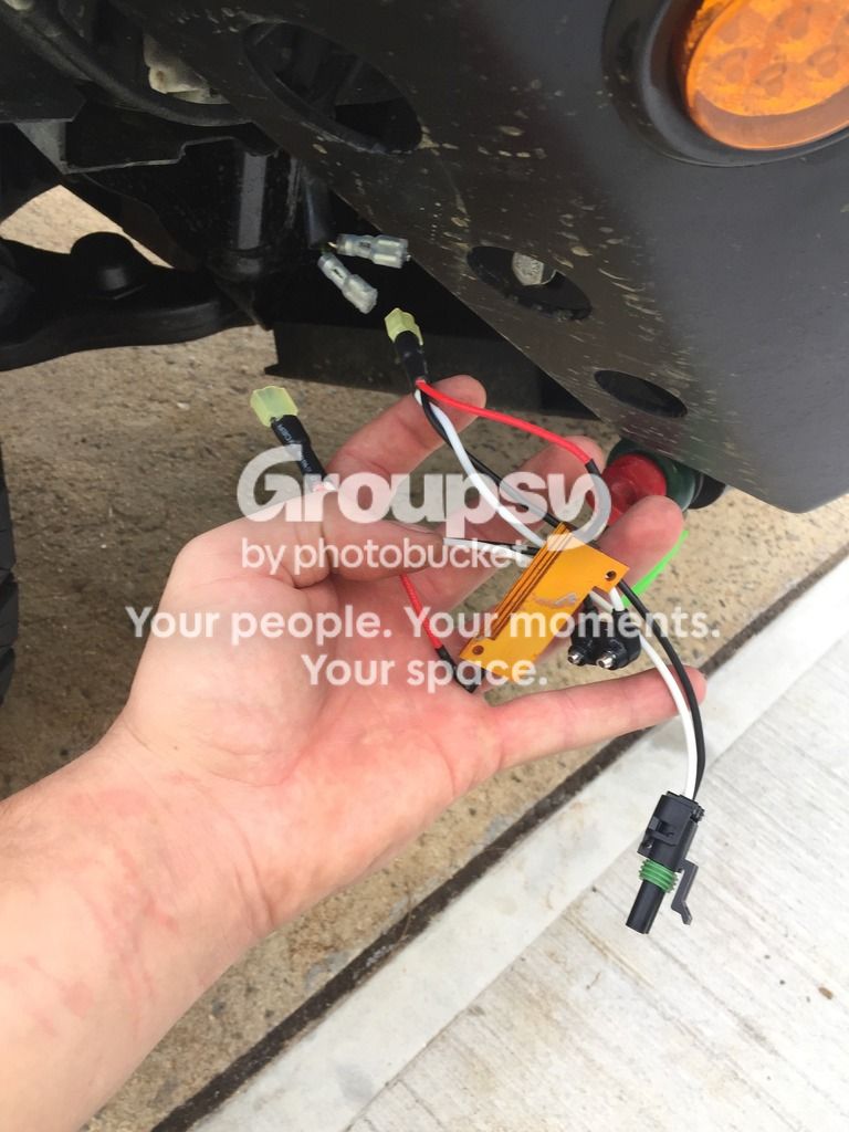

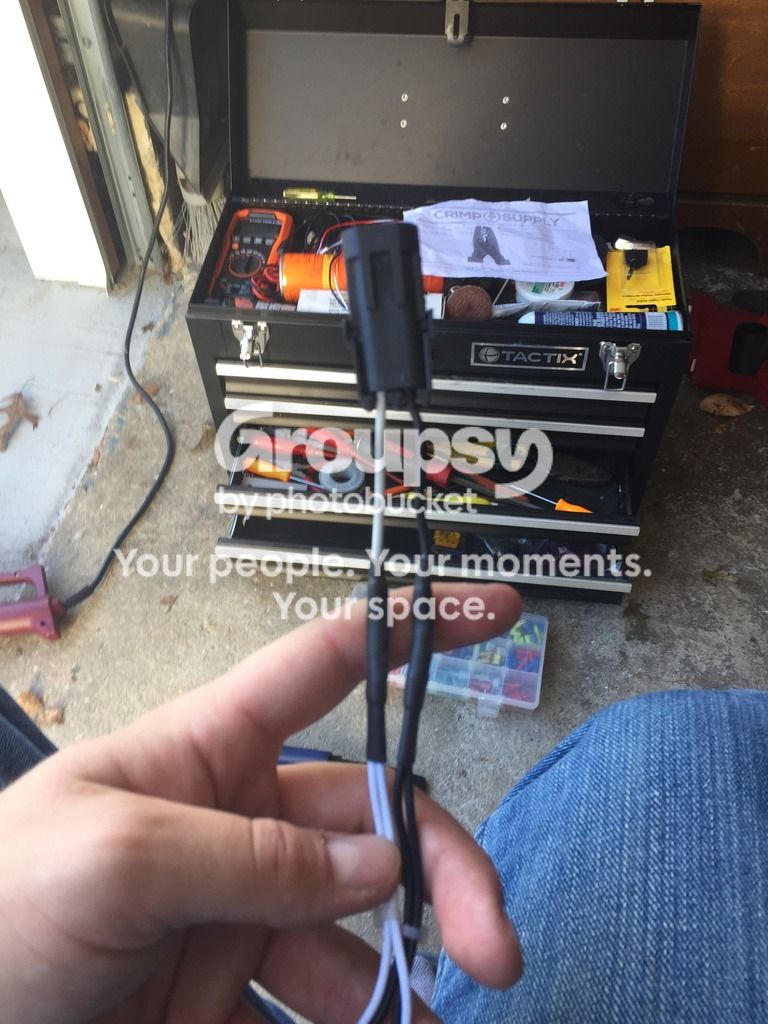

Finished up on the harness for the blinkers that I put on the filler panel under the headlights. Just today I received the white LEDs. Which will be ON with the headlights.
The bigger plug is for the new blinkers. Incase you need to maintenance you can unplug everything in one piece. Very easy. I will do something for the white LEDs. Separate harness.
Test fitting the harness that goes into the white LEDs from the OEM lights
The little harness that t-taps into OEM harness and runs back to white led
Even though t-tap isn't 100% waterproof. I made sure I used electrical grease on EVERY T-TAP to prevent corrosion. Plus I feel safe about it. It's Hides behind the fender.
Harness perfectly measured so there's enough room to grab it and connect it together or disconnect
I used quality marine shrink wraps, quality electrical grease. On EVERY CONNECTION including t-taps. And even inside the weather proof Delphi connectors. Everything is easily removed in pieces for easy maintenance or in general.

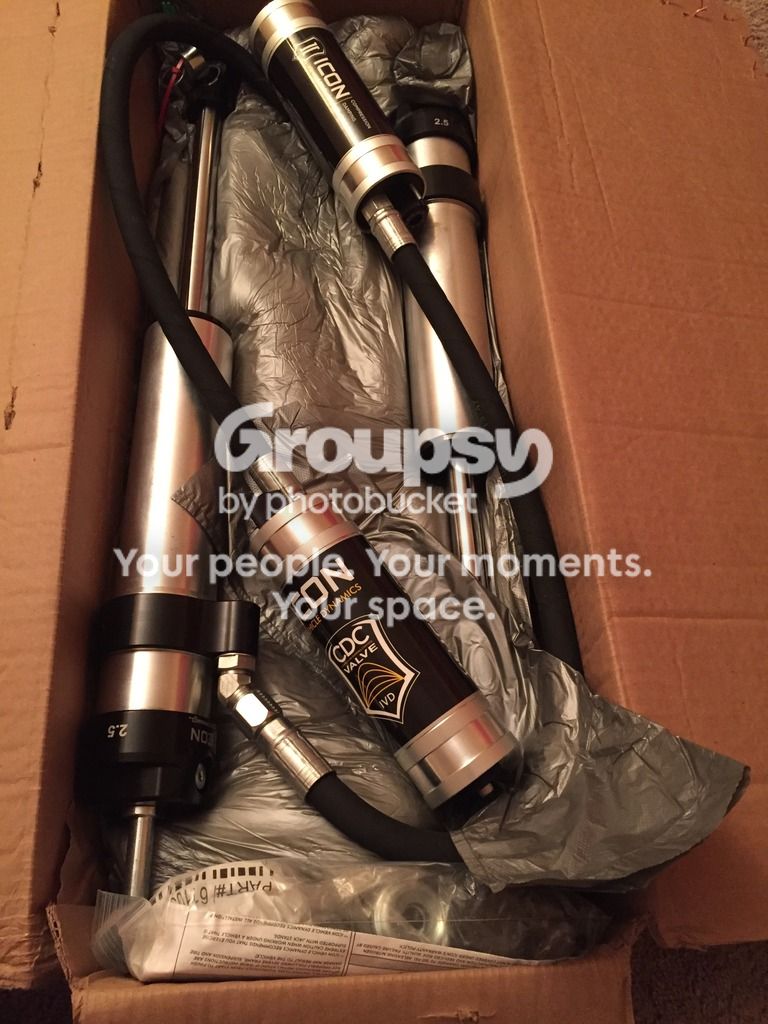

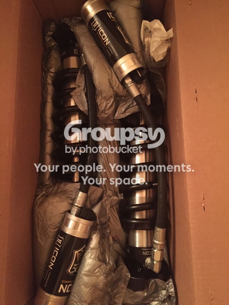

Got these today. Icon 2.5 CDC rear shocks. They are actually for 034runner but are perfect for Toytec superflex.
Waiting on the front ones.
Ordered from Chas, MRT

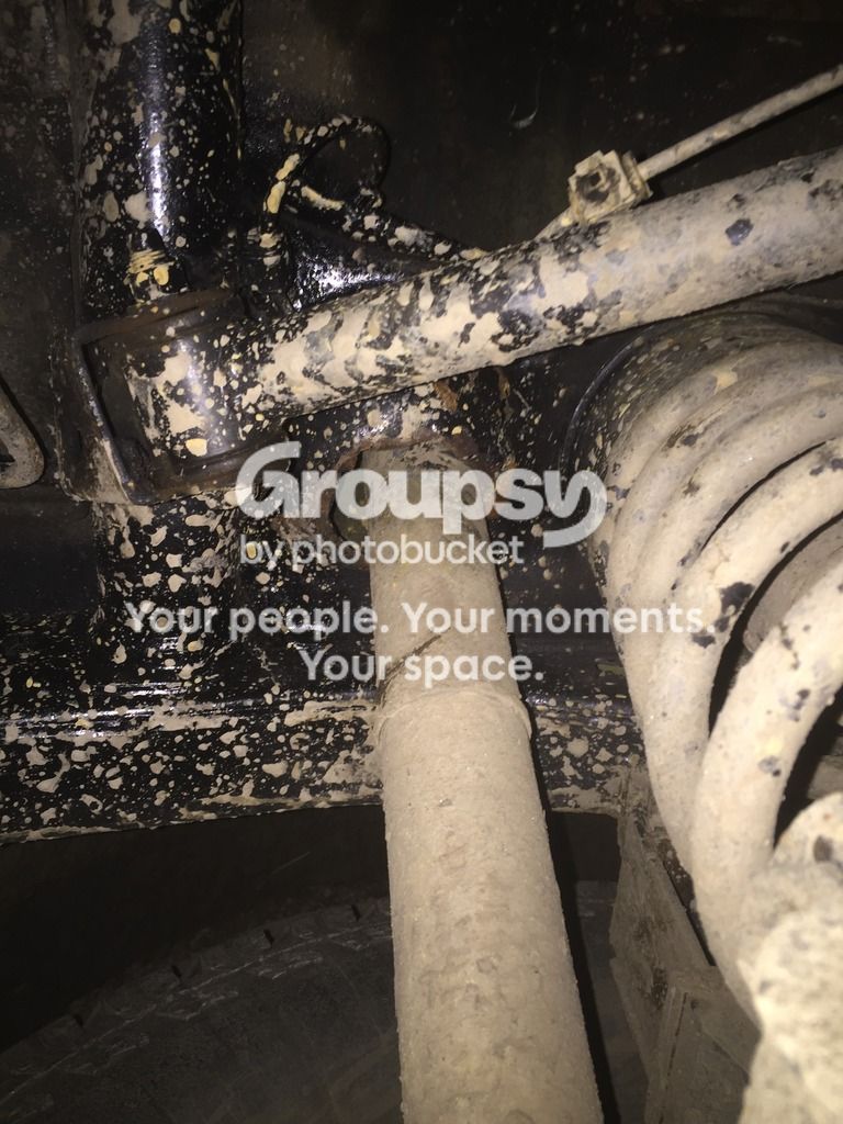

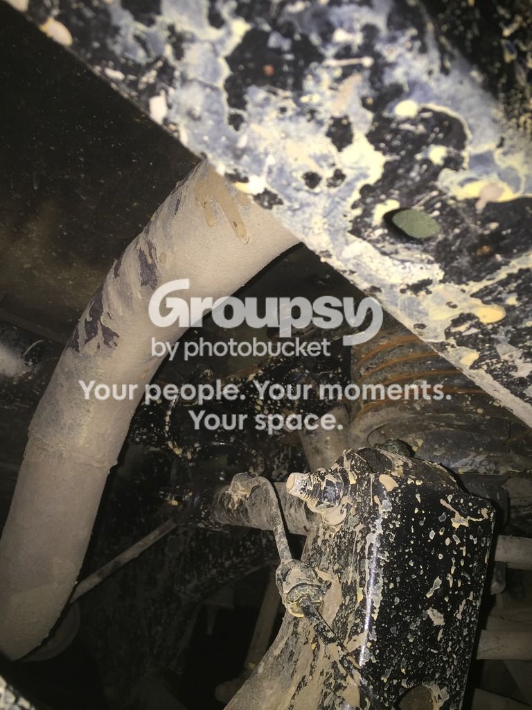

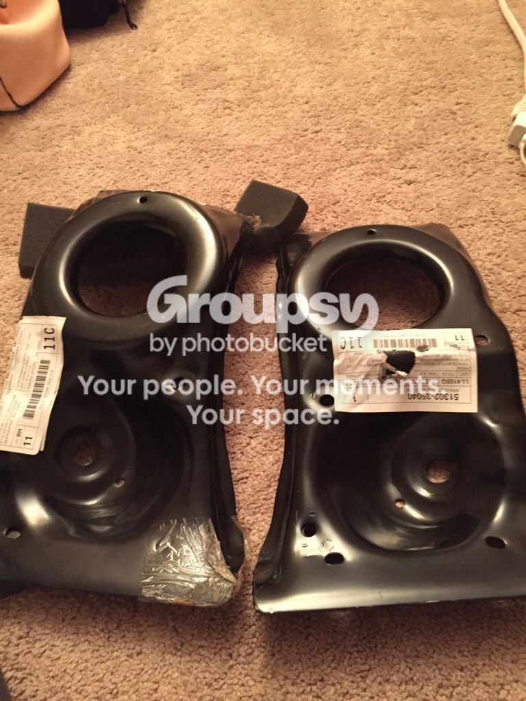

And so my rear passenger shock tower rusted and the shock pushed through. So I got a really good deal of a OEM website that is located in Pennsylvania which is very close to NJ. They were the cheapest website for OEM parts. Was just under $200 shipped.
They come painted to. It's basically the whole shock mount and coil mount. Shouldn't be to hard to fix with the whole axle out. At same time I'm swapping my elocker in.
And got my front icon CDC from Chas.
So glad I don't have to deal with rust. Good luck
Thanks. I honestly do not have rust on my frame as much as you'd think. But unfortunately that part of the truck. The shock mount took a poop and was the worst. If you'd see under my truck. You'd be surprised. Just look at the first page.
I always clean out the top of the shock mounts. Pita but so much dirt just sits in there. Bad design.
