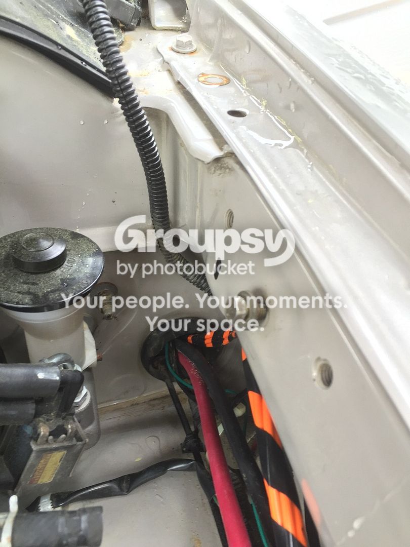

Ran the 2 4 gauge wires and 5 12 gauge wires. Red 4g wire is positive for fuse box. And black 4 gauge is for a AMP later.
I don't know how. But everything fit through the original hole in firewall

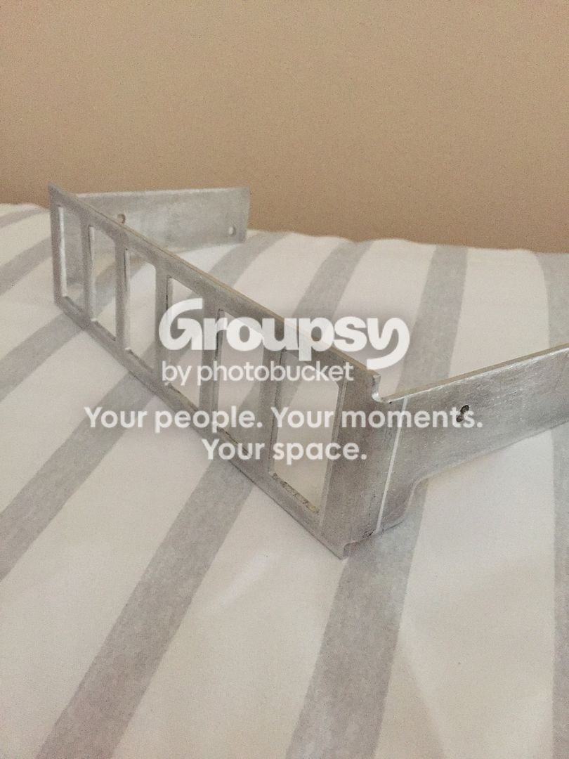

Switches installed :)
And pic of my dash
Did you have to modify the switch insert? I checked out the site you posted but noticed it's all Tacoma stuff. Just want to be sure I'm getting the right piece. Thanks
No sir. The first gen Tacoma is same as our 4Runner for the switch plate. The only thing that won't fit is probably the plate for the clock that they make. I just had to file it a little because the inserts for the switches were very tight. Better tight then loose though.

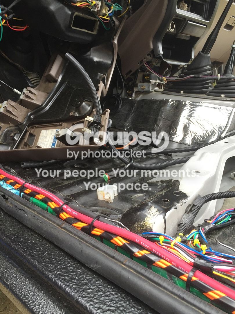

I know it has been said before, but this is a very impressive build because of the attention to detail. I am very obsessive over neat finish, and wiring being done right the first time. (borderline OCD) I love how you have done this and hope you don't mind me borrowing some ideas. I have a question though, Having run wires through this area before on several other cars, have you tested to see if the threshold trim will fit back over the wiring run through here?

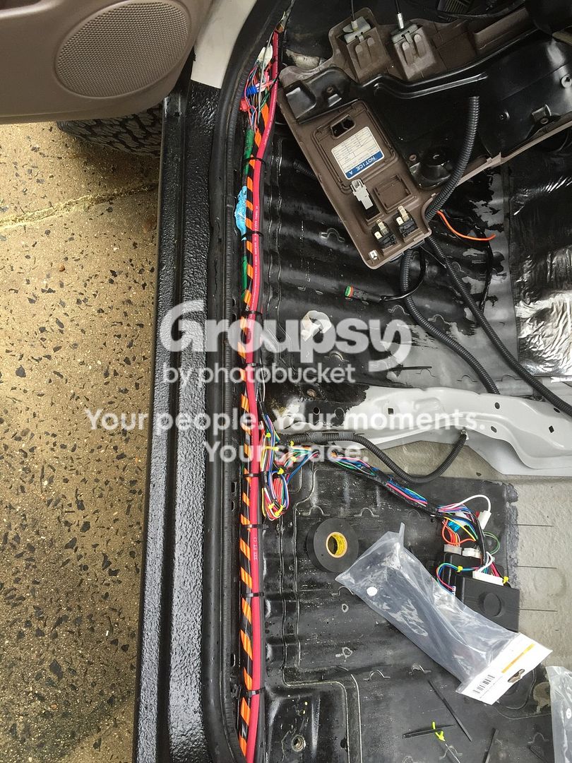

They fit, but only after I removed one of the 4 gauge wires. This wire was my 5 channel amp. So I ran it through center. Now that said, I had to trim the trim pillars. It's easy. You can actually see where the wires sit and you trim it. On the underside of it. And with a little cursing and playing around it fits.
On the driver side I am running the following, one 4gauge wire. Five 12 gauge wires, and some extra wires near the driver seat which are small but are for viper alarm. So that adds thickness in that area.
Through the center I have running, one 4gauge amp wire. Ten 14 gauge wires.
On the passanger side I have ten 16 gauge wires, 3 sets of rca wires and a 9wire.
Everything is taped with 3m tape into seperate harnesses. And I used wire look to go over it so it adds extra protection.
All wires are covered in this.

I ended up taking the the red 4gauge wire, the black 4gauge wire and the orange set of wires coming out of the gromet under the hood and put them individually into the wire loom also.
Reason for the 5 orange wires is so I can easily tap into them for my accessories. And I already have my switch and power wires under my head unit for the rocker switch. Which eliminates the need of that ugly light harness.
