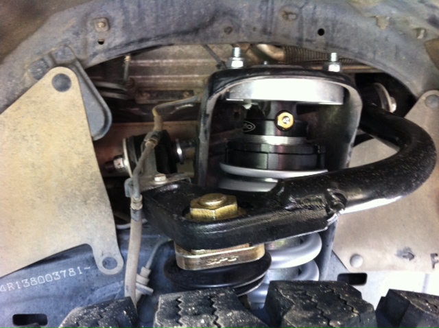

Did you set the UCA to the "D" setting which yeilds +2 caster or "A" to get the +4? Im at the "D" and get some rub on the front driver side. Thanks!
The setting is supposed to be zero(SPC logo facing out) and then they need to dial in caster/camber with the lower eccentrics on the LCA(lower control arm). The reason being even at zero they are 2 degrees more caster then stock. I tightened the top nut just a little inwards from all the way outboard(about 1/4")
Like this
Like this
Thanks harper! I currently have it set as you stated above. I still have a little bit of rubbing on the backside of the front driver side. I wanted to avoid cutting the liner but it may be the only way. I have already used your other post and moved the front liner forward. Appreciated the help!
More Positive caster adjusted from the bottom aft eccentric will move the wheels forward . Around +4.0 or more seems to be the caster sweet spot on 5th Gens if you like stiffer steering. I didn't like how I used to have to constantly steer the truck on some highways before I changed mine.
