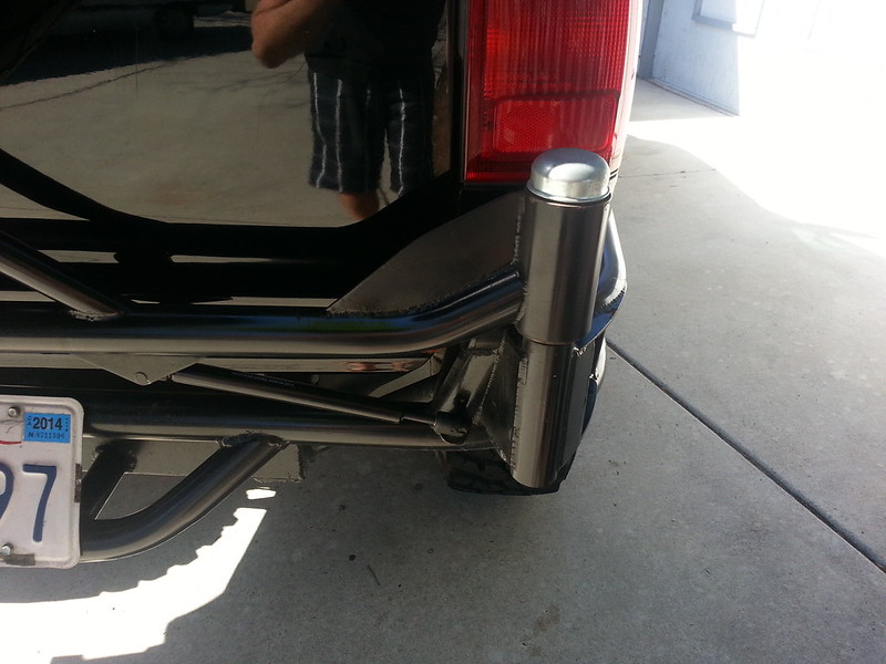

the rear bump
Hi!
I really interesting about your rear bumper and tire carrier. may I see some pics of it? I want to know how it works.
Thanks!
Hi!
Thanks!

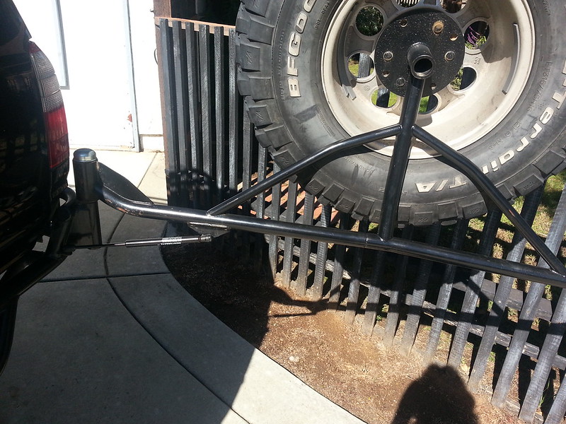

Sure, I'll take some pics when I get a chance. [MENTION=67615]Dirtco[/MENTION] has the same type of carrier hinge it looks like though, you could check out the last couple pages of his build thread for some awesome pictures in the meantime.

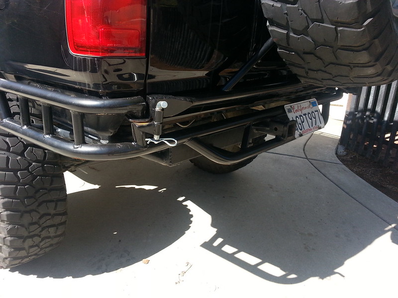

Almost forgot about this. Here's some more pictures:

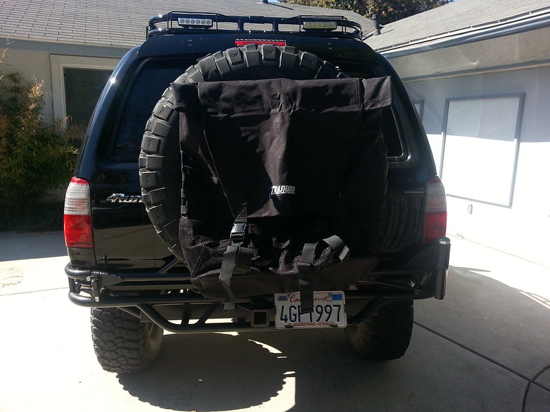

And while I was out there, I test fitted my new Trasharoo:
It's going to be very useful on camping trips. I found out the hard way that it's not a good idea to put trash bags, full of mostly empty beer cans (among other things), on the roof rack. Whatever was dripping out of those bags destroyed my paint on the roof in some spots lol. The Trasharoo should solve that though.

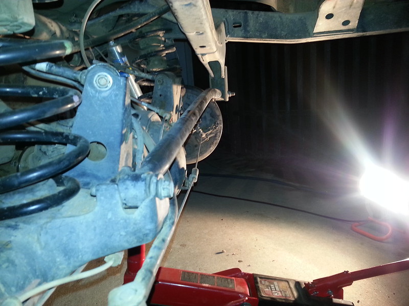

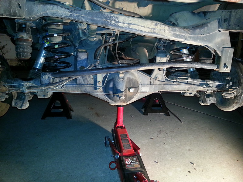

So I go out to my 4runner tonight to get a couple things taken care of before a weekend of epic runs, and I see this:
I'm not an expert or anything, but I'm pretty sure that's supposed to be straight haha. There's some minor scrapes on the bottom of the bar, but nothing that looks like it could have bent it like that.
How did I manage to do this? Anyone have any ideas? [MENTION=92884]snivilous[/MENTION] you have any ideas?

Holy shit! Well the panhard bar only works in tension and compression obviously (as all pinned-pinned members do) and obviously is only meant to keep the axle from moving side to side, so if it got buckled from being compressed part of it would start to kick out. BUT the only way that would happen it seems would be if you got a HUGE side loading on your axle (or the body) and it was so violent the body/axle couldn't move fast enough so it partially buckled which honestly I don't see how that would happen. Also, I haven't learned how to do buckling analysis but it would seem it would buckle in the middle, not like 1/3 of the way down...
So with that in mind it would seem like it got bent some other way, which from the second picture it almost looks like it's slightly bent forward but maybe that's from the camera angle. I would put my money on you backing or somehow landing on the panhard which bent it up like that. My other idea was from the first picture if it got caught on the differential and flexed it would try to bend it halfway from the diff to the frame mount but that's insanely unlikely too. It seems hard to go and land only on the panhard with all the other shit on the axle, but it seems possible and more likely than anything else. Ever remember any weird bangs from back there?
I think you'll be fine in the meantime, but I would be careful driving too since anytime you turn the panhard is being worked, probably more so than when you are offroading since when offroad the rear tires will slip; though obviously you should get it fixed :D You're quite the beast at breaking links :boxer:
P.S. - That rear cross member is really throwing me off, I didn't know it was angled down so much haha
I vote hitting something. I think the mounts would rip off before the tube bent from a side impact.
