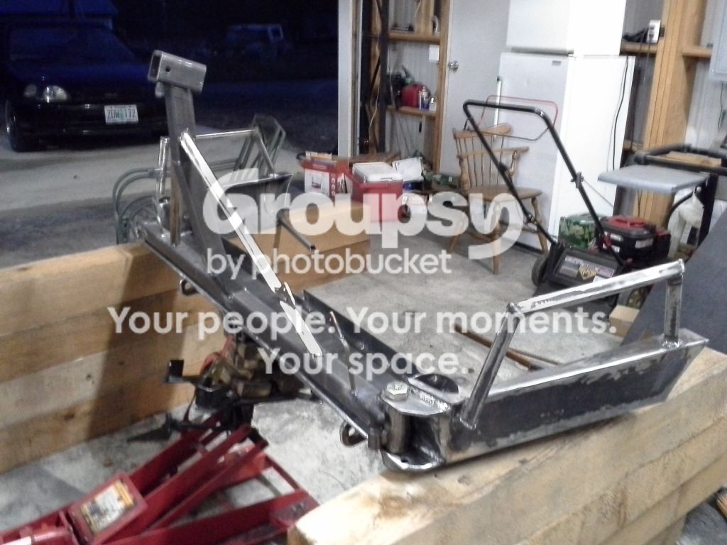

More on the bumper today. Can't play in the shop too much for the next couple weeks. Need to keep studying for the rating exam. :thumb:

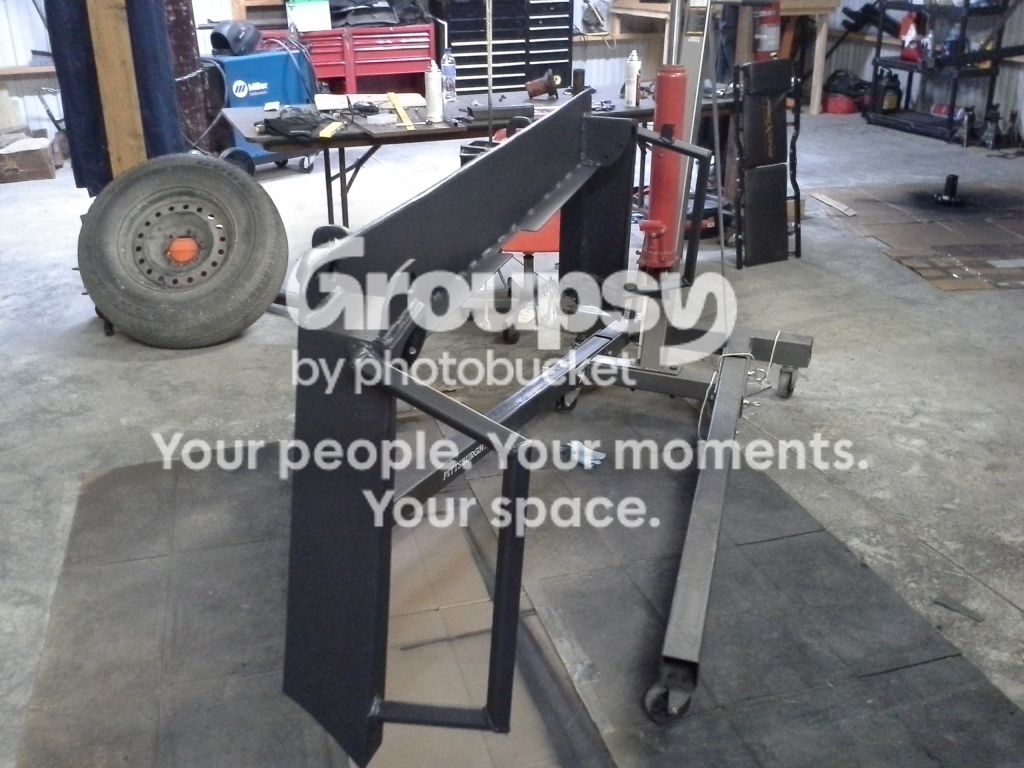

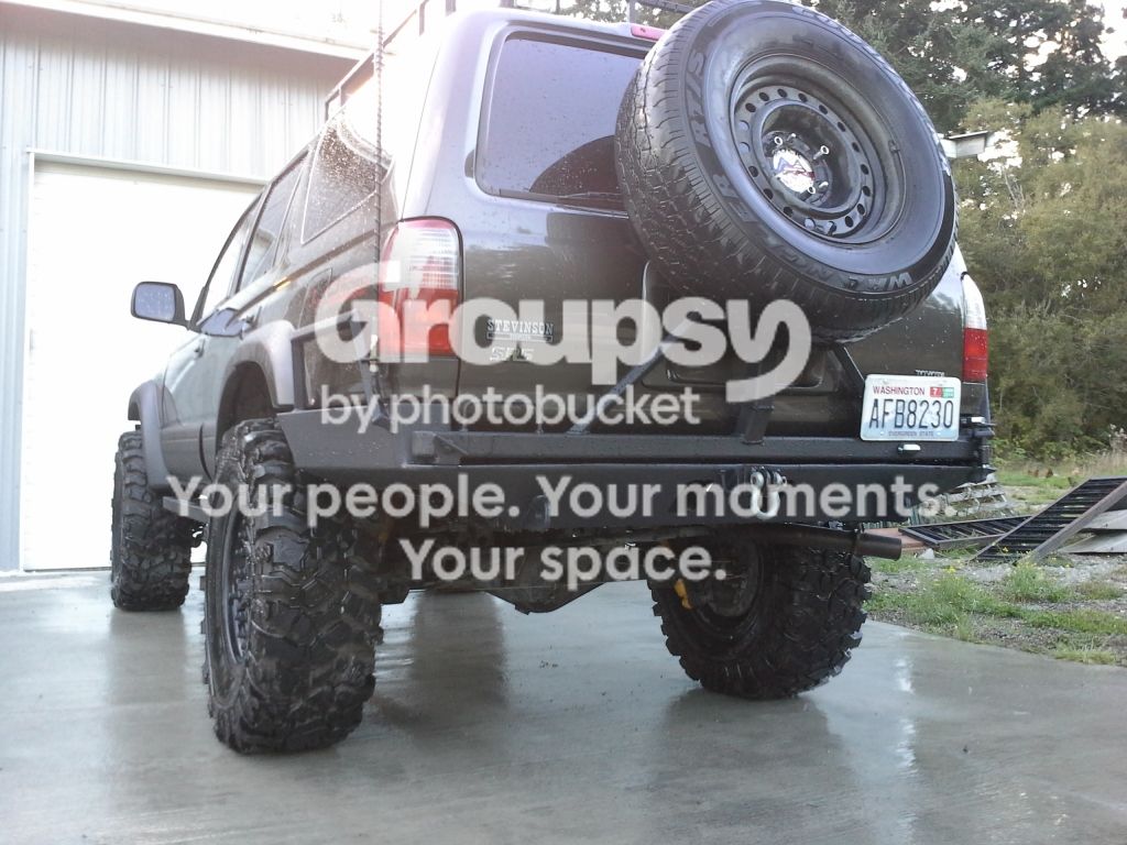

More on the rear bumper. I didn't get to work on the bumper as much as I would of liked this weekend because a raccoon claimed the lives of our 2 ducks. I spent most of the day turning our chicken coop into Fort Knox and yesterday cleaning up feathers.

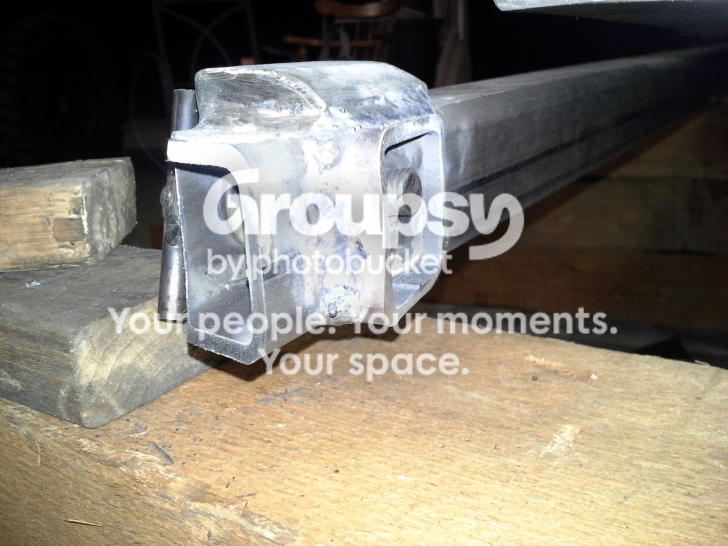

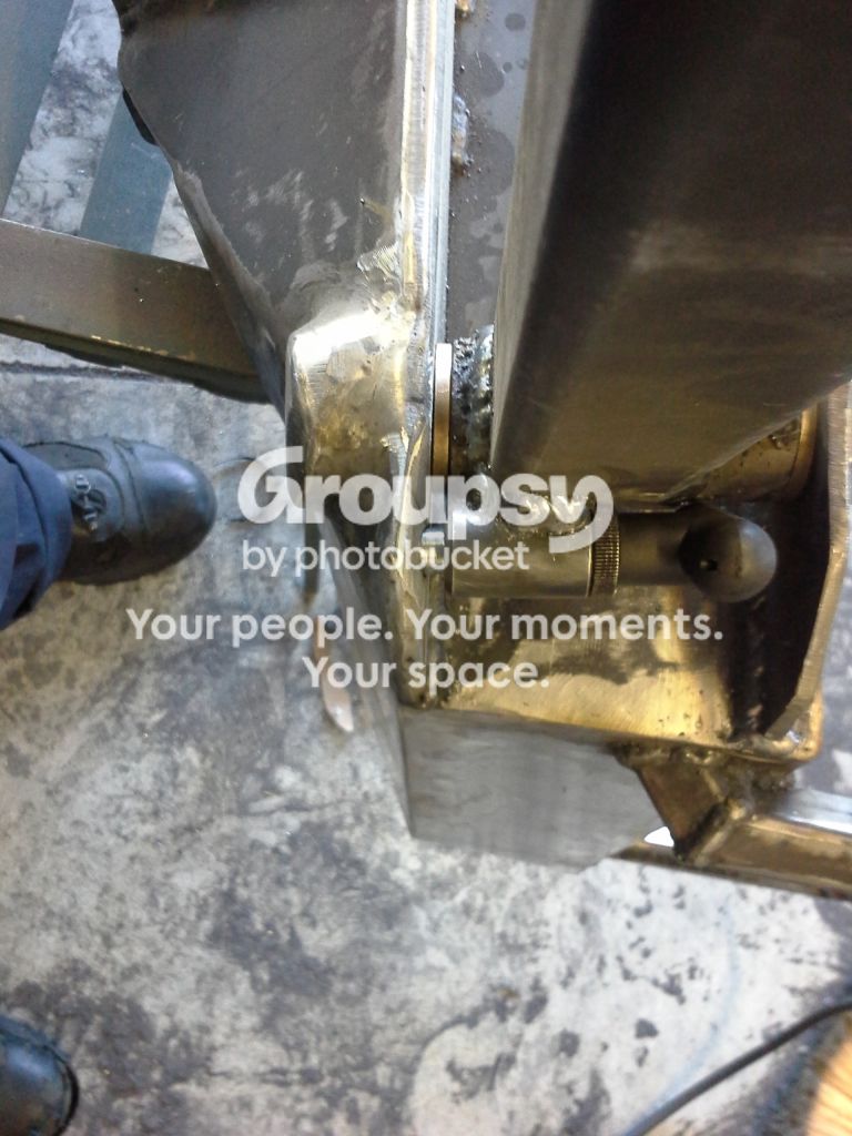

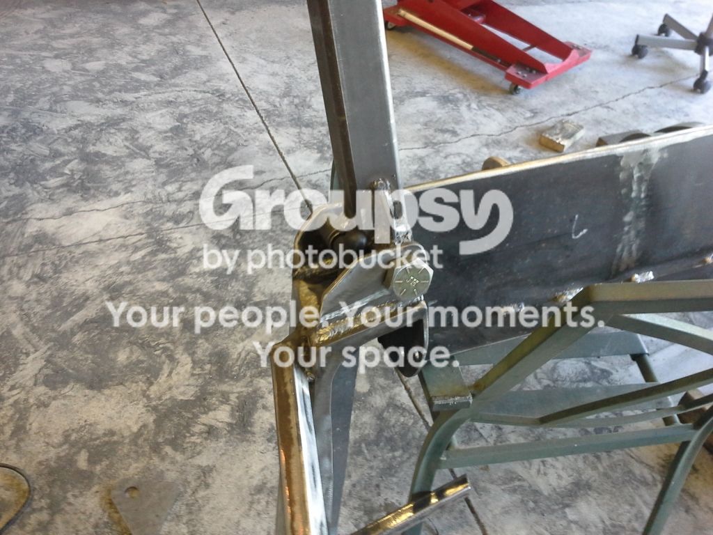

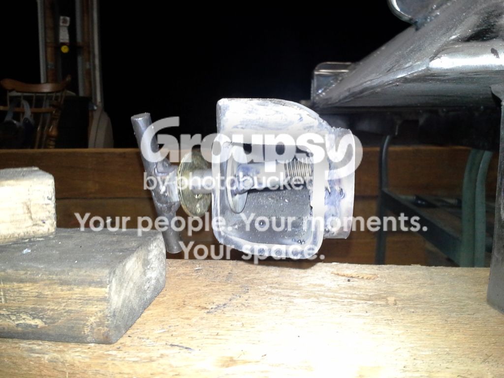

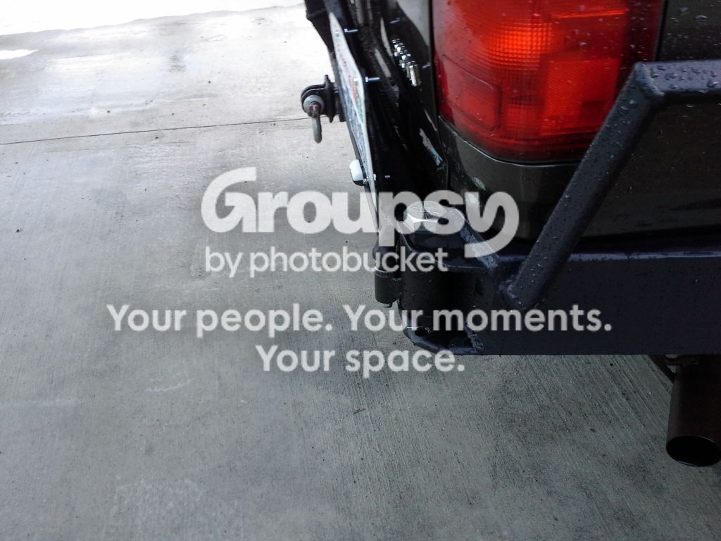

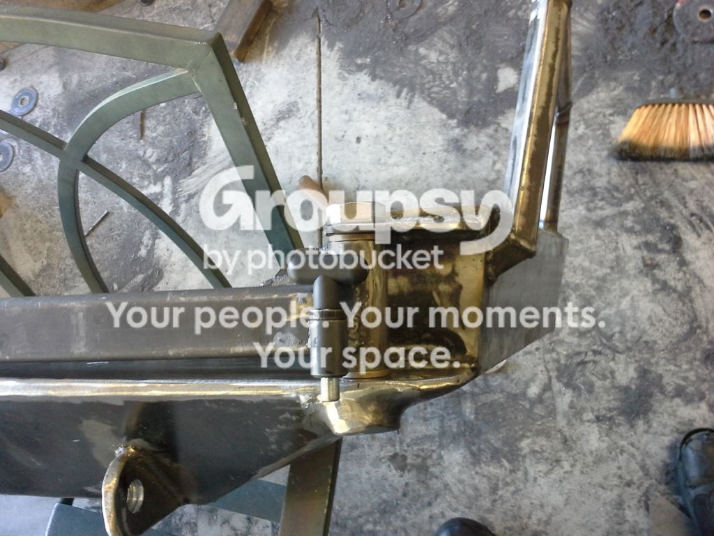

This is what I came up with for the hinge. It's double sheer. I did expect to have to drill a hole in the bottom to facilitate getting to the nut. I could of left the hole open but I didn't want to mash it on a rock.
Automatically locks.

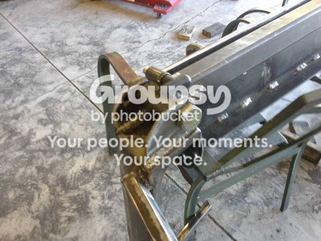

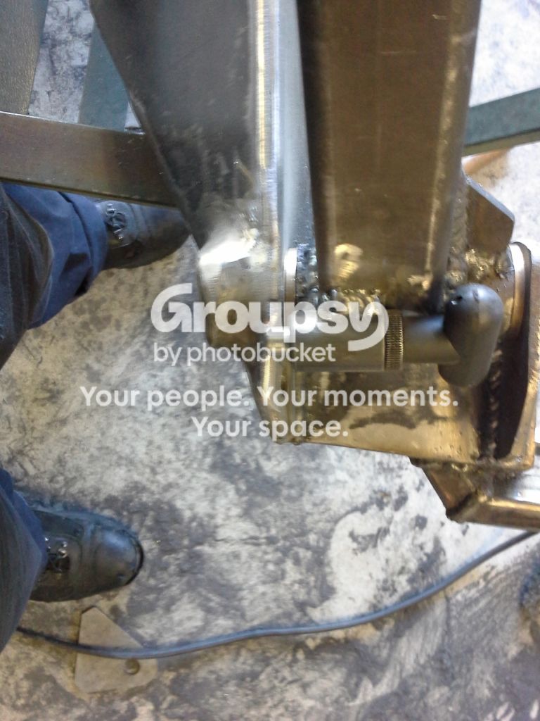

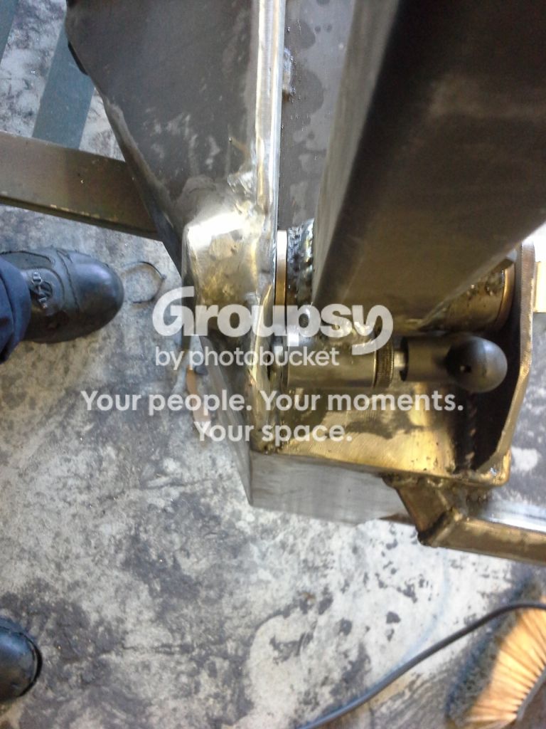

For the latch I used a 1/2" Grade 8 bolt and welded a handle on it with some 1/4" steel rod.

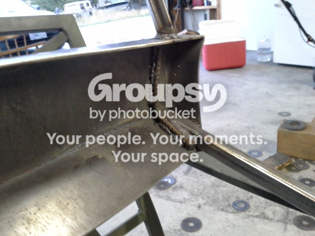

I welded a washer on the bolt on the inside of the 2" square tube to make it captive. I only tac welded it incase the bolt ever breaks on the trail I can beat it out and just slap another 1/2" bolt in there.
I also made the main support beam mate with the bumper nice and flat so it will help take the load of the tire and won't over stress the 1/2" bolt.

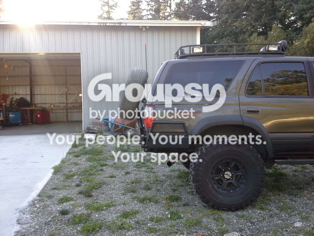

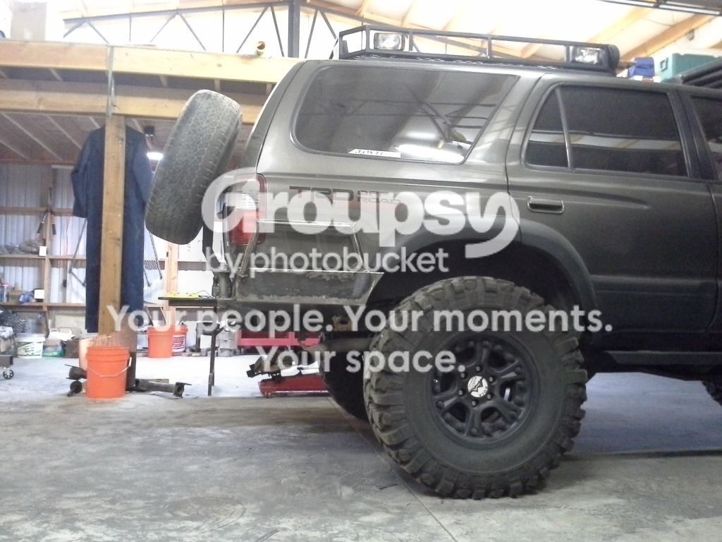

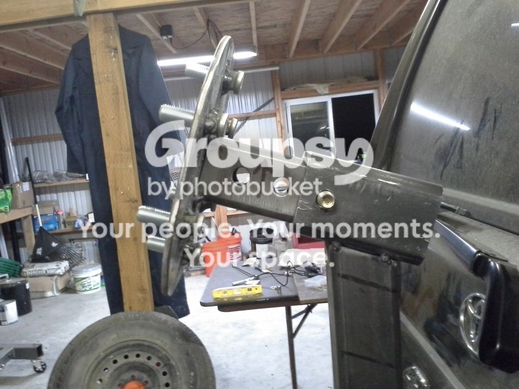

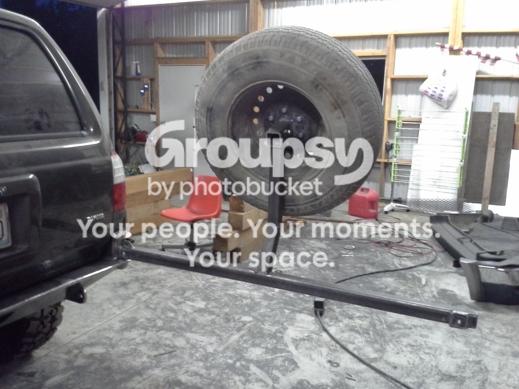

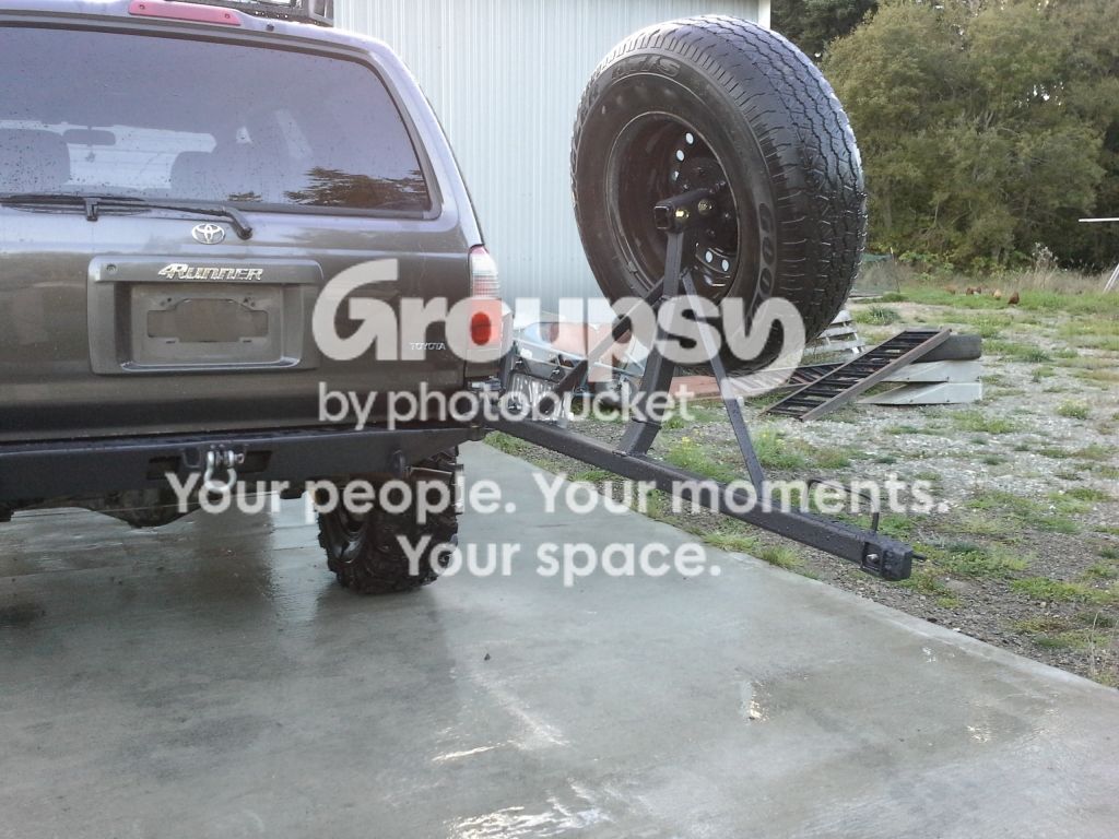

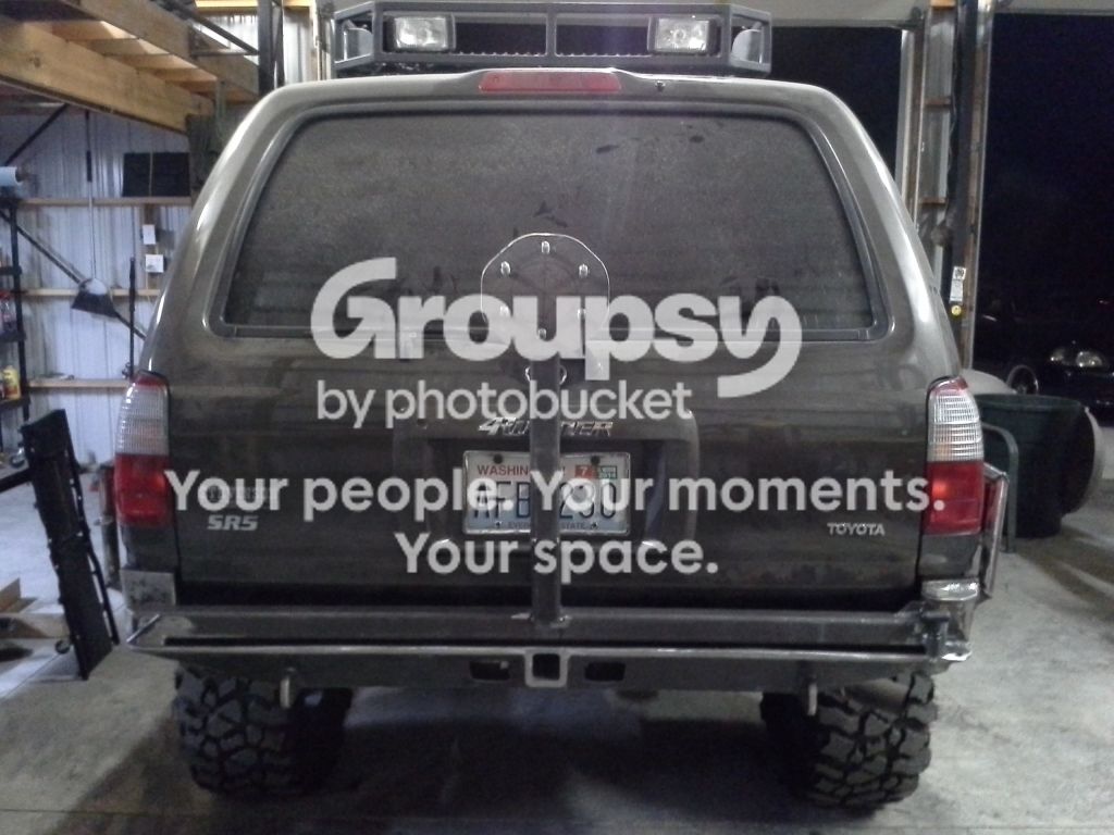

I mounted the tire up pretty high so I wouldn't be affecting the departure angle. I had to choose between a departure angle and visibility. I chose departure angle since the visibility was pretty much gone anyway.
I sleeved a 2"x3/16" square tube inside a 2 1/2" x 1/4" and drilled a couple different holes for different tire mounting. I am planning on keeping a 33" tire on the back but I only makes since to be able to put one of my 35s on there if I ever need to.
I chose to tilt the tire a little to help keep it nice and tight to the hatch.
Visibility, gone.
I still have quite a bit of work to do but it's getting there. I am going to run 1" square tube to brace the tire carrier arm a little better from lateral pressure.
Hopefully I can get this done soon. I haven't driven the truck in a while. I've been considering wheeling in my back yard...

Looks great! and stout.

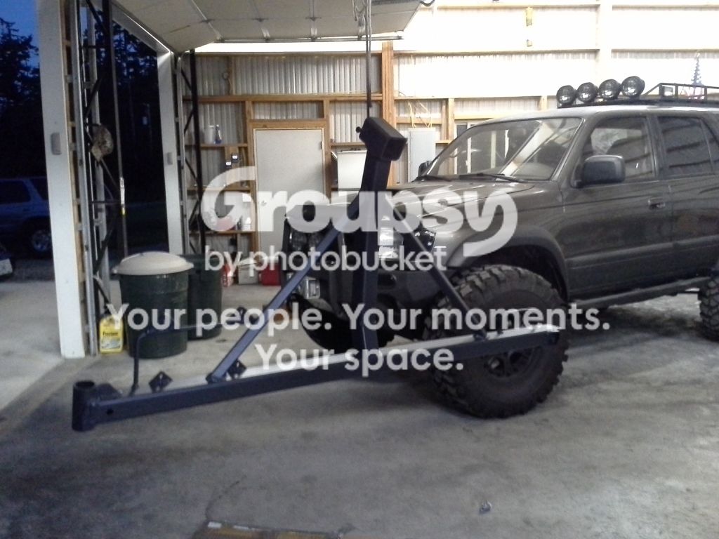

With regards to the spare tire upright; did you v-notch the square tube, bend and weld? I want to rework my spare tire height and angle and will be using square tubing. Thanks!
Looks good man I like it angled with the hatch
Thanks man.
I didn't v-notch it. I made a plumb bob and figured out the angle by how much I wanted to clear the hatch and rear wiper by. Then I just cut each piece of square tube at an angle that was 1/2 of the over all angle. <---Hope that makes sense.

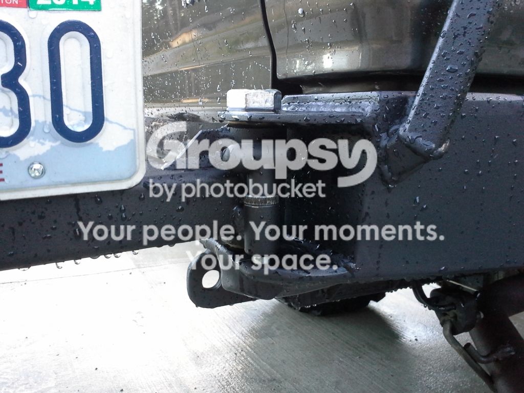

With a hinge design like this, Is there any concern for the bolt backing out or vibrating loose?
The nut on the bottom of the bolt has nylock on it. On final assembly I am going to use Loc-Tite on it. It shouldn't go anywhere.

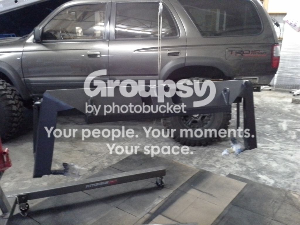

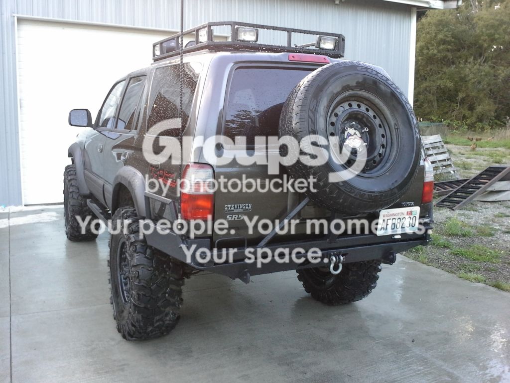

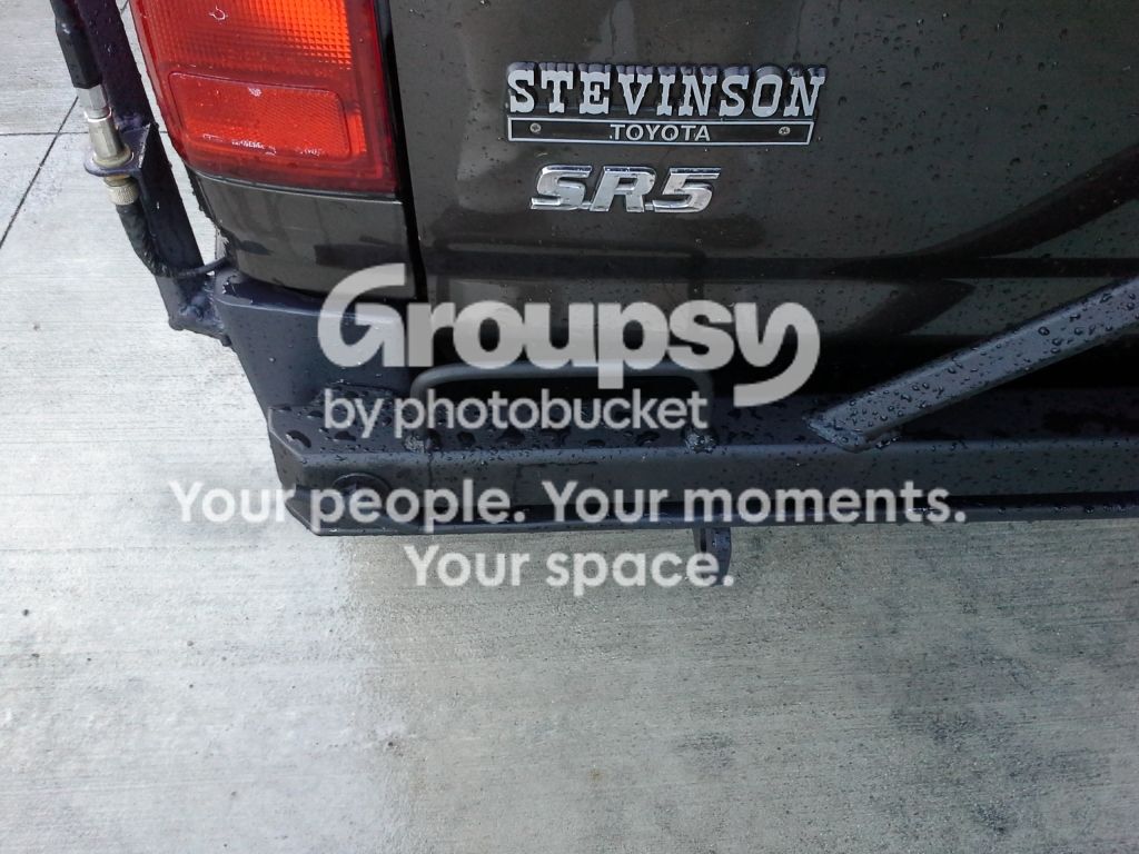

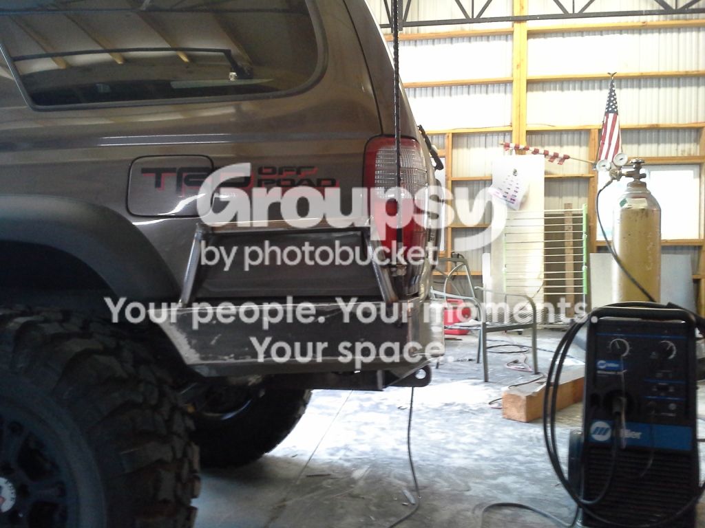

Almost finished with the rear bumper. I should be welding it on tomorrow, permanently.

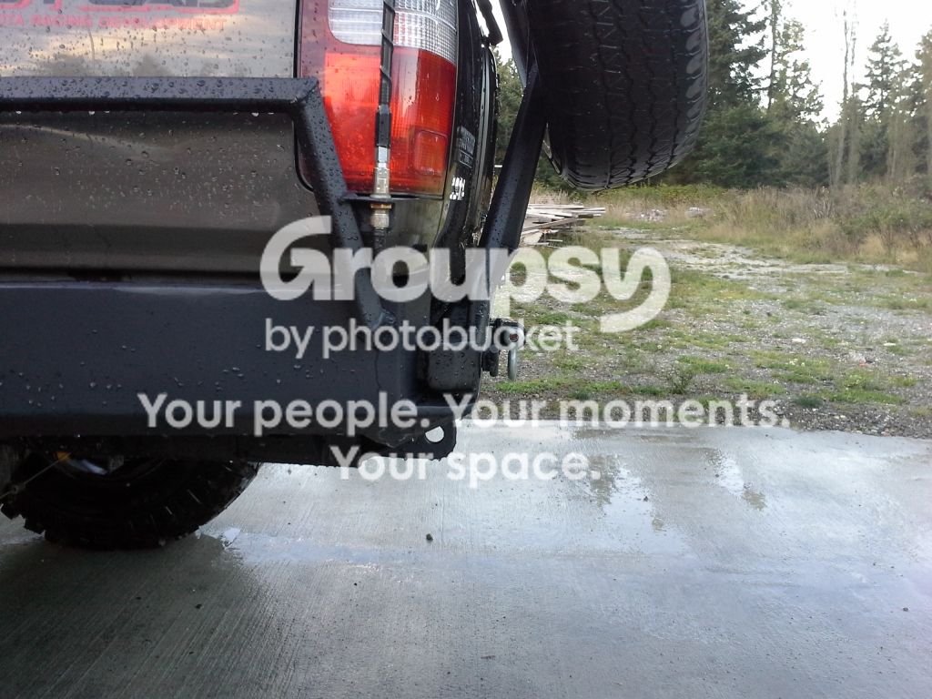

Well, it's closer to being done. I ran into a little bit of a delay. Should be done middle of next week. Here's the back story. When I received the double sheer hinge kit they forgot to put the DOM tubing in with it. So I used a piece of tubing I had laying around and emailed the company, explained the situation and got a partial refund. No big deal. I was skeptical of the tubing I was using but I figured I'd give it good test before I take it out of the shop and if it broke then I'd just a get a bigger sleeve. Well that's exactly what happened. The new sleeve should be here next week. I have everything prepped so it should go quickly.

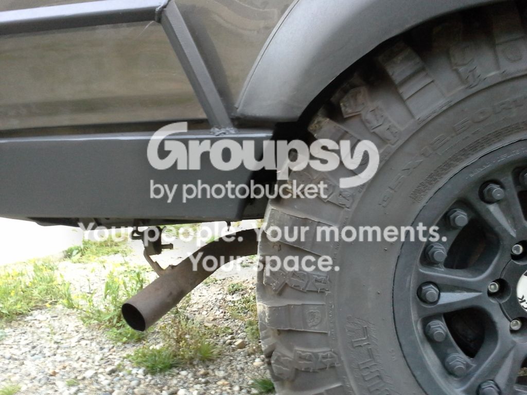

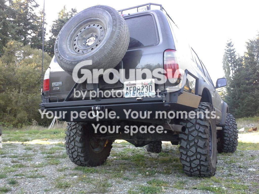

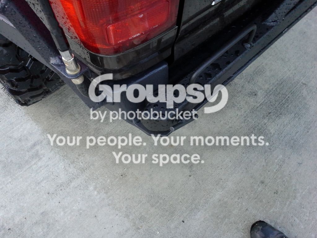

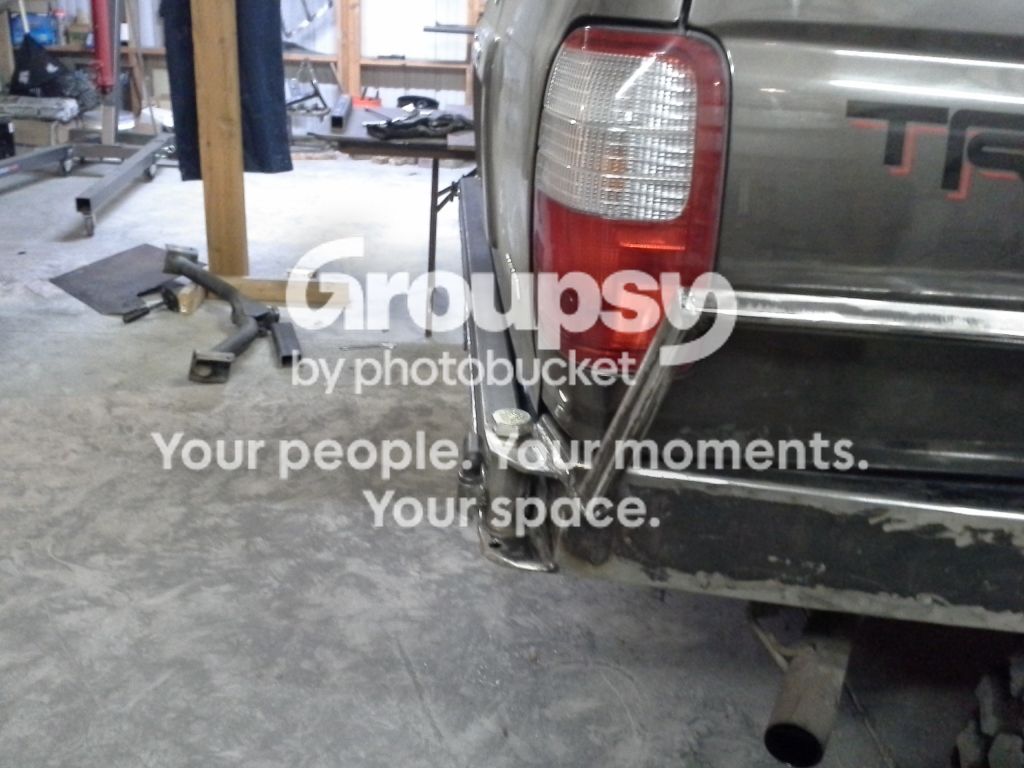

I'm happy to say that the rub rails came out pretty nice. They seem to be nice and sturdy.

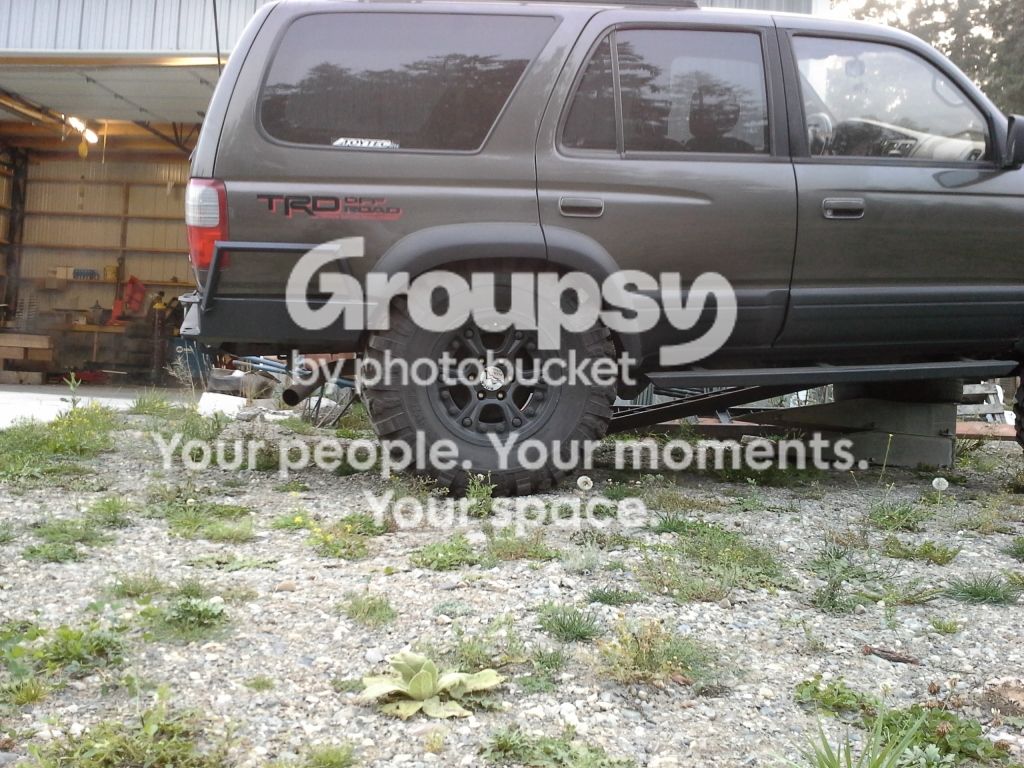

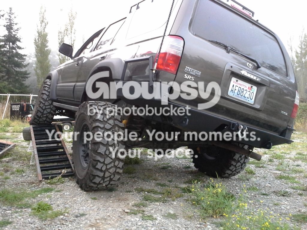

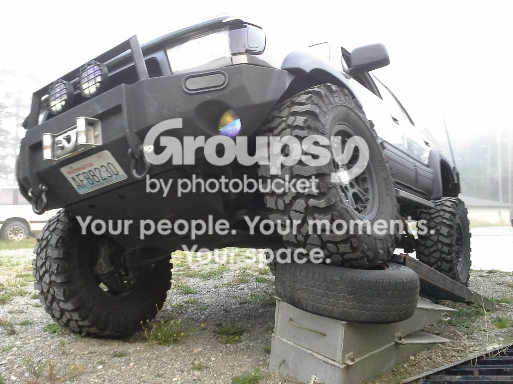

I've heard people talk about rear bumper contacting the body when flexed out. I really didn't want that. I'll test it again when it's complete but here are some pictures. I don't have any rubber issues anywhere.
Great work on the rear bumper, Kurtis! It's got some clean lines, great clearance and you made it yourself. Can't beat that. On my own rig, I would have liked round tube for the rocker guards, but the square tube goes w/the rest of your rig so it works.

Thanks for the complements. I wasn't a big fan of the large rear tire carrier bumpers. I just thought there were too big. I really tried to keep it as tucked up as I could.
A lot of folks aren't a huge fan of all the square tube. I saw [MENTION=47856]jsmarine[/MENTION]'s black 3rd Gen a few years ago and I really liked the square tube on edge so I tried to keep the theme going. As far as the tires and wheels go; I'm just waiting for the snow to fly!

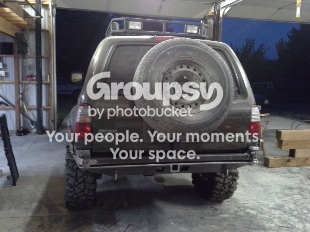

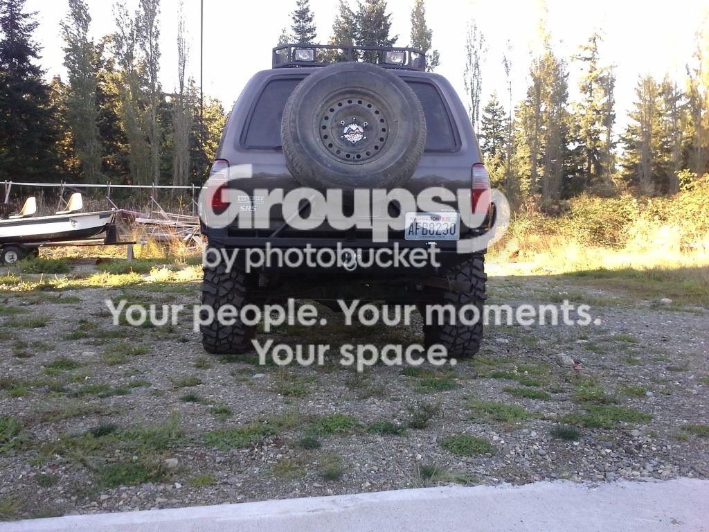

And...done...
I'll get a better spare someday.

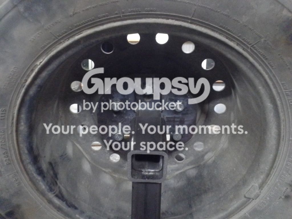

I ended up using 2 bolts to hold the telescoping tire mount. It was rocking back and forth and I didn't like that.

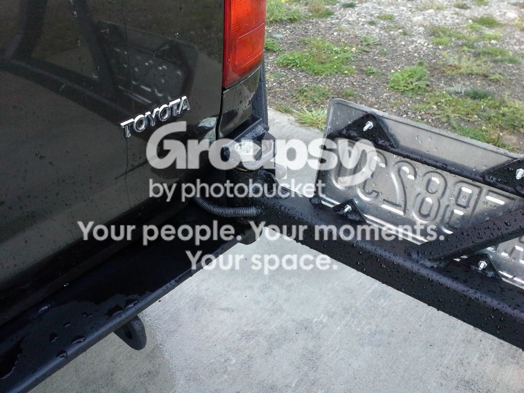

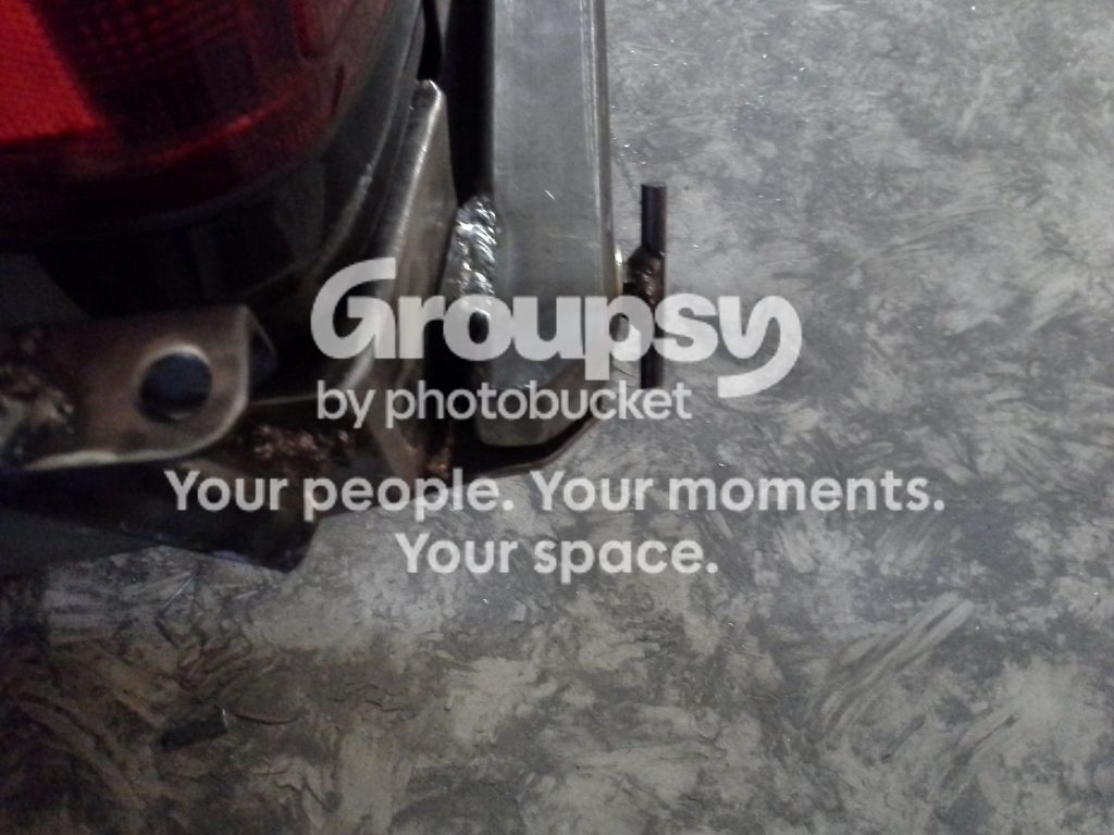

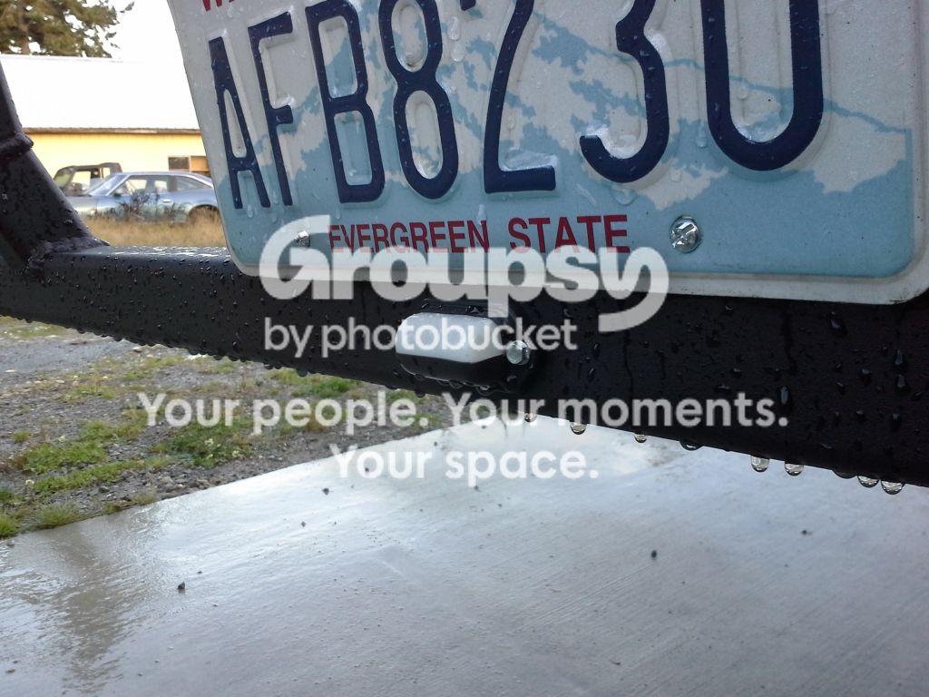

Picked up a $7.99 chrome light, painted it, and RTV'd the shit out of it.
Ran the wires from the tail light through the main support to the license plate light. More RTV here.
