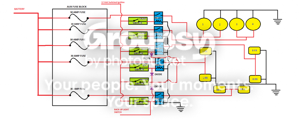

I've been getting lots of PMs about the wiring on the roof rack lights and how I did it. I over complicated the lights a little and used some extra things like diodes to have a few of the creature comforts on my switches. Here's the basic diagram of how my system should be set up. I still need to make some corrections to my circuits to make them more current with the changes I have made in the last 8 months (Different bulb wattage, etc.). I'm not an artist in paint so if you don't like it, you can eat my ass.
I recommend that you get familiar with electricity before you start a wiring project like this. Learn what watts, volts, ohms, and amps are and how the relate to each other. Learn what AC and DC is and what the difference. (No, not the band) There is a bunch of websites out there that will give you a basic understanding of electricity. I also recommend getting familiar with soldering. It's not difficult and relatively cheap. You will get a better connection with soldering than using butt connectors and they won't fall apart. Don't forget heat shrink tubing at the connection too.
Lets set some base rules for the diagram first.
  • Everything that is colored red is 12V DC.
  • Everything color black (except the boxes) is ground.
  • The upside down pyramid looks doohickies with 4 lines are ground points.
  • Intersecting lines that have a curve/hump in them are not connected.
I left out the dash lighting portion on purpose. I would deal with it separately. Just get a good understanding of what the difference between dependent and independently wired LEDs. This website will help. OTRATTW If you go back a few pages on my build thread you will see a terminal board in the mess of wiring. I have also left out the terminal board as it is not required for the install. I just made it more organized for me.
There are 5 circuits here for 5 sets of lights. Only follow one to familiarize your self with it. They all operate on the same principles. For the switched ignition you can use an "add-a-circuit" or "add-a-fuse" and tap off the fuse block under the dash.
1408-2028-51119.jpg~original
Right now I have 30 amp fuses in there but it's a little much. I will be probably be taking them down to 20 or even 15 amps. With a 2x 55watt bulbs on 1 circuit it's still only 9.1amps with a normal load. (110watts/12volts=amps) The master switch is used to turn on all 3 sets of rear, left, and right facing lights at once. Diodes must be used here to avoid turning on all 3 if you only want 1 at a time. I also wired my back up lights to the my rear facing lights so when I put it in reverse the lights automatically turn on. You don't have to do the master switch and automatic reverse lights. It's a creature comfort thing.

Love the roof rack and light system, hope you don't mind if I mimic your setup! I understand your diagram but the only missing part was what kind of diode did you use. I would like to use a Master switch as well to turn on the whole roof when needed. Thanks!
Kurtis,
Thanks for the compliment. I don't remember what kind of diode I used. I just picked a couple up from Radio Crap. Excuse me, I mean Radio Shack. You don't need anything crazy. A lot of the stuff there is for 12V. Someone there normally has an idea about electronics.

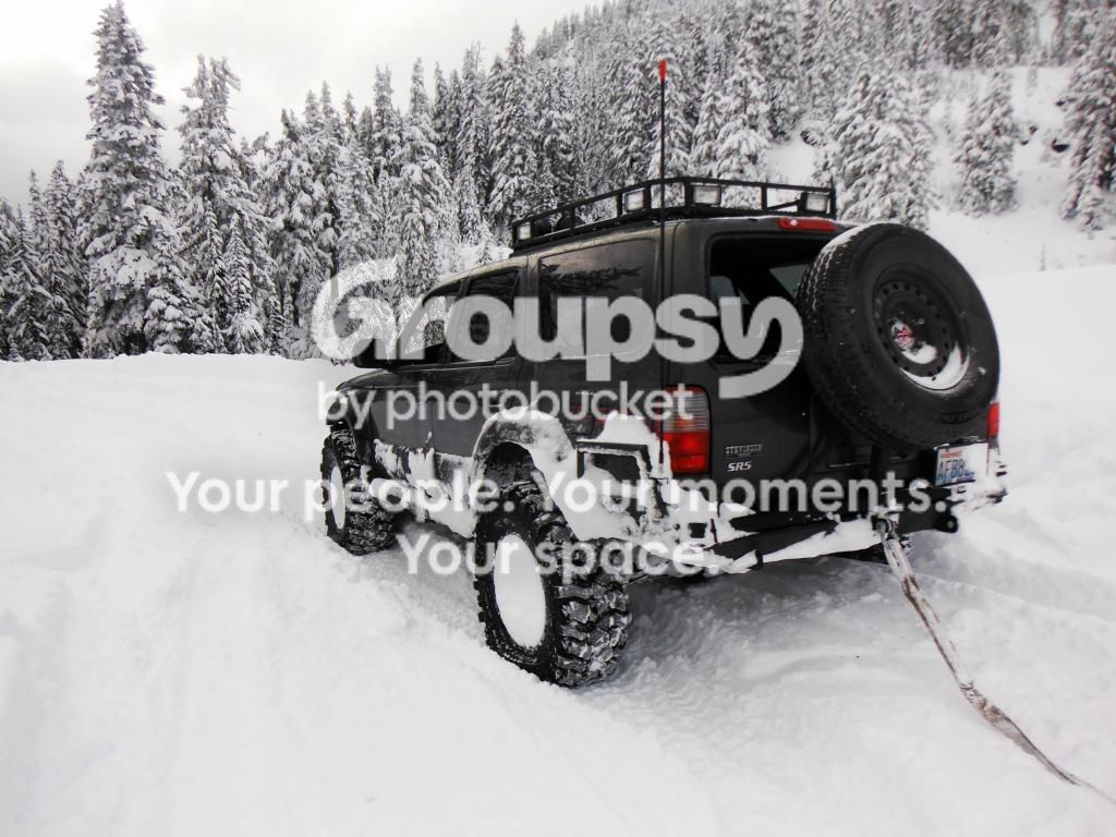

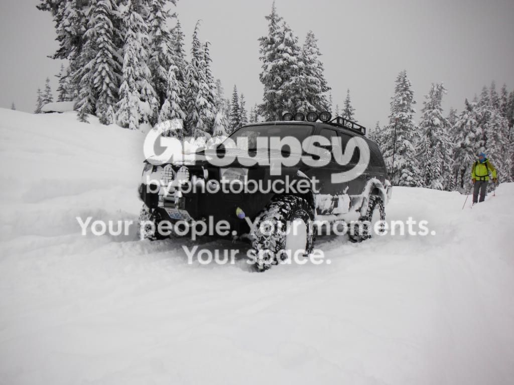

A storm came in last night. We had a last minute snow run. Went up to Twin Lakes. I was supposed to meet some guys from a local forum but they ended up being late and we didn't know about it so the wife and I bailed and went up the mountain with out them. For the first few miles we had great traction with some sticky snow. Toward the top it all turned to sugar and became a pain in the ass. No one had been to the top since the storm except sleds. So many miles of me first awesomeness. It was a great day.

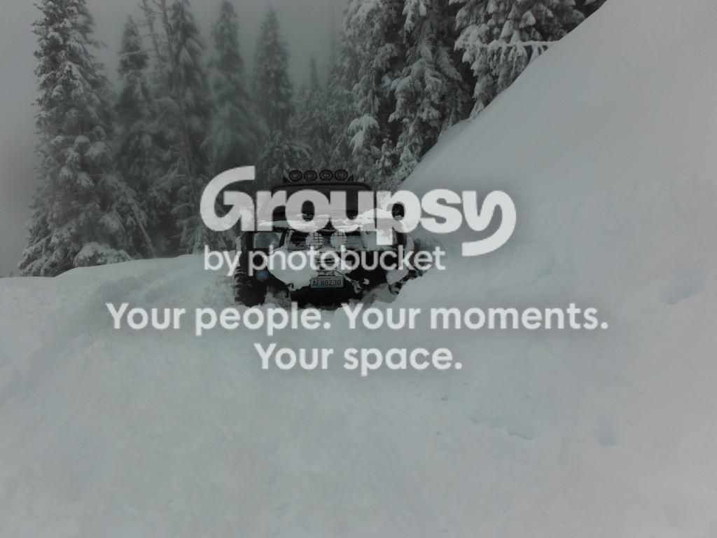

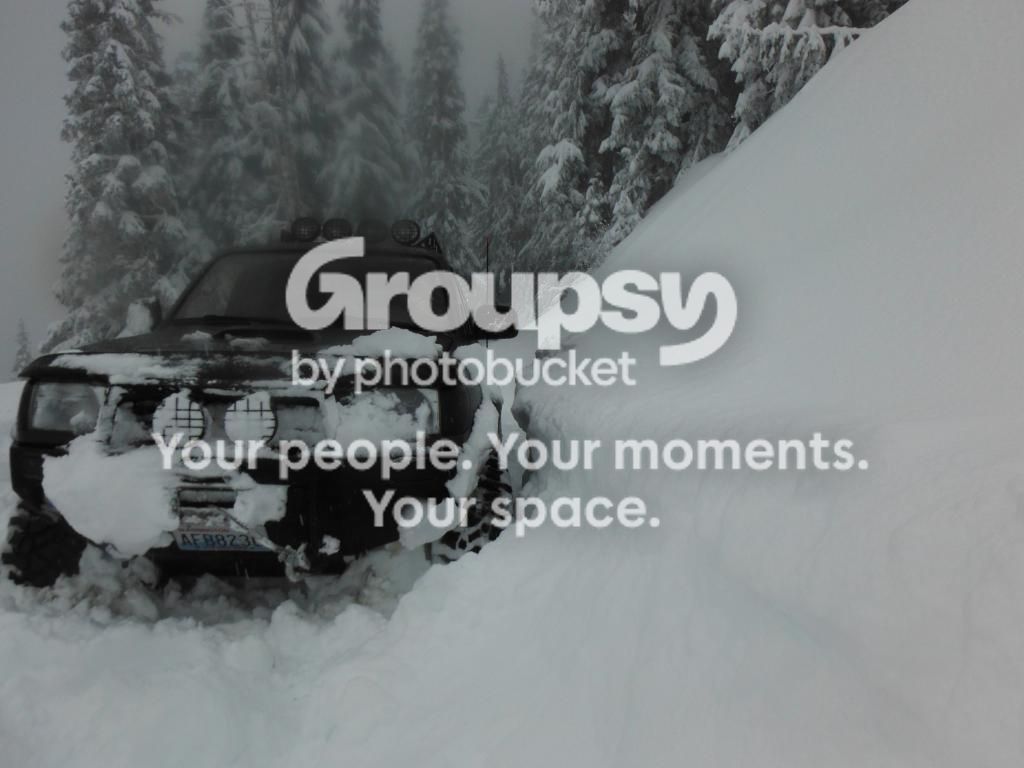

Stuck here trying to bash through a drift. Had to dig out. Nothing to anchor to. Was trying to make room for the snow machines since they were the only other people up there.

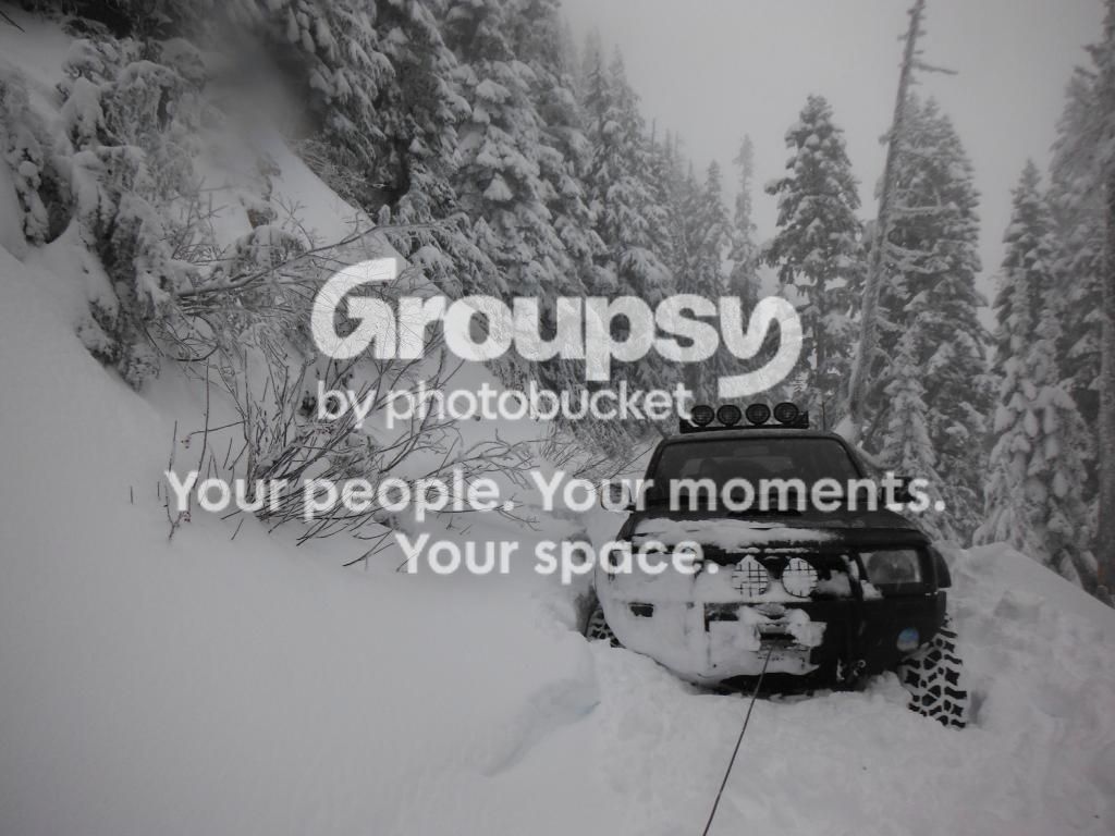

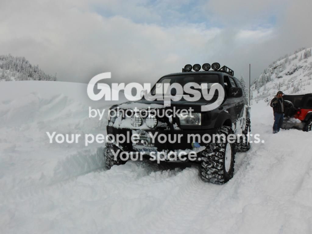

Bashing again on a really small part of the road. Only foot traffic and sleds made it through before I got there. Had to winch to make it the rest of the way through.

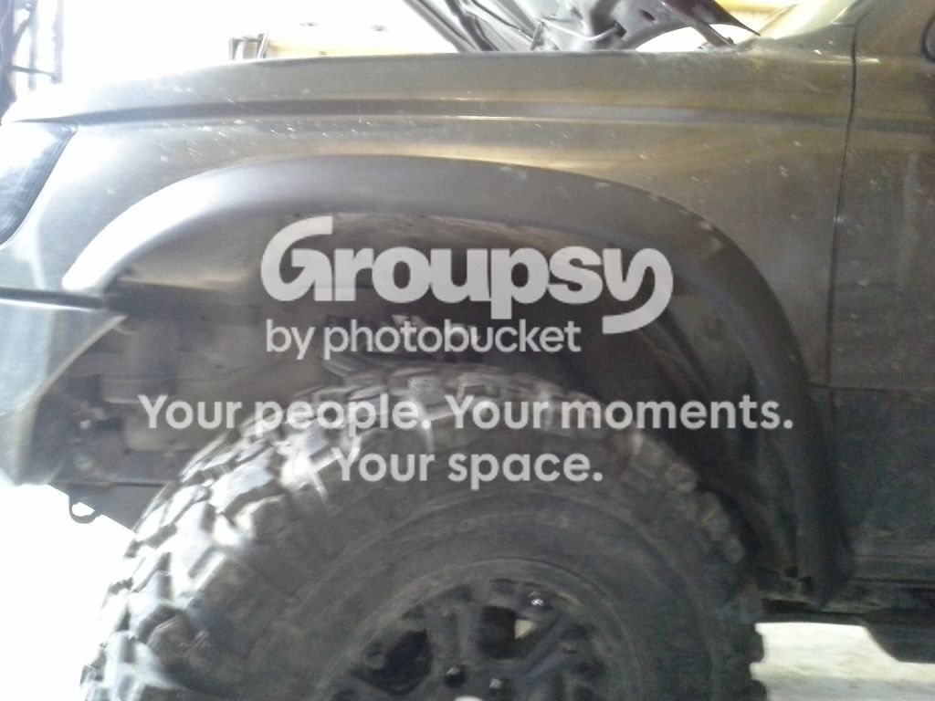

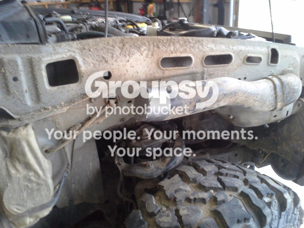

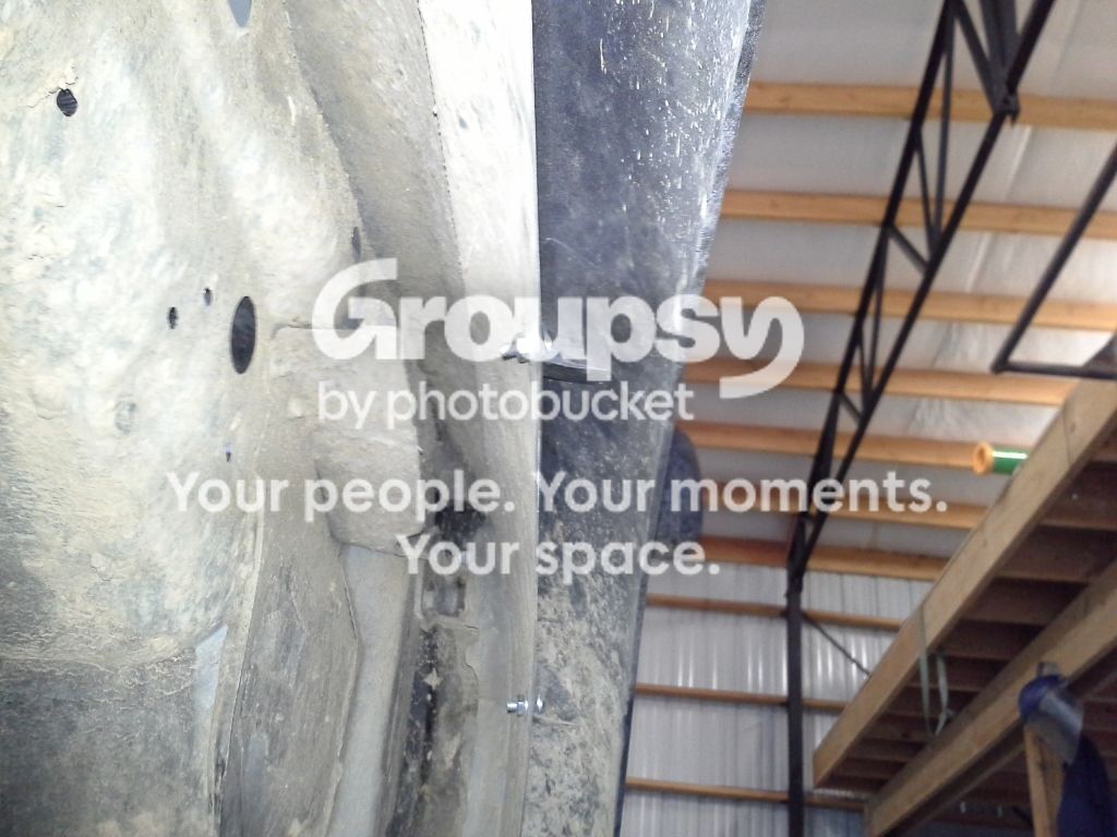

As you have read, I've been having clearance problems in the front. I rub on the firewall and the frame even with a partial tub on the firewall. Neither of those really bother me. If I was going to keep IFS I'd probably just do a full tub on the front. I don't know how Jon runs without a body lift. What I didn't like was every time I jumped the truck, or hit the bump stops the tires would mash the fenders. It started to bend the fenders. So I started cutting more fender parts off.
Looks like it's going to clear. I don't have anything around the house to get the IFS maxed out so I'll have to figure it out for sure next time I go wheeling. Pretty close to the bumps though.

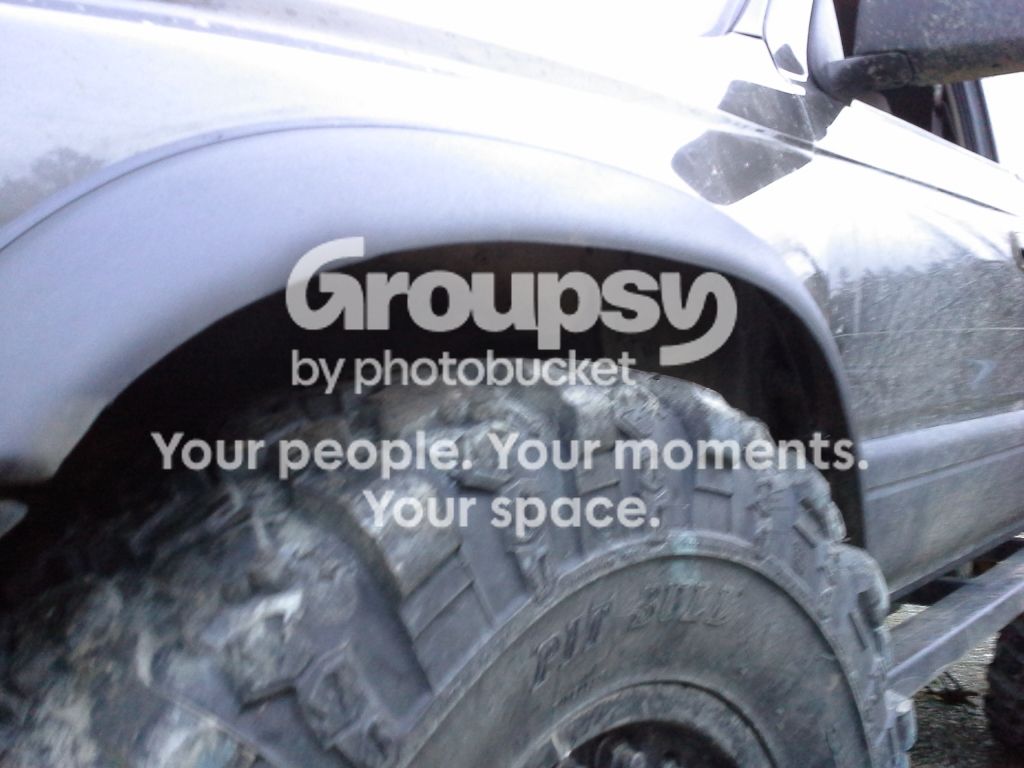

I also used 1/4" nuts and bolts to keep the flares on. Seems pretty rigid.
