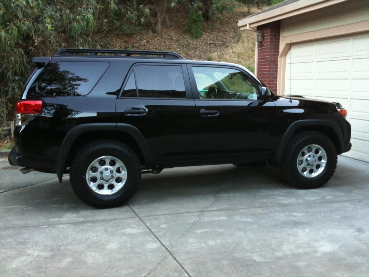

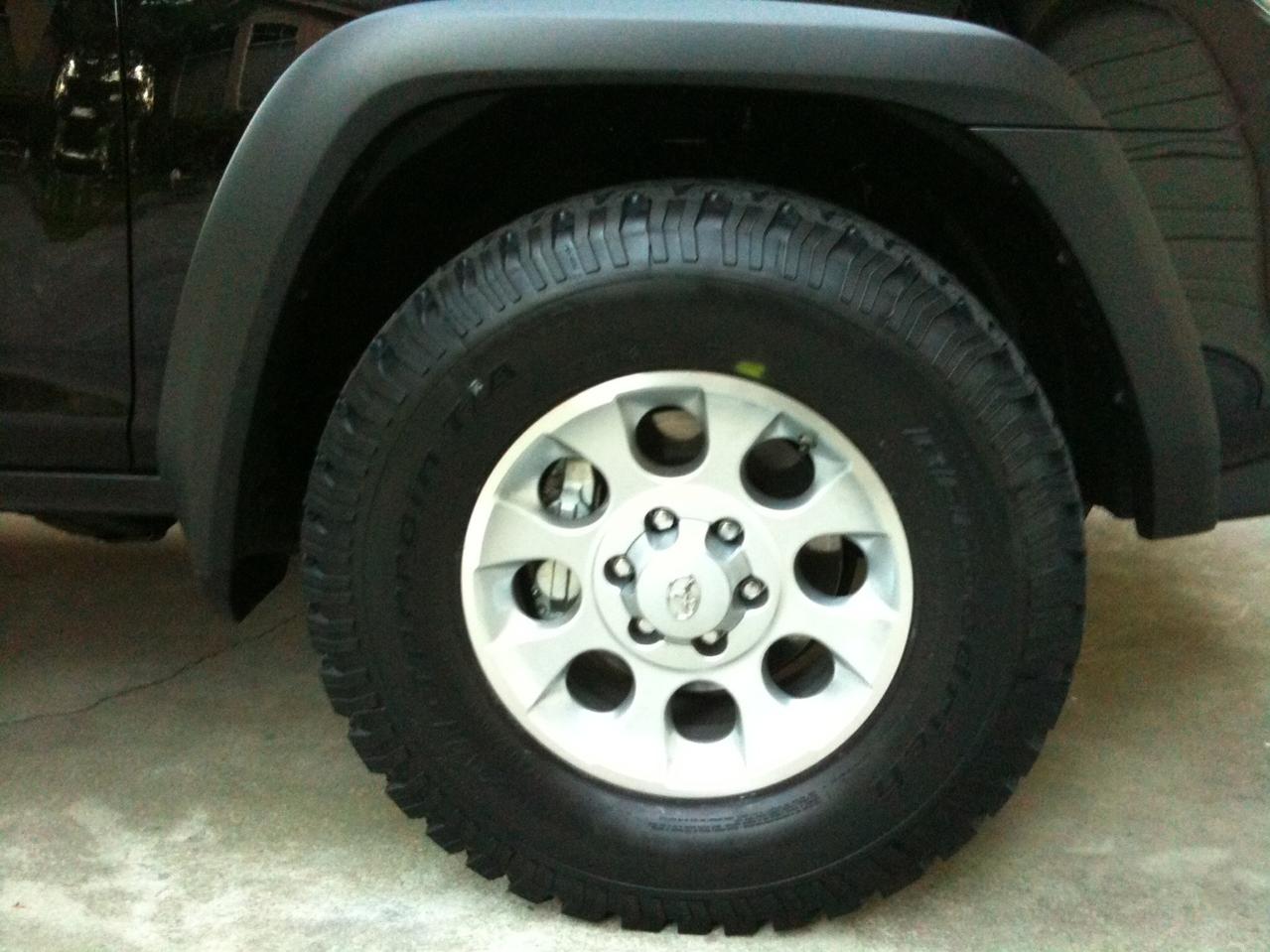

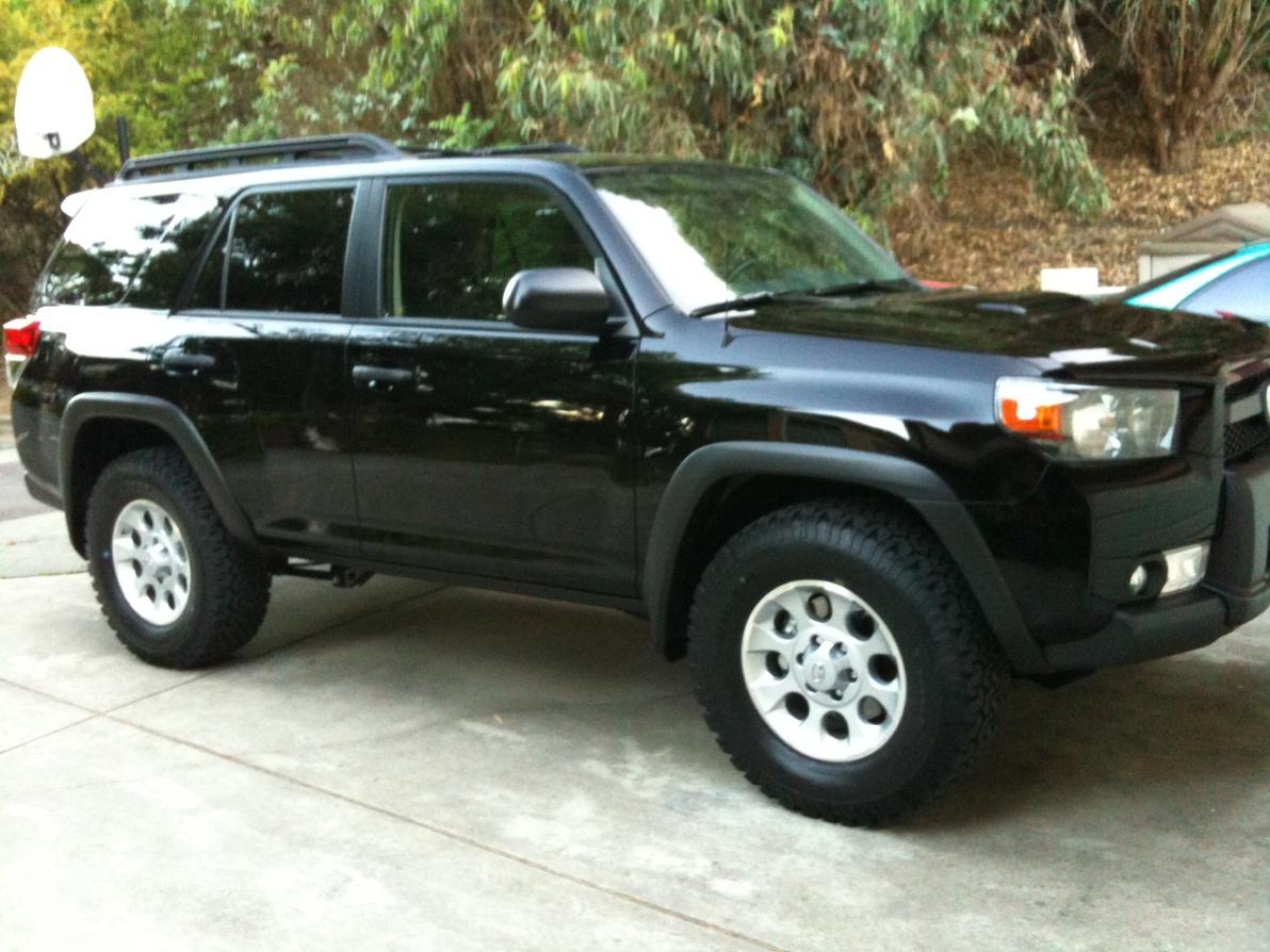

Sorry for the bad quality but as requested.
Let me know if you guys want to see something more specific. :)
Edit:
I love them. Road noise if very minimal and it is still a very comfortable ride. Very pleased with the upgrade.
