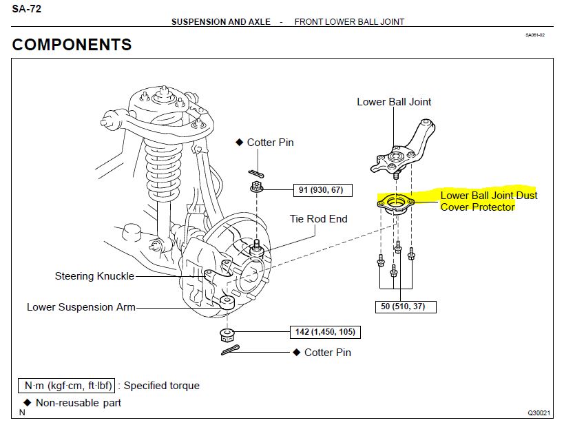

And you can also see them in the 2002 4Runner Factory Service Manual, along with the lower torque spec (37) associated with the longer bolts.
Cheers, Scott

are the dust covers just cosmetic, was gonna order kit and the older bolts ( higher torque so stroger ?)...which I guess dont fit or are a bit short with the dust covers. if just cosmetic, wont go back on.

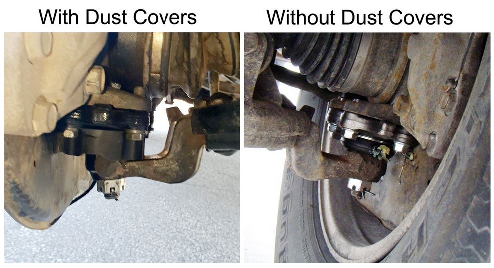

are the dust covers just cosmetic?
I've never had one in my hands, but I would guess these were introduced to try to prevent road debris from building up around the boots of the lower ball joints. I wouldn't say it is "cosmetic". It certainly looks like they could shield the boots from flying debris. From the front of the car, with the dust covers installed, you can't even see the boots. It seems reasonable this would result in less rocks and junk pelting your boots.
Personally, I left them off because I just liked the idea of the higher torque bolts (which I understood to be too short to accommodate the dust covers). It could be that the dust covers themselves can't tolerate the higher torque, so that may be why there is a lower torque spec to begin with.

thanks, seeing this picture and crawiling underneath, I no longer have dust covers, someone took them off previous
Same here. My son's 2001 doesn't have them. We haven't owned the car that long so we don't know the full history. They may have been removed previously, or it never had them to begin with.
