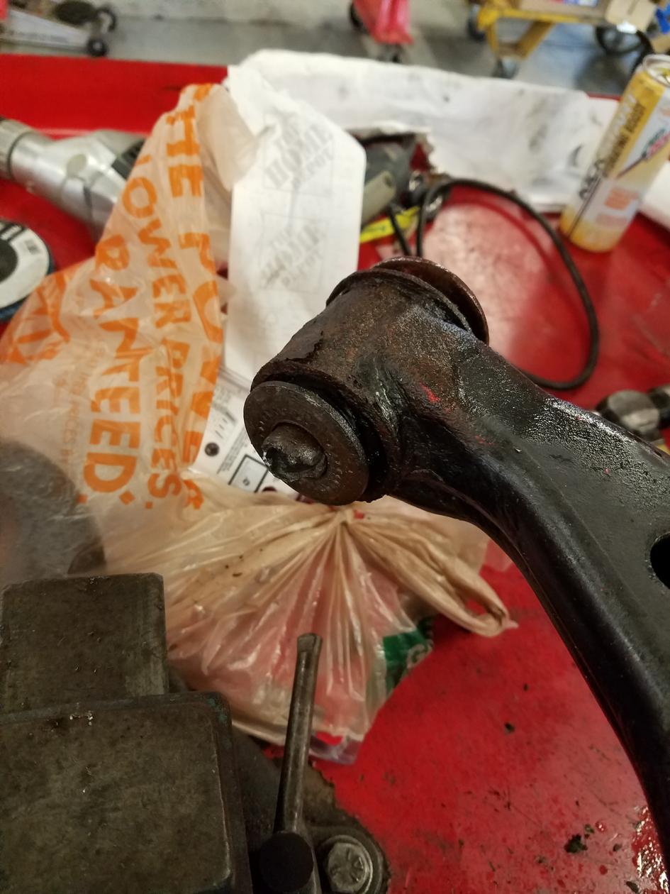

So I installed new lower control arms which wasn't bad as the work was done in under three hours. The only hiccup was that one of the bolts was seized badly.....nothing a little sawzall action cant fix!

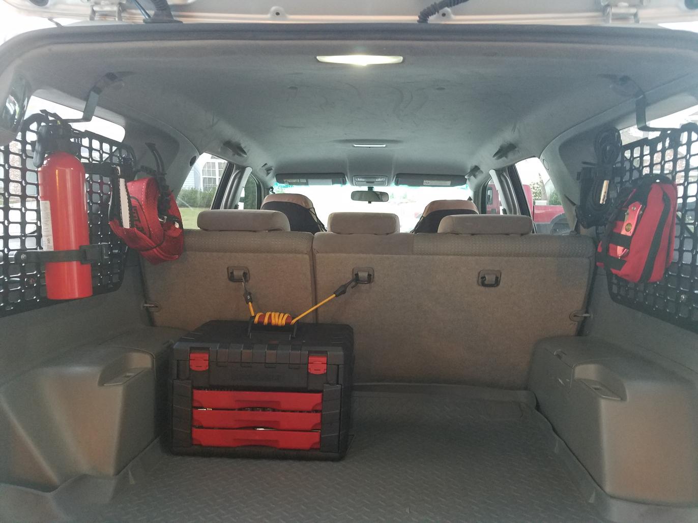

I decided to paint the racks black.....now I need to find a better way to secure the tool box.....

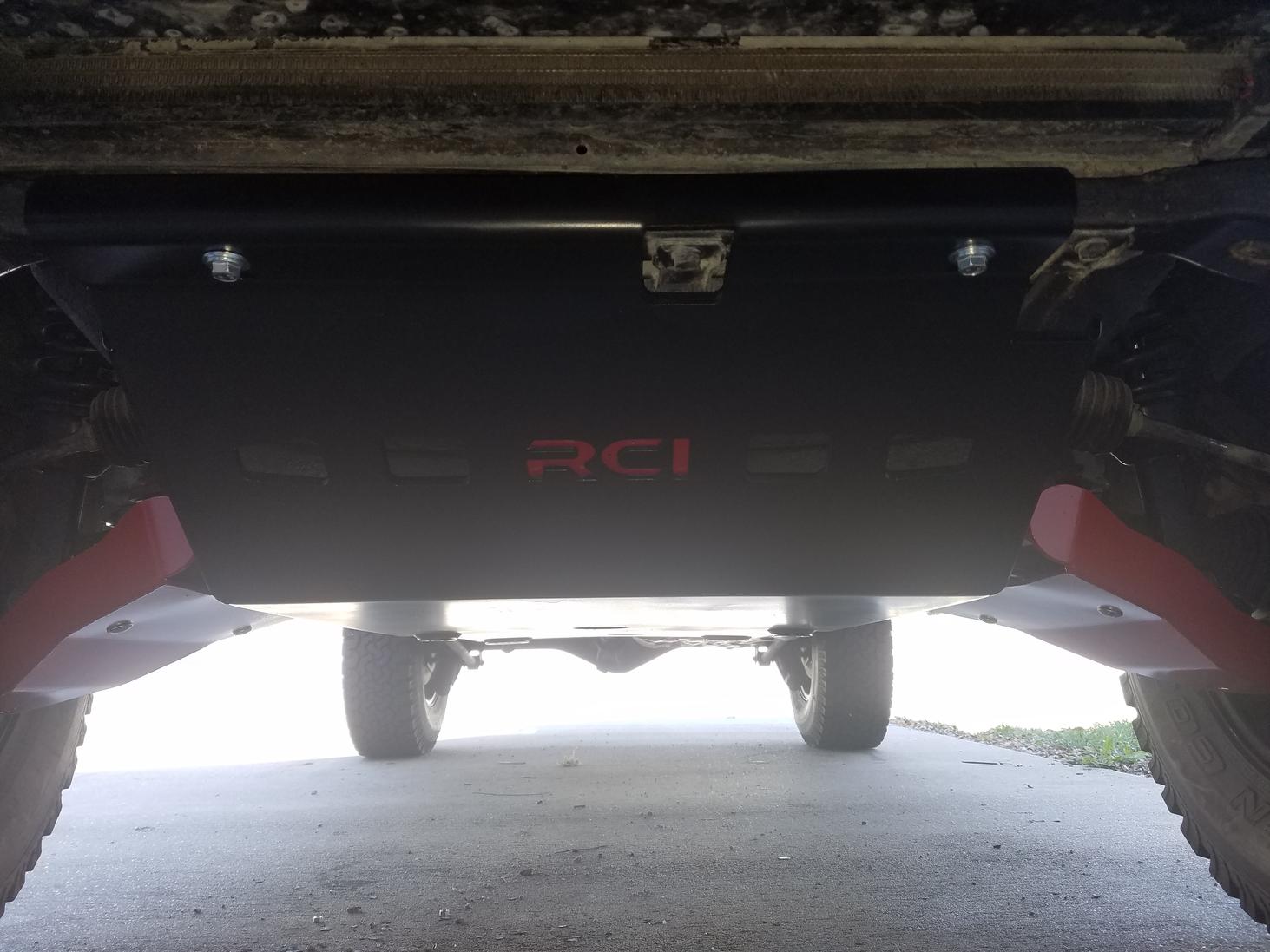

I got the skids on today and I found a little place to lift the front end up. I didn't want to flex out the rear too much since the ICONs are still being rebuilt.
