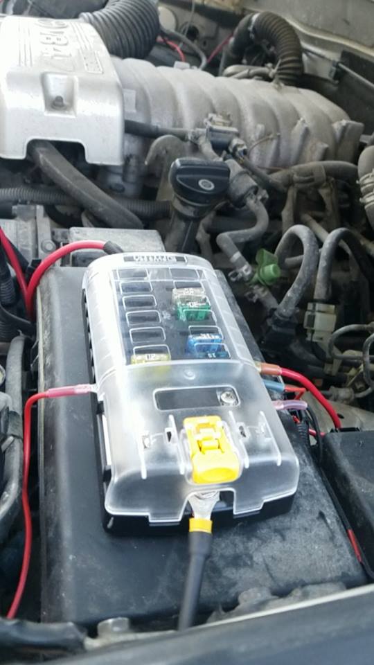

Great looking rig! Where did you get that fuse/terminal block?
