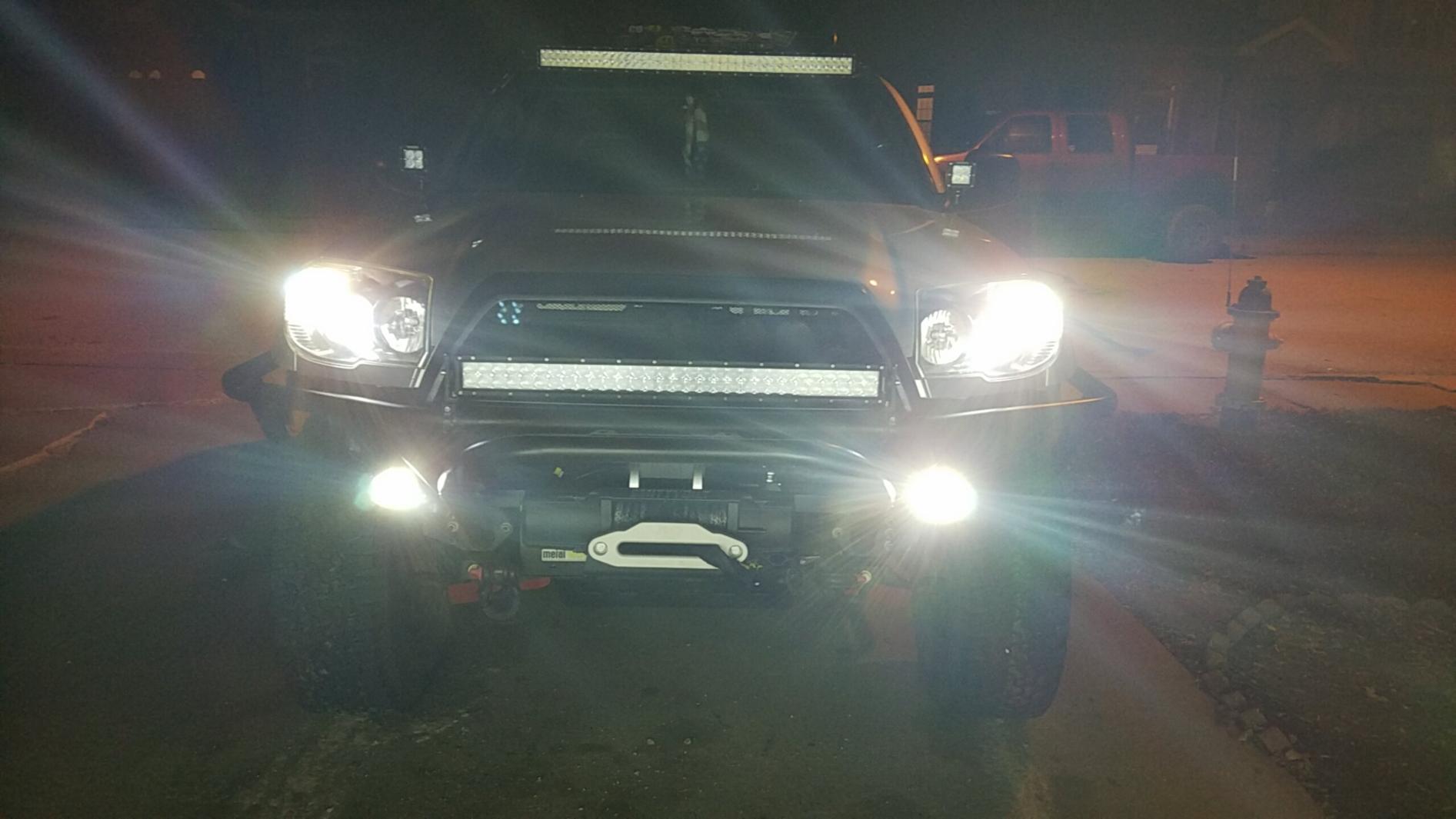

SwitchBack
Got the switchback DRL/turn signal installed.....man these things are bright. The quality and output are great......I can't comment on their reliability yet.

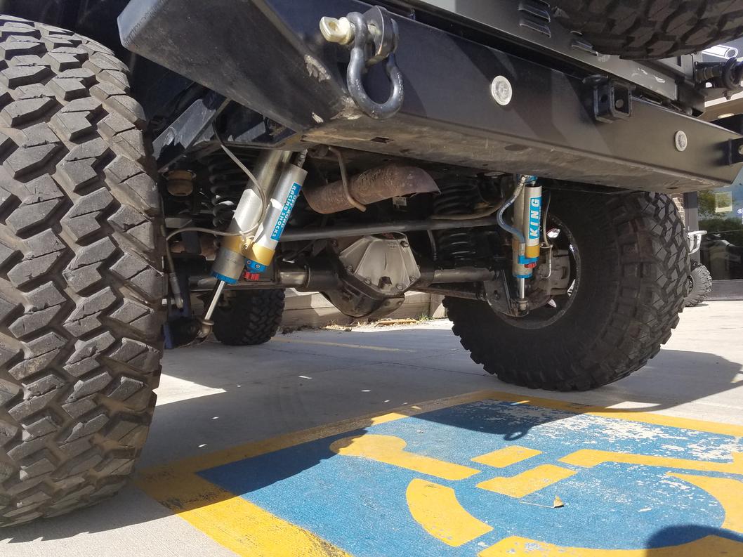

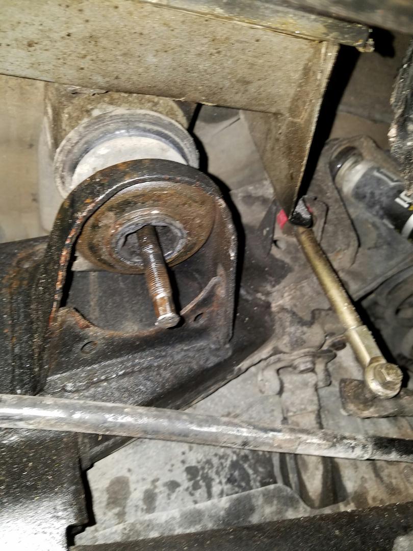

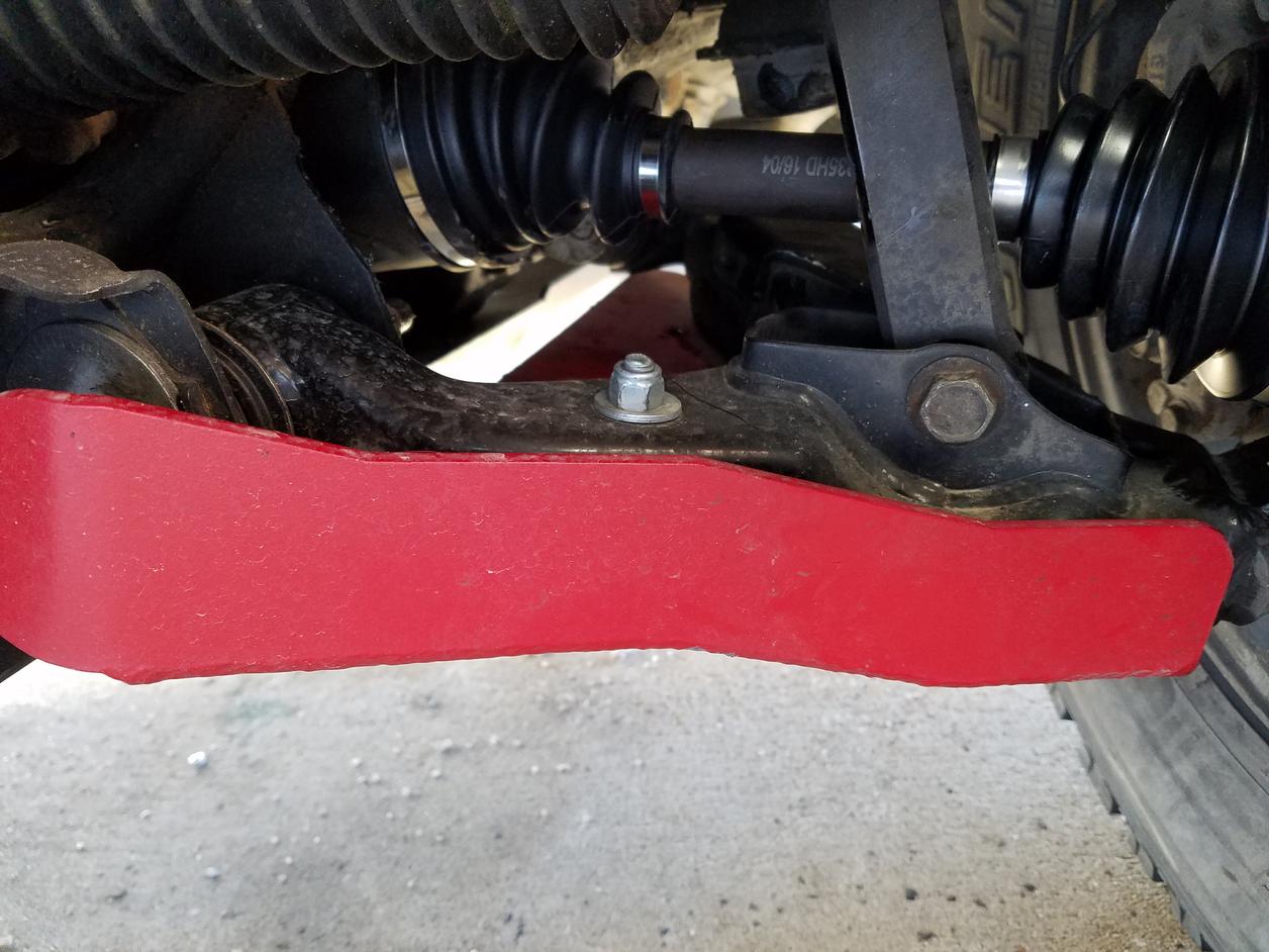

Got my CV axle replaced......also saw an alright Jeep....
What in the fawk is going on with the pinion angle on that JK? It makes my brain hurt. My only guess is that it is some aftermarket axle that has moved the rear diff cover upward from the normal location opposite the pinion? :suspicious::twitch:

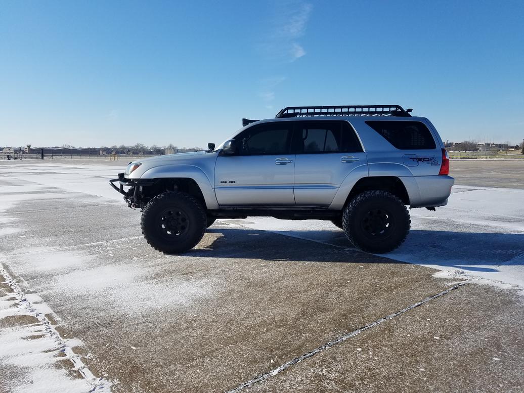

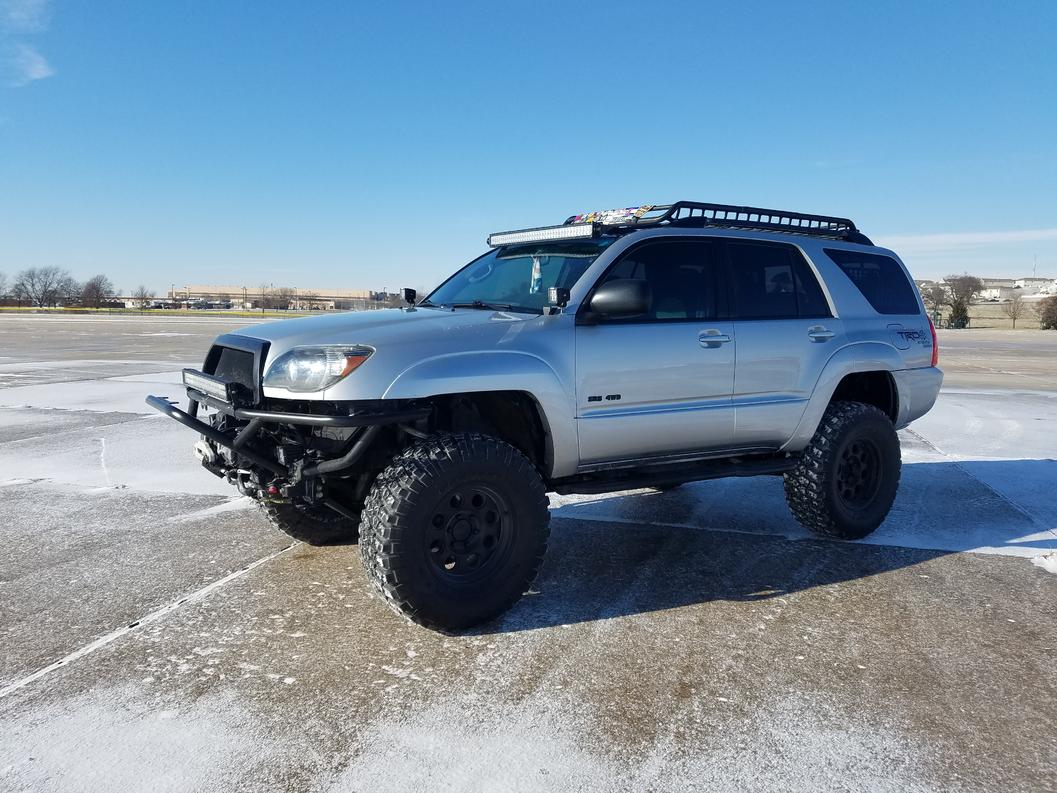

Body Lift

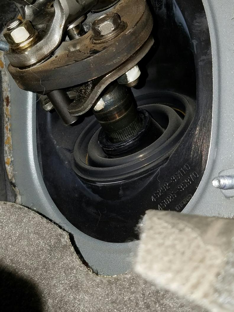

Put on the body lift.
Should have been straight forward......one of the bolts ended up being seized on and I couldn't get it out. I was able to put the rest of the on but Ill be taking it to the shop and have them figure out how the hell to get it out.
Ill also have the put the steering extension on because it's 0 degrees outside and the hobby shop ended up closing before I was able to install it.
Also forgot to mention that both front calipers were seized and I replaced those and all four rotors (rear was pretty bad).
Sent from my SM-G930P using Tapatalk
