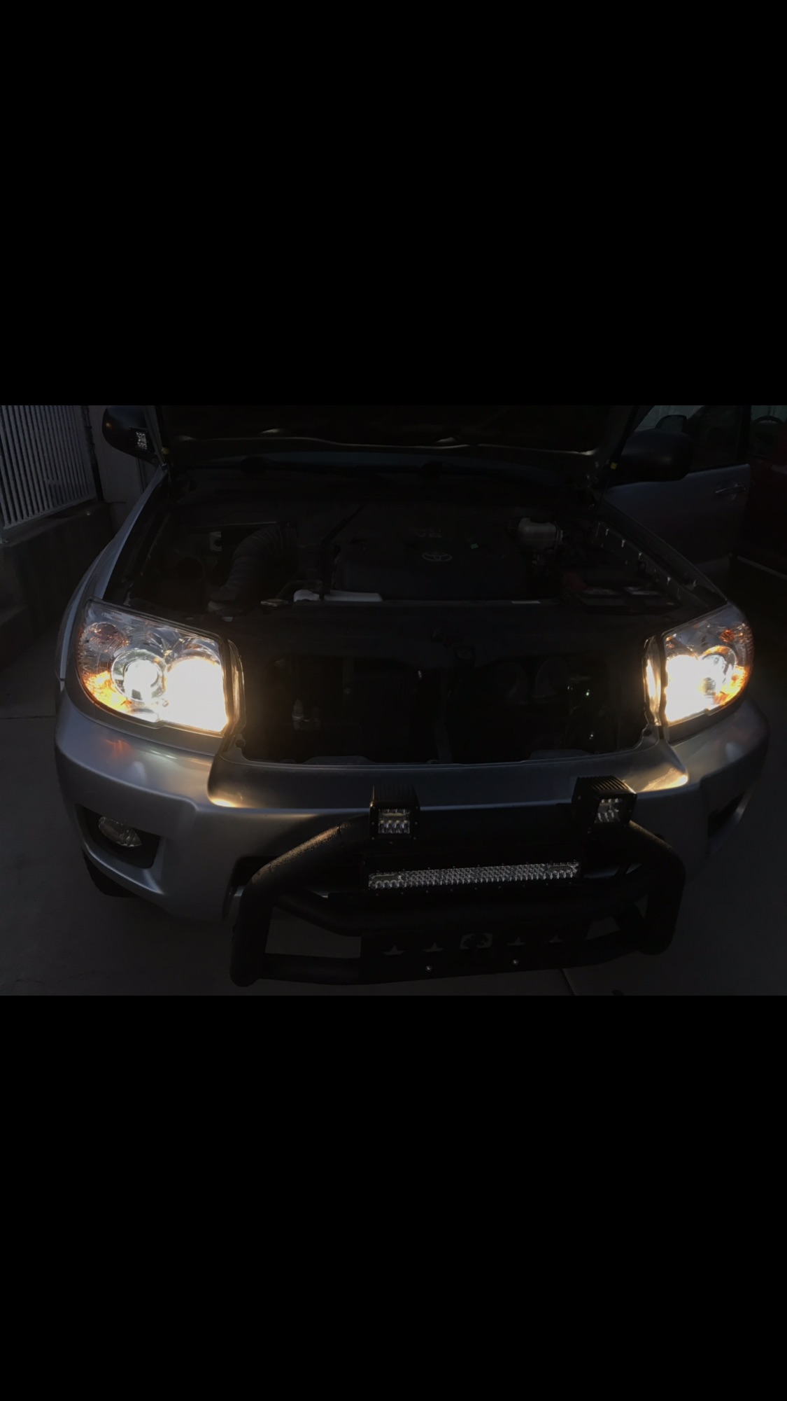

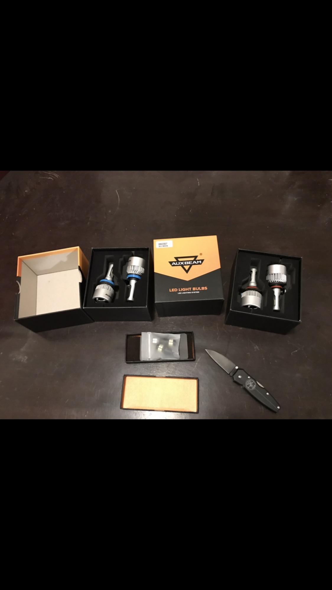

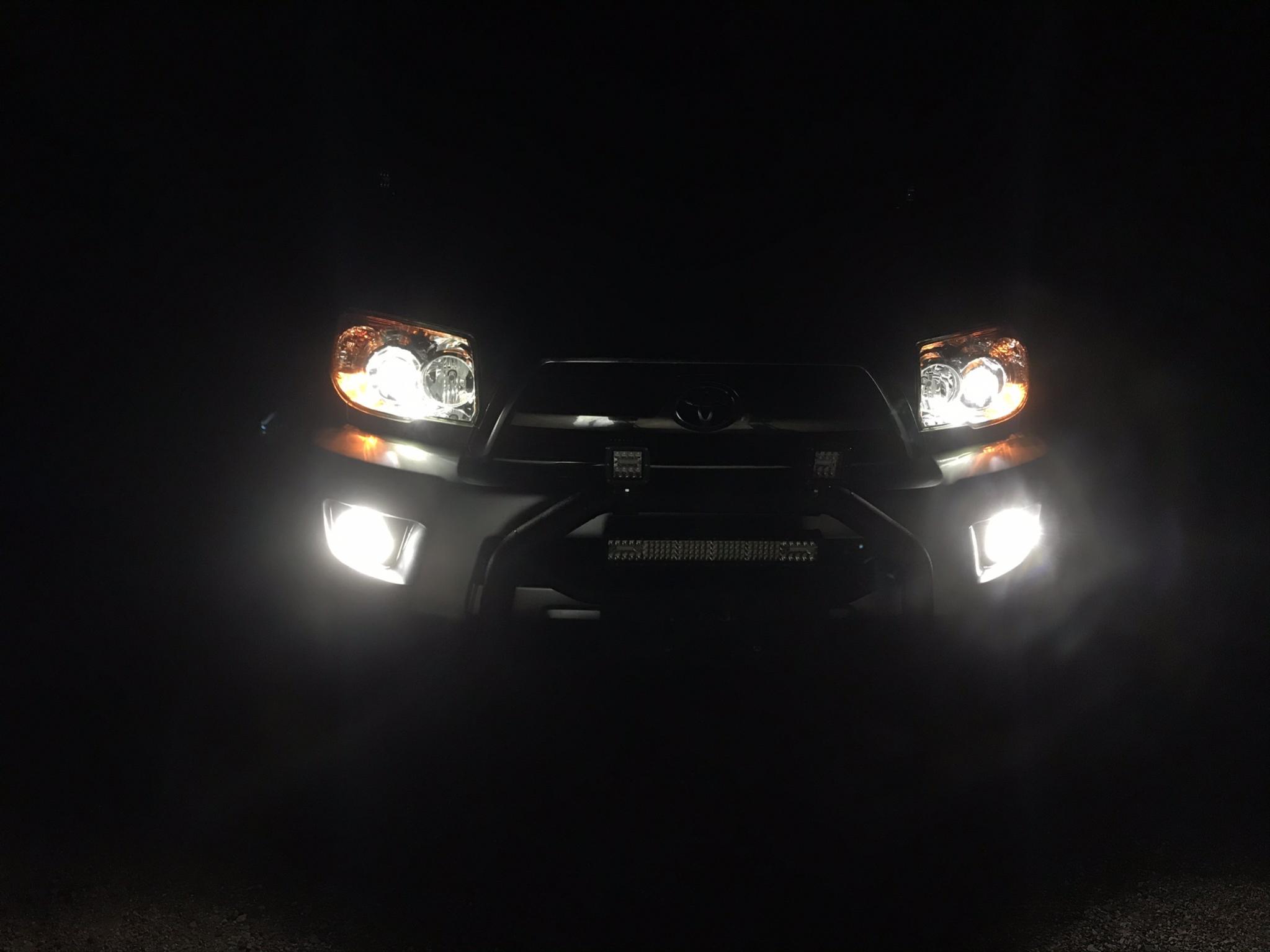

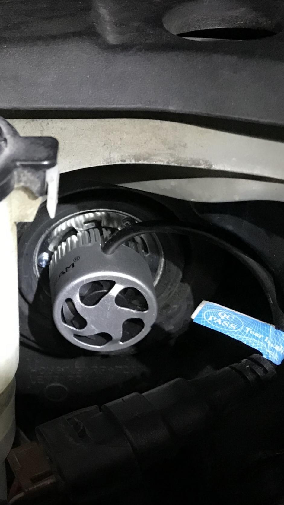

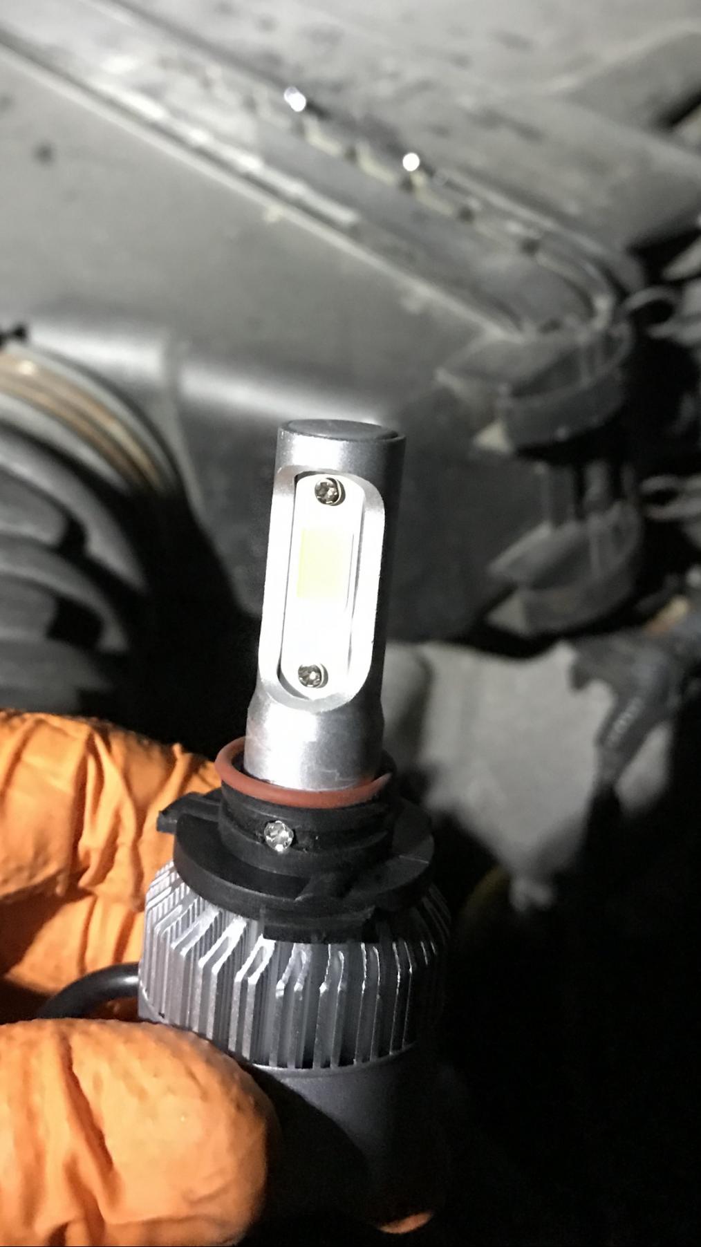

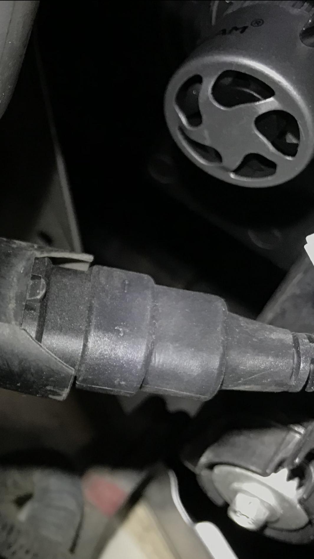

In case someone sees this thread and ordered these lights I want to warn about some issues I had.
The H-11 lows fit right in and plugged in just fine, since it doesn’t have an O-Ring setup per say. The orientation is the same as stock bulbs with the cord on bottom.
For the 9005 highs, the orientation is 180* off and the cord sits at the top once in. The key would not go in to the channel and I wound up stripping the plastic portion that is attached to the light. It turns out that the O-Rings are just too big in diameter and will not fit in. No matter how hard I pushed forward. That’s how I wound up twisting the plastic loose from the light, it literally spun from the set screw. I was able to take the plastic off and carefully screw the set screw back in. I had to actually use the O-Rings from my factory bulbs to get them to push in. To twist them in I had to be careful since the plastic portion had already wallowed out the hole and used a screw driver end to twist the key portion inside the channel instead of twisting the light. It will probably just strip out if I ever have to try and remove it.
On the 9006 Fogs, the orientation is correct with the cord at the base. The first fog light I tried already was loose and the dang screw had already been stripped out of the Aluminum body from the factory. I had to take it apart so I could epoxy the plastic key portion on and slip the set screw in. I went ahead and did it on the other one as well even though that didn’t come pre-stripped lol. On these I also had to use the factory O-Rings as the ones they came with were just too dang big also. On the one that had the set screw NOT pre-stripped, it came with the wrong plug end and was completely different than the others. I had to cut a lot of plastic off to get it to slide down enough, it doesn’t have clips that snap in, it just kind of pressure fitted and may come loose after time.
All in all I definitely had problems and were a challenge that I had to learn as I went that I would rather not have dealt with. Not happy half the time messing with them but I am pretty happy with the end result. I know they’re Chinese made and horrible QC but you get what you pay for lol. I am happy with the color, super nice white light. My stock dim lights seemed brighter, the highs were definitely brighter than the new LED’s. My highs had great distance, just pretty yellowish. It seems to be a good compromise and happy with the overall outcome now. Had them all in in for about a week now.
One tip for all that may save a few minutes is when you plug them in, make sure the + and - symbols are to the outside. Since they’re polarity sensitive they have to be plugged in the correct way. I know it’s 50/50 odds, but with my luck it was more like 10/90, I just couldn’t get it right at first haha. At least going in to the fog lights I knew which way to plug them in.

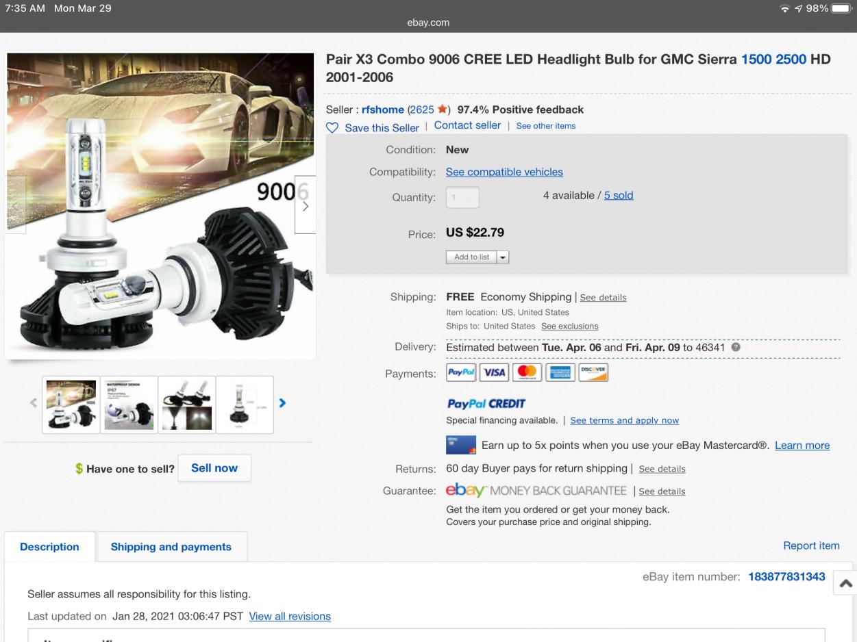

I swapped out my circa 1908 incandeacent bulbs for the $25 LEDs X3 on ebay. I put one set in the low beam and another in the fog lights. I left the halogen high beams in because I like the amber tint to show ground detail better and easier on the eyes especially when approaching road signs. LED flare back on signs can be blinding. So far no oncoming traffic has signaled me that my lights were blinding them
* I did try a set with fans and they caused radio interference
2Pcs X3 H11 ZES COB 50W Hi/Lo LED Headlight for Chevy Silverado 1500 2008 2009 | eBay
Pair X3 Combo 9006 CREE LED Headlight Bulb for GMC Sierra 1500 2500 HD 2001-2006 | eBay
