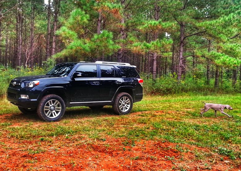

they're actually 20x7J which my shop here says they measured them at 7.5". Yes, they work fine. There are quite a few of us on the forum running 285/55/20's. My local shop here in Birmingham has installed 285's on several 4runners here (or so they say).

Nah, you can run 285's. 275/55 are good if you don't add a leveling kit. If you add a leveling kit I would go with 285/55 personally. There is someone on here with a 14' LE with 285/60 on the stock 20's. Looks amazing but I cant remember who's it is.
Here's a better picture of mine.
