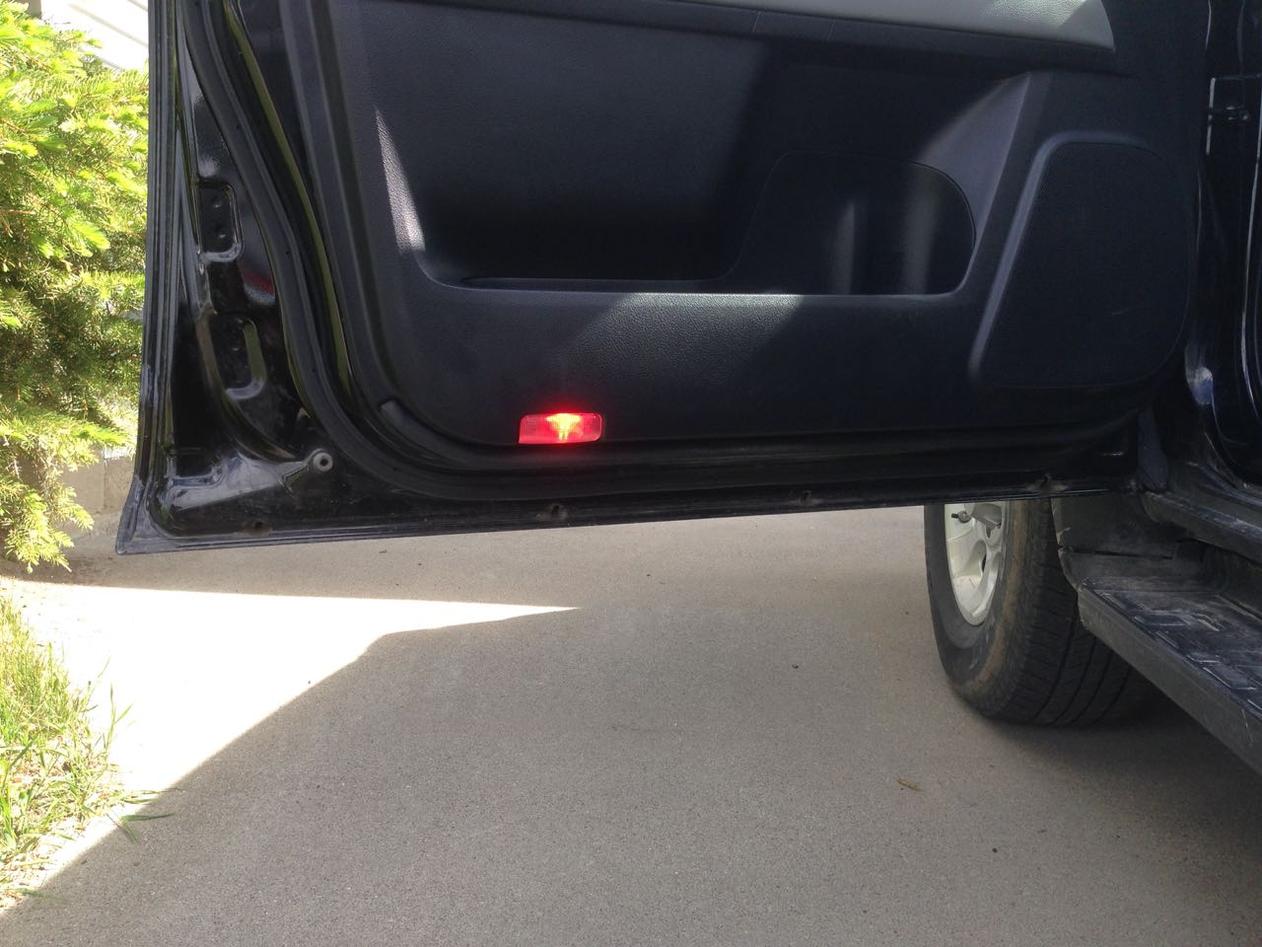

Anyone ever thought of putting Red lights in the lower door's? Just an idea, remember back in the day some town cars would come with red lights in the bottom for when you open them people would know it was an open door on the side of the road or something so I assume.
Like this? I used some side-firing LEDs since the bulb is mounted sideways in those lights. I've also since added red reflective tape to the insides of the door jambs for extra visibility at night with the door(s) open.

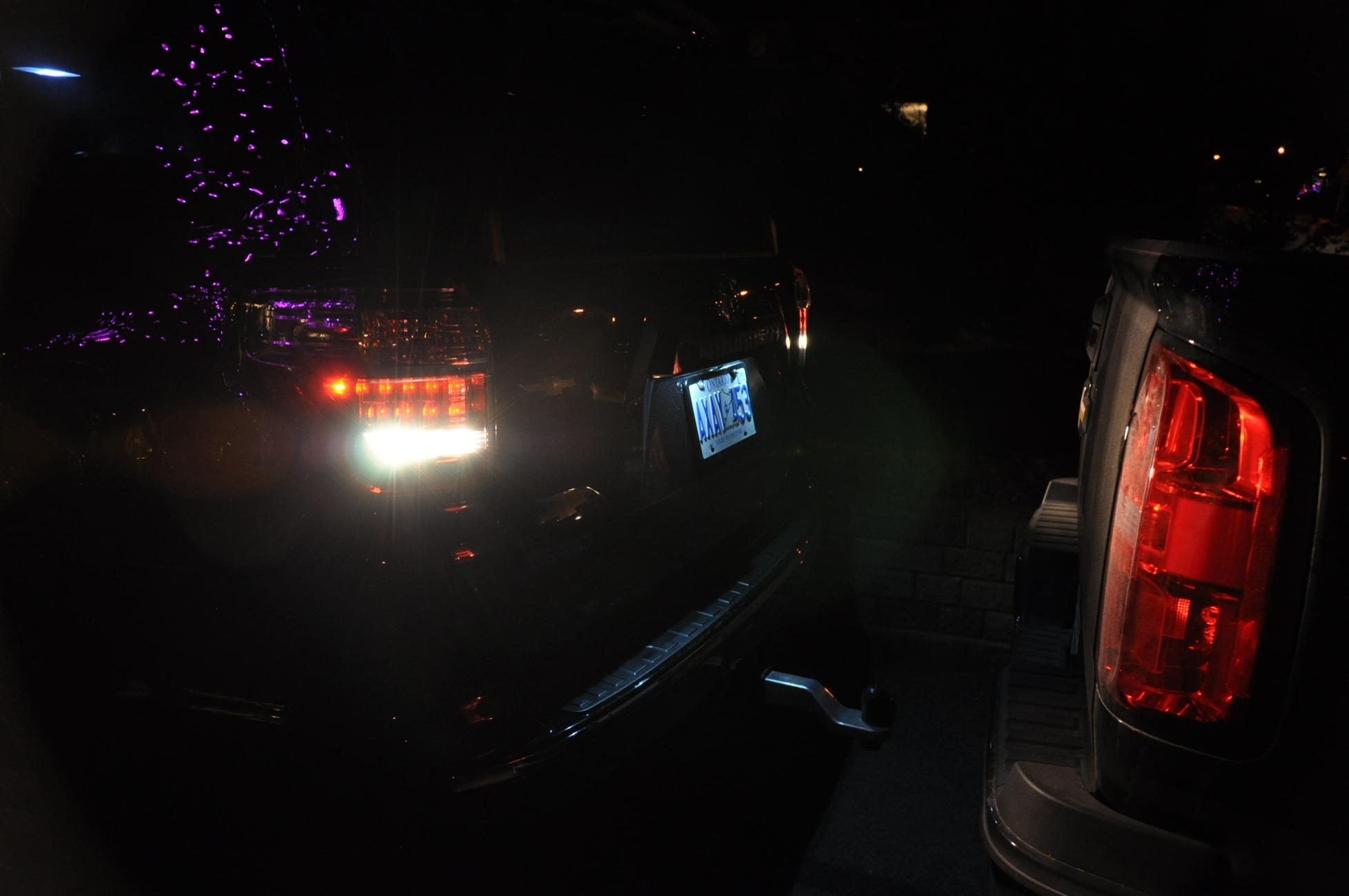

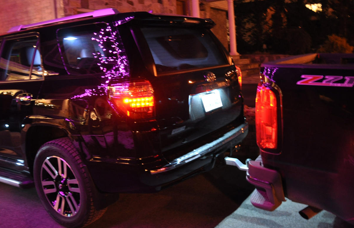

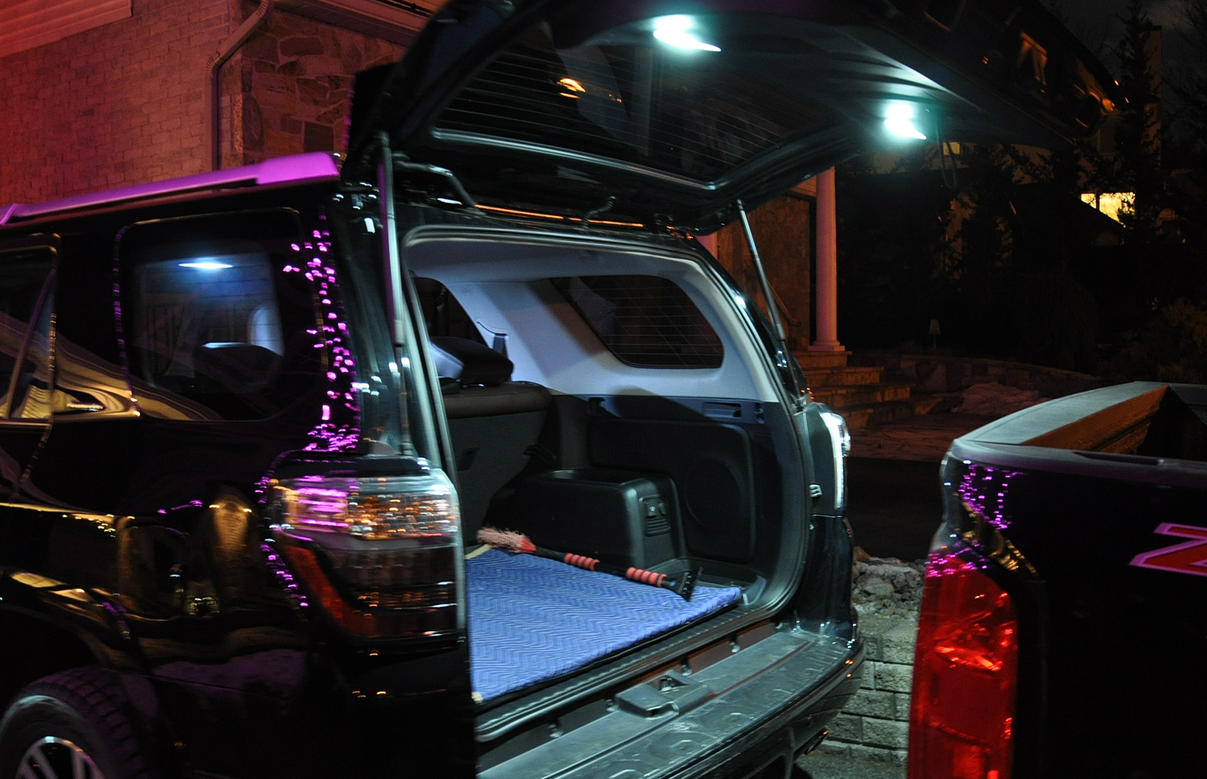

Here are a few photos of the 5630 LED bulbs in the licence plate and tailgate.
Also my 886 reverse light, though the pic doesn't do it justice.

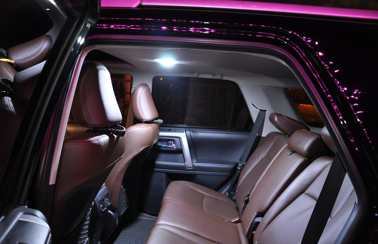

The interior center light is a 48-LED panel I ordered off eBay.
