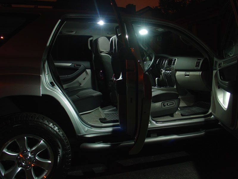

Led Interior write-up - Part 2, 5000k version

I had 5000k from the start, wayyyy better in my opinion, even 5000k still emits some blue. Matches my HIDs perfectly, I now run 5000k everywhere.
Fresh from the can't leave well enough alone department, comes a page I did about changing all my interior bulbs again, this time to 5000k color from 6000k color. Let me know your thoughts. Thanks.
Toyota 4Runner Interior 5k LED Lighting Conversion
