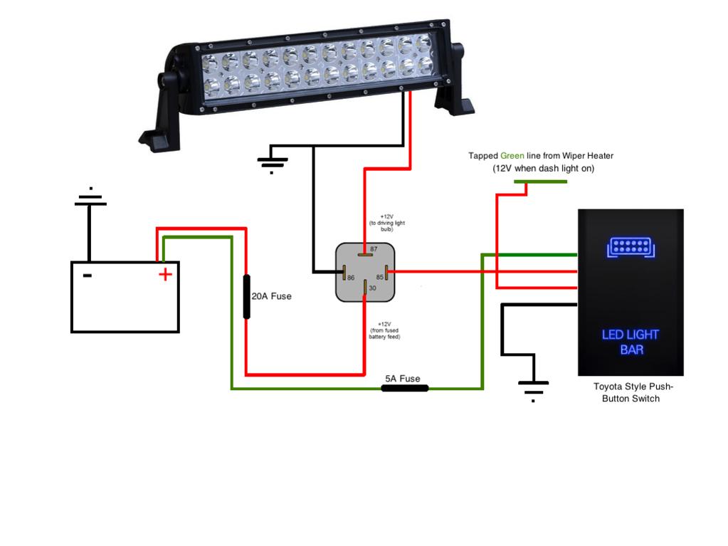

I'm going to assume 3 wires coming from relay are 1) Hot lead (12 volt positive +), 2) Relay trigger wire (connecting hot lead to this wire would engage/trigger relay turning on light bar), 3) Ground wire (negative -) would be ground for illumination on switch when turned on. Wire is not needed when interfacing with AOB in this case.
AOB Switch Wires;
Black - Connect to gray factory wire (- dimming) outlined in link
Blue - Connect to green factory wire (+) outlined in link
Red - Connect to relay trigger wire (power out of switch to relay when switch is engaged/turned on)
Green - Connect to hot lead from relay (power into switch)
So, my understanding is that I'll be connecting AOBs red, green, and black wires, to their respective OPT7 wires.

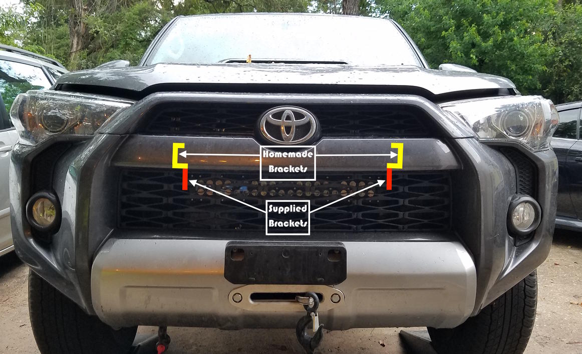

Thanks [MENTION=81322]barryhiram[/MENTION]. If the grille wasn't 100% wedged in place and hopefully never coming out again, I would take it out to get some mount photos.
The concrete angle brackets I got worked perfectly with these two existing bolts in the bumper support to accommodate the 32" bar, both in height and width. I didn't have to drill or cut anything.
Was shocked at how well it worked out.
edit: Link to said brackets: http://www.lowes.com/pd/USP-2-in-x-5-187-in-Steel-Concrete-Angle/3692046

Here is the wiring I used:
Sorry I didn't get an image of the brackets I made. Basically a "C" bracket hanging from the bumper support. No drilling. Here is an approximation of what's going on:
