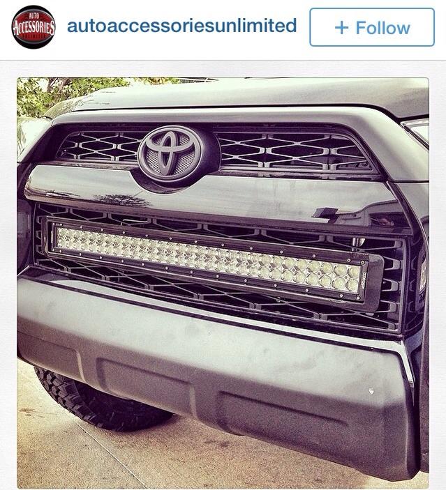

[MENTION=103267]Saker[/MENTION] should have put in a patent on this. Saw whilst trolling through Instagram .
Saker! Any idea of the biggest bar that could fit in that grill area?
No Marco I don't.
But if it mounts with the fixtures like mine does, mounting studs/adjusters under the light bar, it probably only be limited as to the width of the grill opening available.... if that makes any sense to you.
Just remember the grill does have a slight curve, so that may cause some interference.....
EDIT: you could always check on curved bars & opening!
