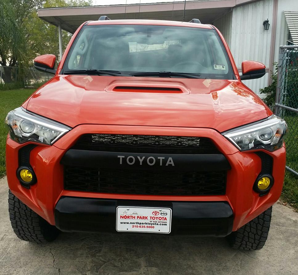

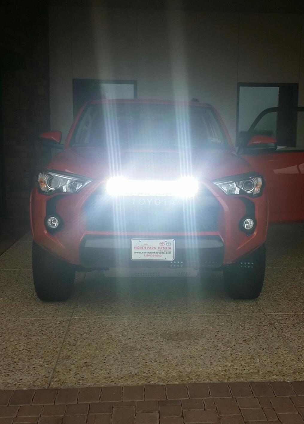

I'm pretty happy with mine behind the grill, plenty bright.
Which light bar did you use? I would also like to see how it patterns at this height. I do like how this looks with the pro grill.
I am also, concerned about the longetevity of this setup with the heat of the lights affecting the grill. I dont think that it is that great but it is a concern. Does the mounting place also affect the longevity of the unit?
LED's don't produce heat themselves but the heat may come from the back of the light bar which should get plenty of dissipation due to where it's mounted...

I'm sure with the light bar in front of the grill it would be a huge difference, but I was a bit surprised myself on how bright it was behind the grill. One of the main reasons I did it behind the grill was so it would be harder for a thief to get their hands on it.
Well even with my high powered flashlights IE surefire or fenix with 800-90 Lpumens it gets quite hot in front of the light. Also, very worried about engine temps affecting the light. I know some are withon milspec and the hat would not affect them... But they are expensive.
