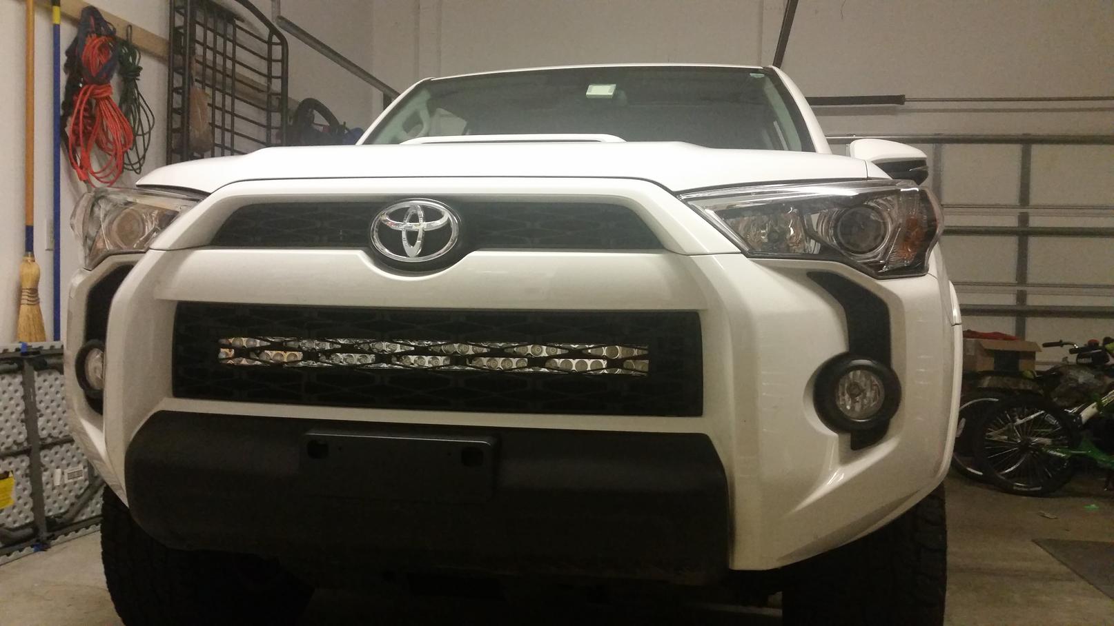

finally done!
Some takeaways...
- take your time
- pull the grill and the filler panel and the top shroud as you're going to need all the room you can get especially if you are putting in a 30"
- read about the wiring harness you get (i hooked mine up straight to to the battery with. issue is that there is a little red light that is always on... )
- have beer ready too
Overall very happy with the install, it is solid. I'm still stumped on the wiring and what my options are though. I'd prefer not to have to buy the AOB switch but will if needed.
Question - what can I do to get the switch to not draw all the time? I'm no wiring guru so try to explain in the simplest terms (pics are awesome too) there are three wires going to the switch but the eBay harness didn't come with details of what they are.

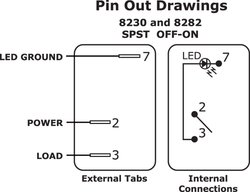

I understand switch has an LED light built in, it's purpose is to let you know that switch is turned on, LED indicator off, means switch is off. Changing power source won't change issue other than having the LED shut off when you turn the truck off. Is it possible the manufacture reversed wires during assembly, certainly.
You should have three wires running from relay to switch, correct? One wire will be constant power (+), one wire is ground (-), one wire is trigger wire to activate relay. Here is a schematic of a standard on/off switch for reference.
Pin #2 is power, when turning on switch, contact is made between pin 2 & 3 thus sending power to relay turning on LED light bar, but you will notice it also sends power to internal switch LED. If pins 2 & 3 are reversed, internal LED would remain on all the time despite switch position. I would definitely test wires to verify they're correct.
A simple way to turn off switch LED without rewiring to fuse box, simply disconnect ground wire on pin #7. Light will remain off no matter what switch position is.
