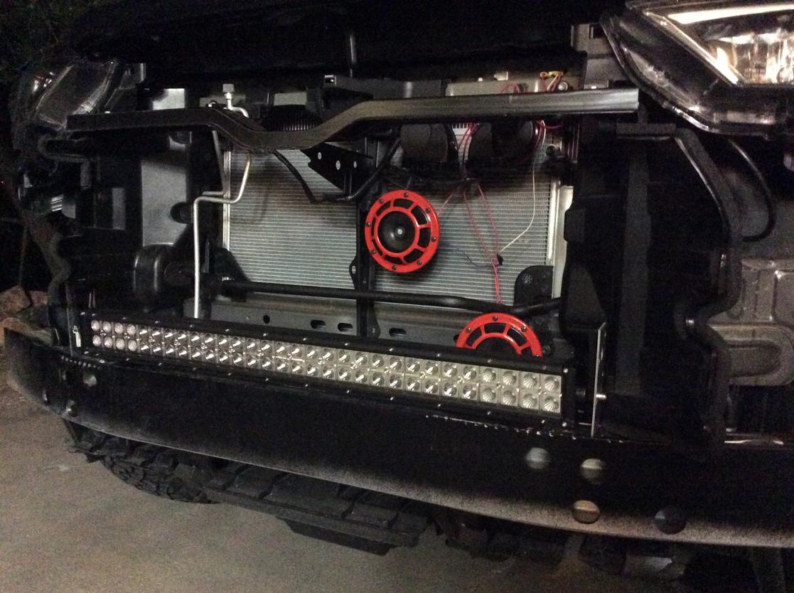

So following your advice I decided to tackle this project.
I am installing a OPT-7 C2 32" LED light bar. Amazon warehouse deal for $140

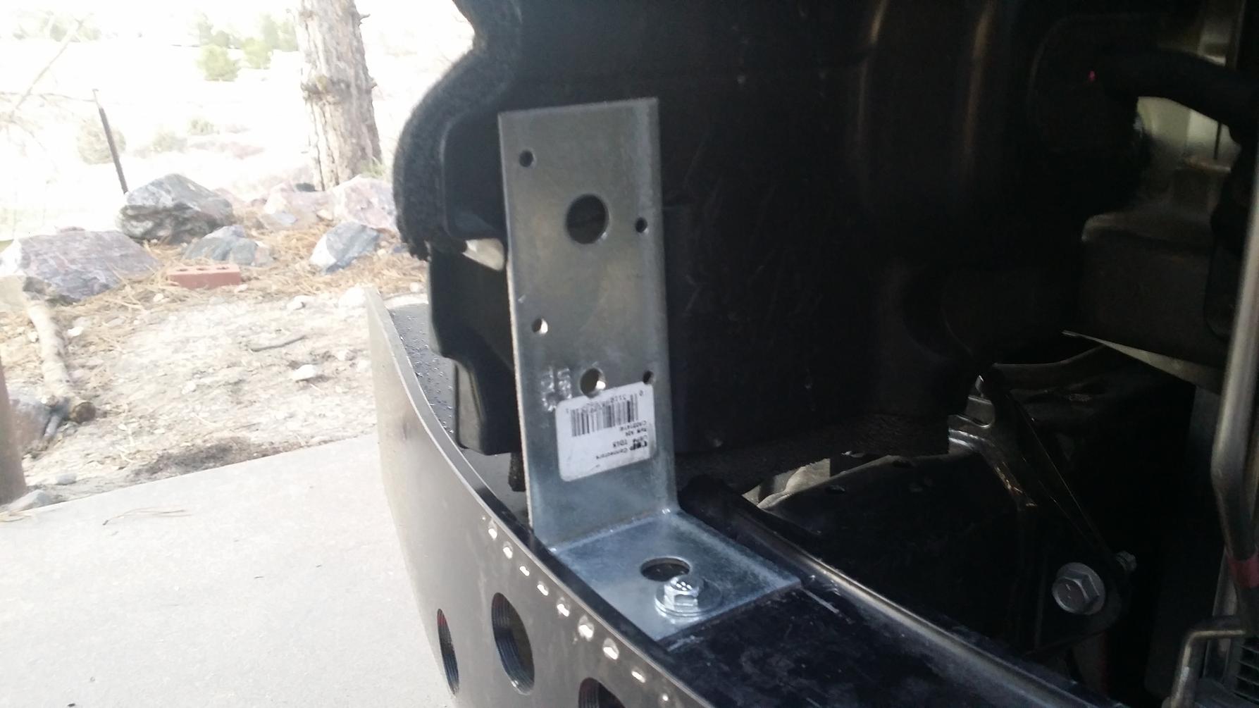

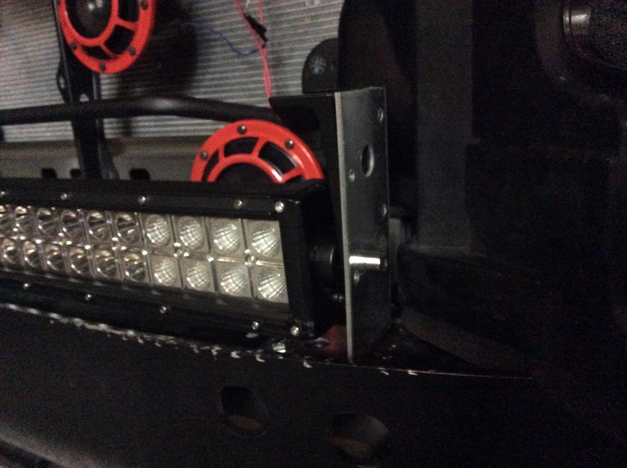

Knowing that the bumper enforcement was made of aluminum, made the process easier.
I removed the front end, only way to get the light installed. I used a 2" wide and 5" tall L bracket from Lowes to install the light. Luckily there are several holes in the bumper that I used to screw on the bolt in the bumper reinforcement.
Will use the provideded wire harness and switch until I can get some AOB switches in blue.
Don't really know what caused those marks on the bumper reinforcement. It was there when I removed the styrofoam bumper piece.

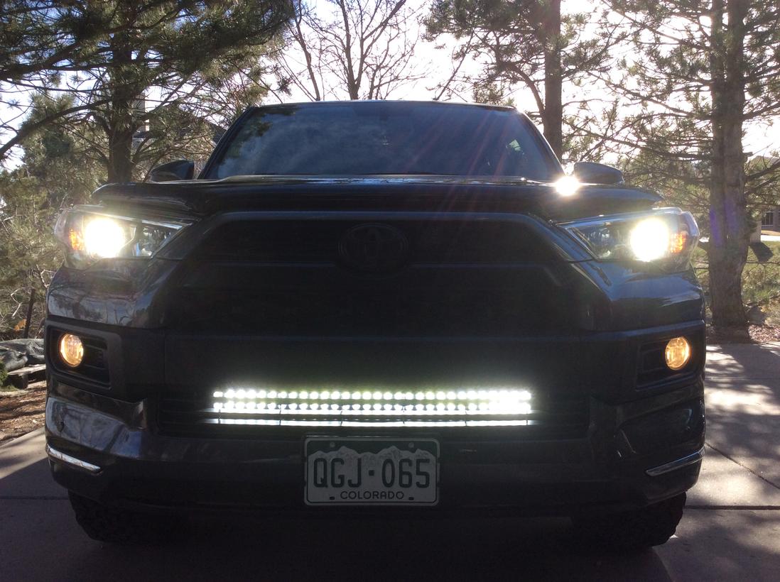

Yes, I have a 16limited. Ian going to use the lowest part of the grill. It is actually raised about 1/2" off the bumper reinforcement.

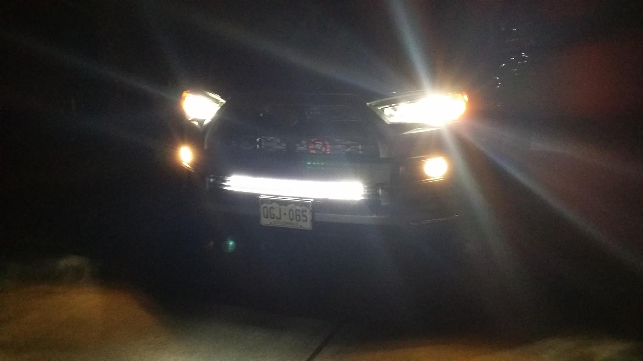

Some finished pics.
Installed in the lower grill. Won't know till tonight on how well it'll light up the road. Definitely need to adjust it tonight.

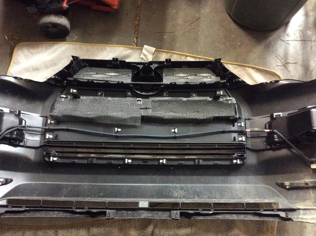

Does anyone know how to remove the lower grill?
I tried removing the 4 white clip and there are 4 screws underneath another cover. Do I need to remove the bumper cover and fog light?
Need to take off the front anyway, forget to reinstall the styrofoam bumper piece.

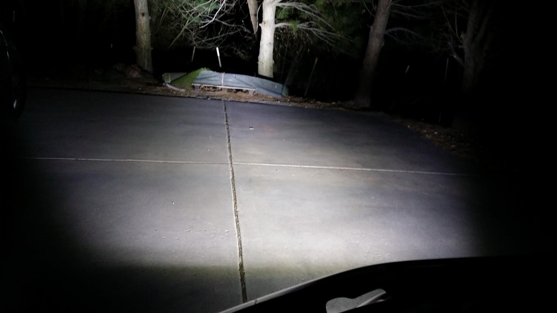

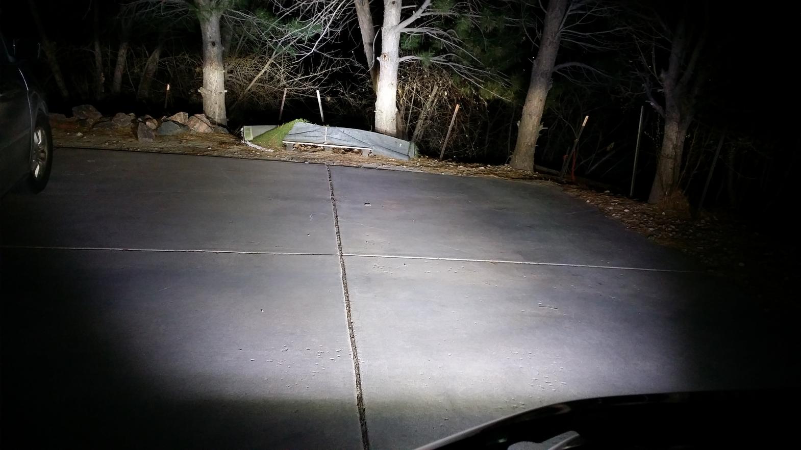

Night shots
2nd shot is without HID light.
3rd light is with HID lights
Still need to adjust the beam a little better.
Light output is really bright.
if I could get rid of the lower grill , I would really open up the light beam.
