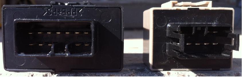

So it warmed up a bit and I pulled my dash apart and got to the flasher relay and realized I bought the wrong one as a replacement.
The stock OEM flasher relay is a 12 pin unit. I had an 8 pin unit, so I had to abort.
I quickly checked ebay and can't find an equivalent 12 pin LED flasher relay. What relays have you guys used to replace the stock one?

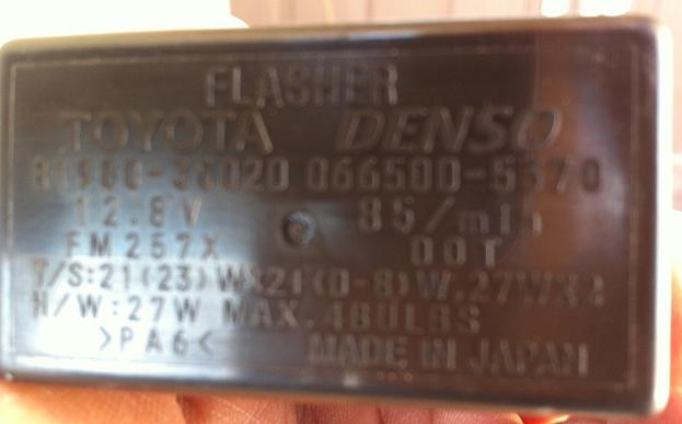

The stock one is 81980-35020 066500-5570
Here is a pic of the OEM one and then a comparison between the 8 pin and my stock one.

The led flasher relay replaces the factory relay, take a pic of the back of the fuse box , see where the 12 pin plug go to, it should go to a 8 pin plug, i do recall seeing it in a service manual. I think u might lose the day time running lights.
