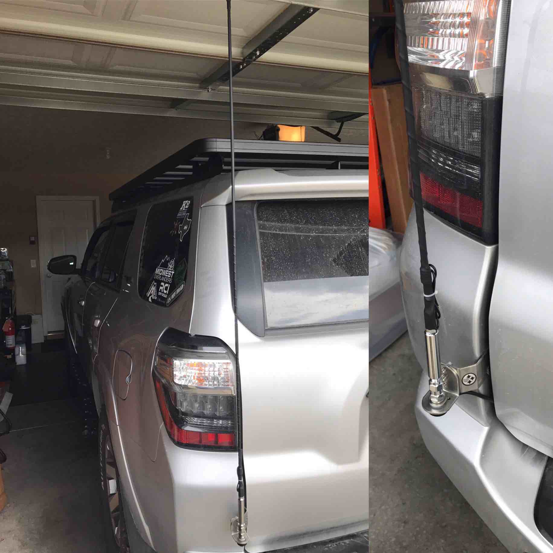

Looking in to the CBI mount. Anybody else figured out any other CB antenna mounting options besides this and the k400?
I'm looking into it. I'd like to have something that mounts to the lift gate hinge to get it up above the roof line. Something clean looking and non-permanent would be ideal. I haven't found anything that I'm happy with yet. I though about having one fabbed up if I can figure out a good way to make it work.

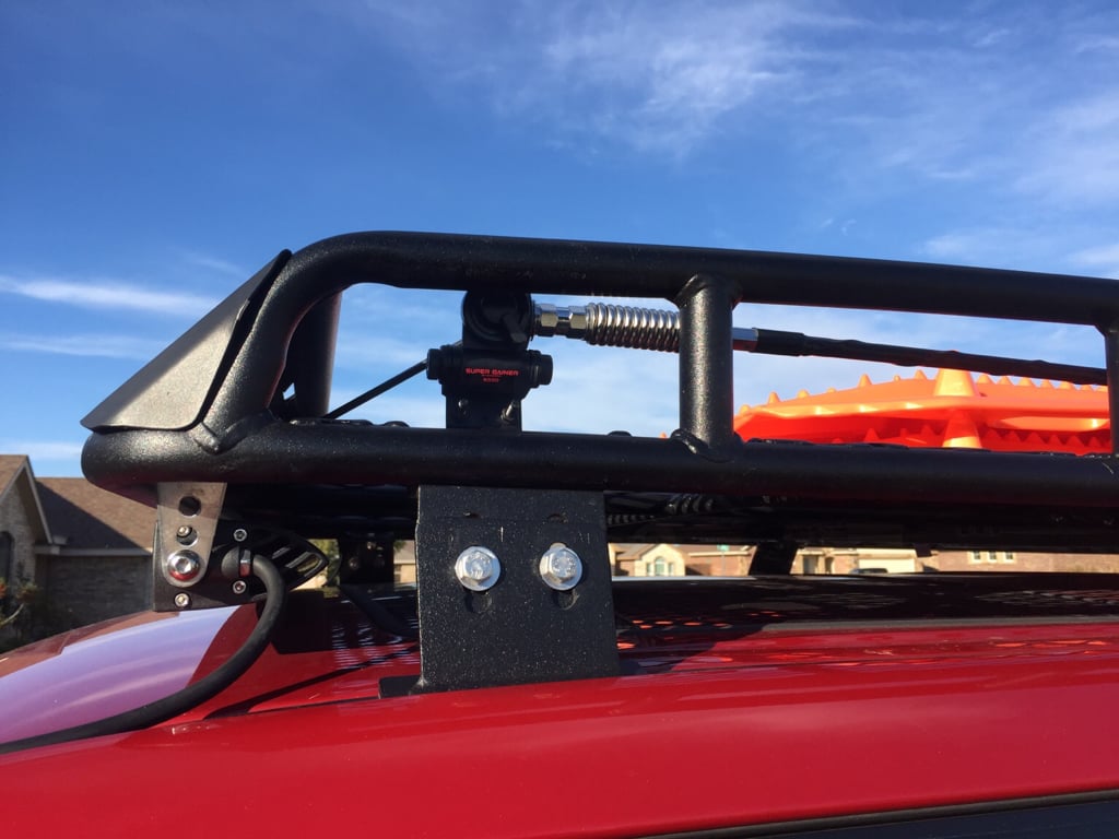

I use the Diamond K550 mounted to the expanded metal floor of the roof rack. It stays down most of the time but when I'm road tripping or want to use it, it goes up in literally 5 seconds. I have easily 7 mile clear reception while doing 75 down the freeway. I have a 5' Firestick and on spring in case I forget and go through a drive through. Lol.
