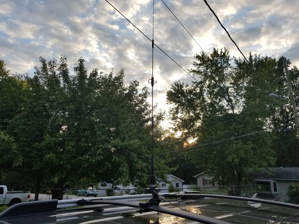

My vehicle is getting geared up for community emergency response missions. I'm in a group that does a lot of disaster relief, so being able to handle comms is very important. The 50W transceiver + antenna setup I use routinely hits repeaters 100+ miles away.
My goal was the best possible mounting position and lowest SWR, so that meant placement would be high and in the middle of the roof with a solid ground plane. Because I didn't want to drill the roof, my only option was a cross bar mount with a bottom hat. The vertical and radials were tuned to VHF using a handheld analyzer.

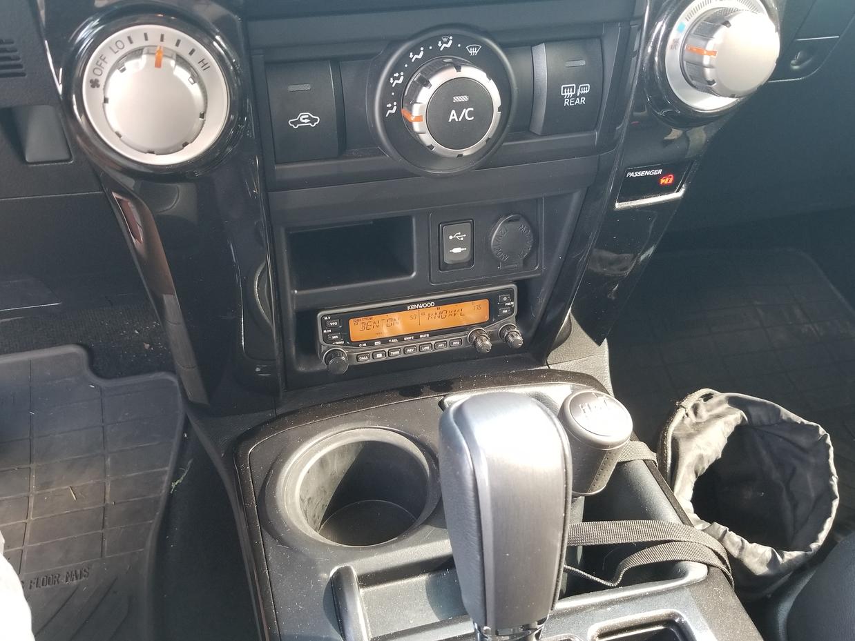

I tapped into the stock AUX input and am building a source selector. My radio is a TM-V71a, and it features 2 line level outputs. My plan is to have 2 selectors so I can output channel A, B, or A+B to either the car stereo, a monitor speaker under the seat, passenger headphone, or driver headphone jack.

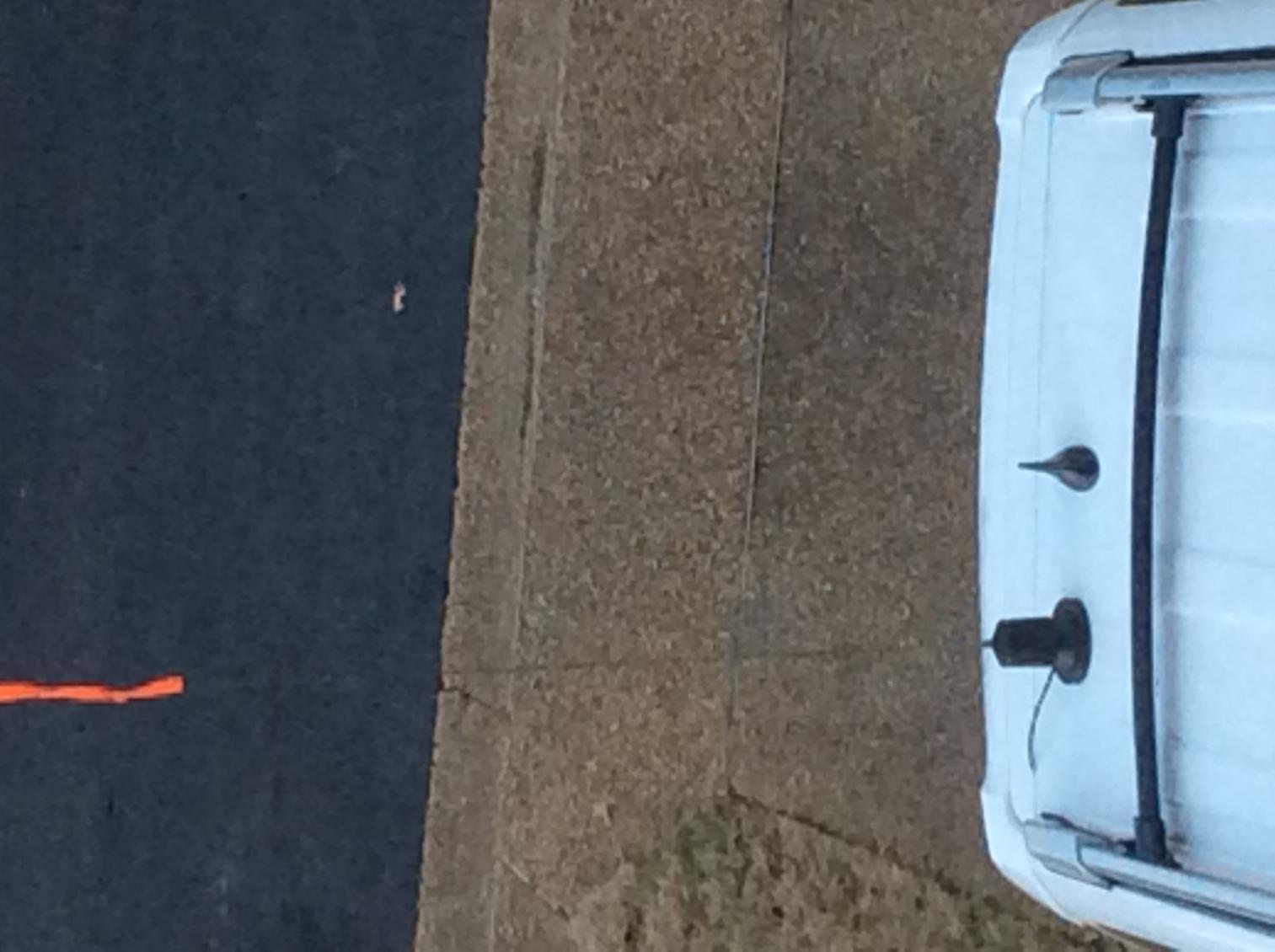

Not sure why a simple trunk-lip NMO mount doesn't get more love on here.
Easy to install - slips over the edge of the hood with no drilling. Two allen bolts snug it up to the underside of the hood and provide the ground. Add a ground strap to get the best SWR, though you can run it without. Coax slides right through existing firewall grommets.
Cheap - around $20 including the coax and PL259.
Various antenna options - I use a Browning 1/4 wave base loaded model that is also fairly cheap at around $30, offers good tx / rx, and is nice and flexible for hitting brush and so forth. SWR is not superb because this is a very length specific antenna, so tuning it to get 1.1 on channel 1 gets me about 2.0 on channel 40.

They mount via two set screws that come up from the bottom. That should be a "good enough" ground but you can remove a set screw and replace it with a regular bolt and two nuts, and then attach a grounding strap to that and run that down into the engine compartment to a solid ground if you want a better ground.
No rust issues. The black finish is stainless, it dulls a little but doesn't corrode.

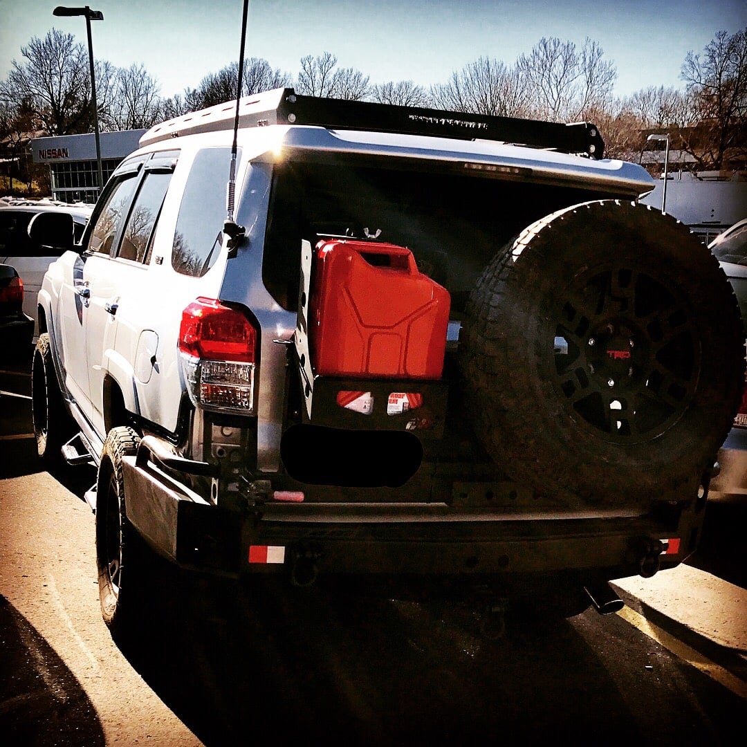

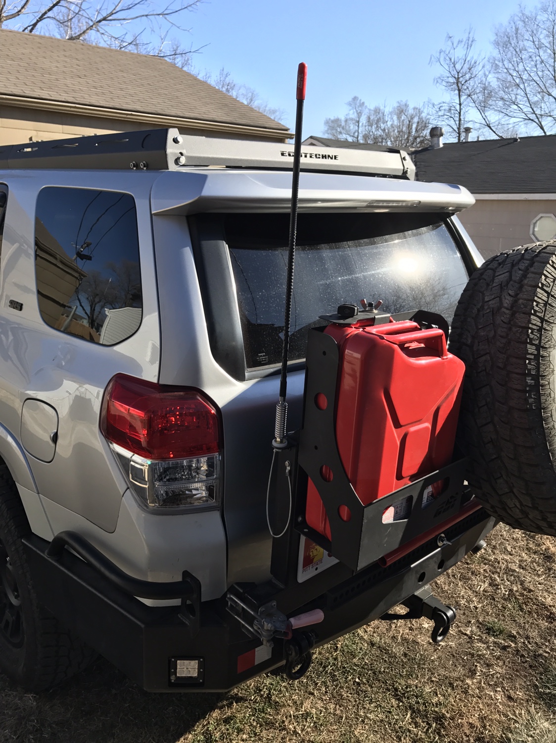

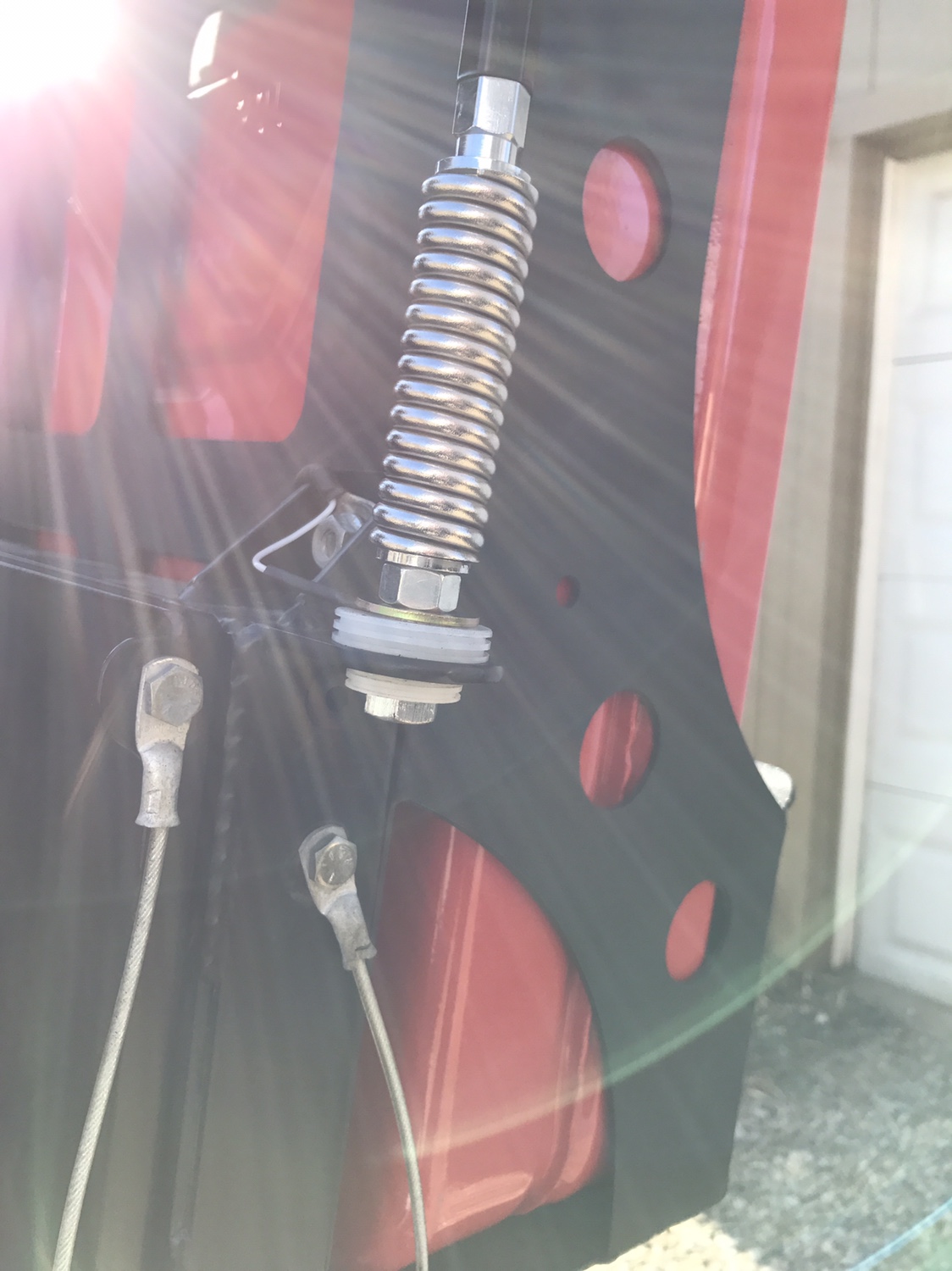

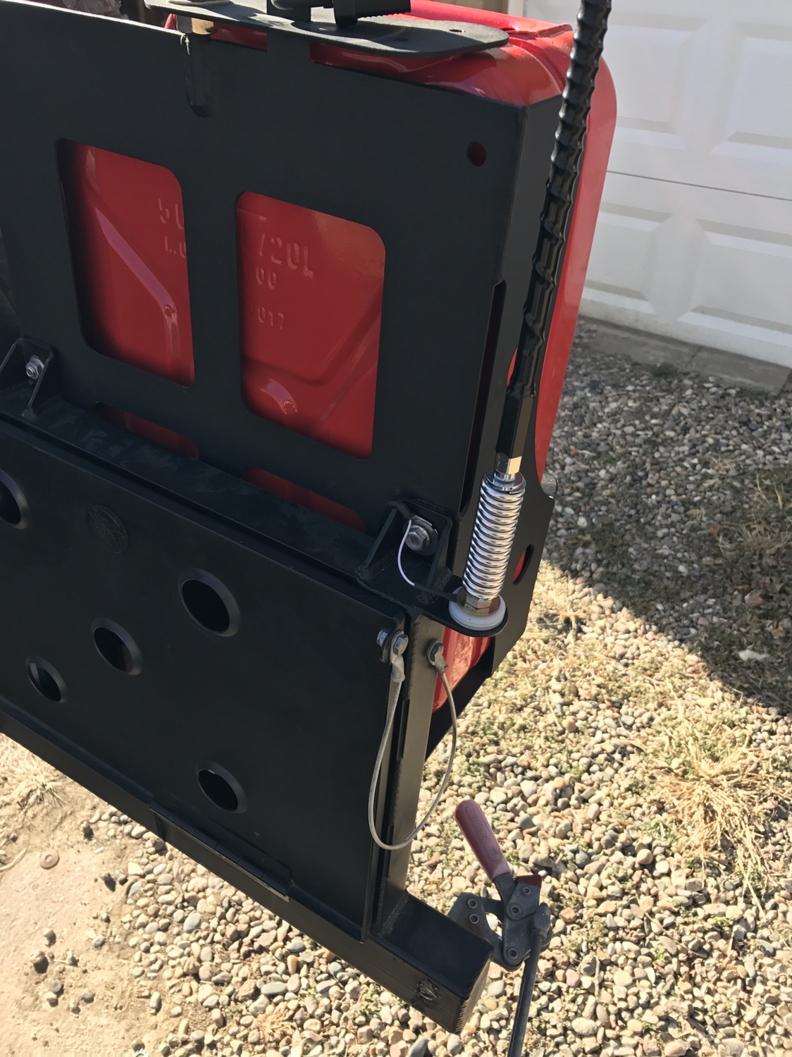

I had a diamond mount on the rear hatch. Always kind of worried about paint and rust issues. So a few weekend ago I disassembled the mount and with a couple items from the hardware store, mounted it to my CBI bumper in the bracket where I believe the camp light goes. It's was nice to have the diamond mount parts to swap over. For now I just have wiring zip tied to swing arm.
Old mount setup
New mount setup
Rear bumper fascia is now painted to match. This was shortly after bumper install.
Wilson 5000 Magnetic.
Location gives a SWR of 1.1 to 1 and a pattern toward the front and slightly left toward oncoming traffic.
Using a Midland 75-822 hand held that has been tweaked by my local truck stop CB shop for peak legal power.
