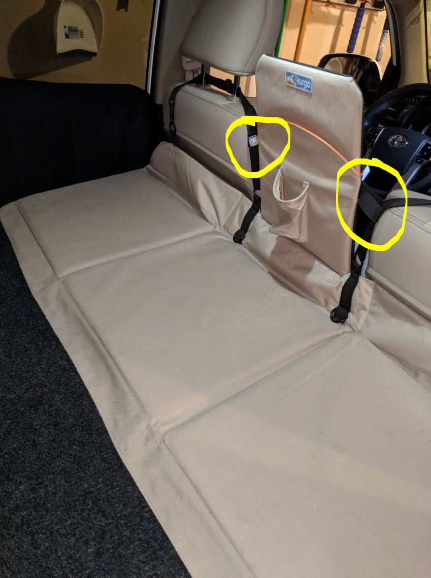

That looks awesome. Is it possible to configure it so a person can sit directly behind the driver, and the center pass through blocker is also down? Basically allowing a bridge from the 2nd row (backseat not the third row) center to between the driver and front passenger seat? Wanted to make a bridge for my dog to lay in the back, extending onto part of the center console/armrest.

The Kurgo divider is foldable into 3 parts. So you could configure it to allow for a seat to be free behind either the driver or the front passenger seat. However, keep in mind that the Kurgo uses the headrest to support itself and when you are using it like I'm using it, there'a strap that also goes around the seat (to keep it from moving around).
So I'm not sure I understand which configuration you need, but this is adjustable.

Hey! Thanks for the response. What I meant is having one passenger in rear seat. And then having the center hump covered using the Kurgo BUT having the upright center portion that blocks the dogs from getting behind to two front seats be down. So I would want my dog to be able to lay on the Kurgo bridging him from the backseat to between the driver and passenger front seats. Basically my dog likes to lay on the center console next to me as I drive so I wanted to make it easier for him. haha
It might be possible (I had to take my Kurgo out of the car for the next week) but you would just have to not use the headrest cable support. If you did, that center piece blocking the armrest area would just fall flat. When I put my Kurgo back in, I'll take a picture to show you.
See attached for now.

Thanks again! That looks awesome. I was worried that if I wasn't using one of the headrest cable supports (so that 1 person could sit in back and so center pass thru was also down) that the entire Kurgo unit would fail and not allow for it to stay and cover the center hump in the floor. Appreciate all the help!

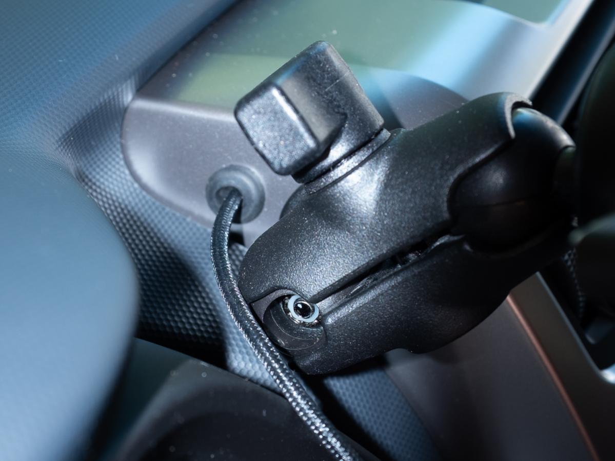

Clean drilled dash RAM MOUNT with power for iPhone

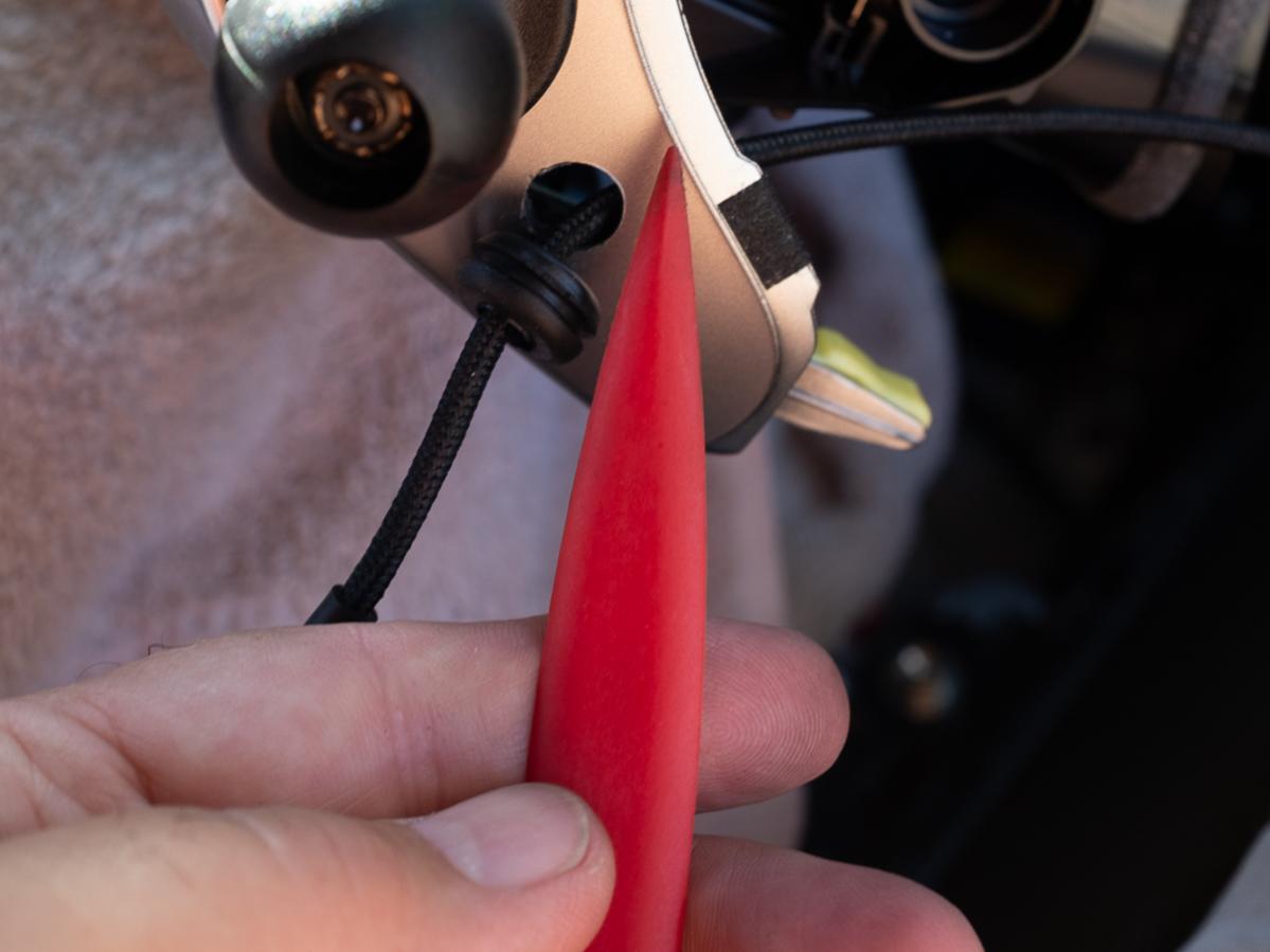

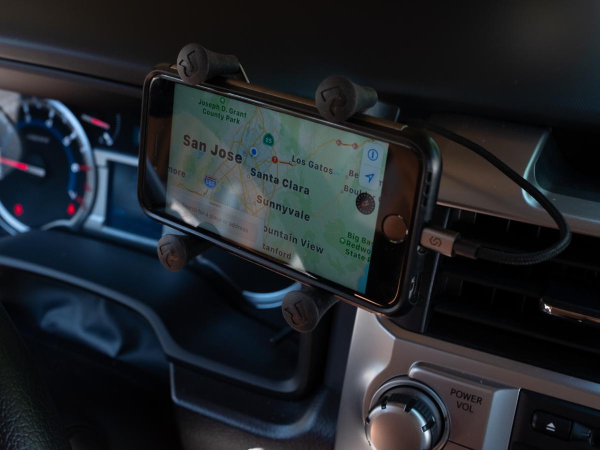

This is my first post. My first mod for my (new to me) used 2017 Limited
5th gen T4Rs

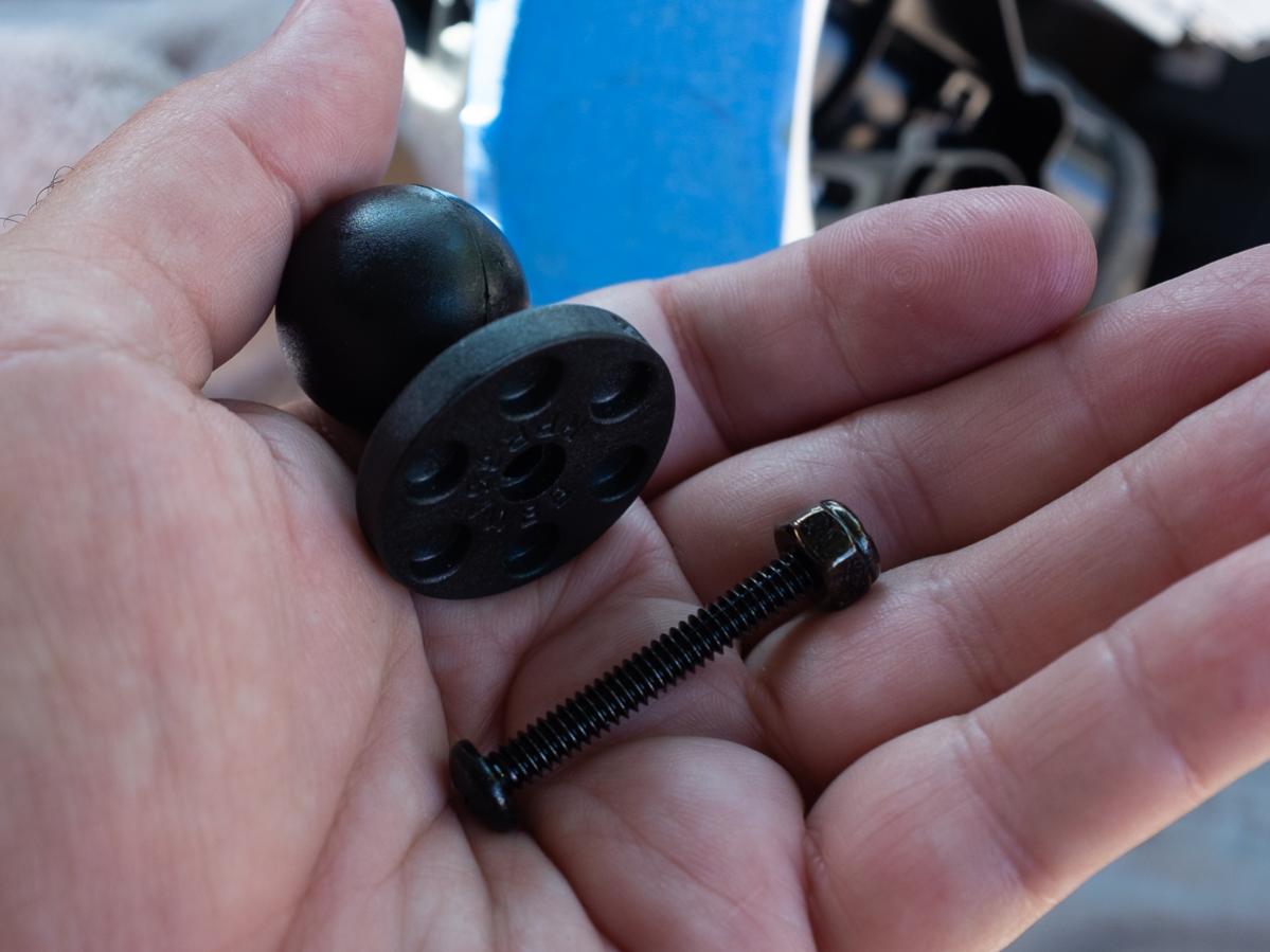

Not my idea, but I wanted a cleaner look. I looked at two other ram mount base pieces and didn't like either. One wasn't visually clean and I decided I wanted more support at the base. It took me forever to find this for some reason, probably because it's not a standard base mount, but I think it should be.
RAM MOUNTS (RAP-395T-BBU Stack-N-Stow topside Base with 1" Ball

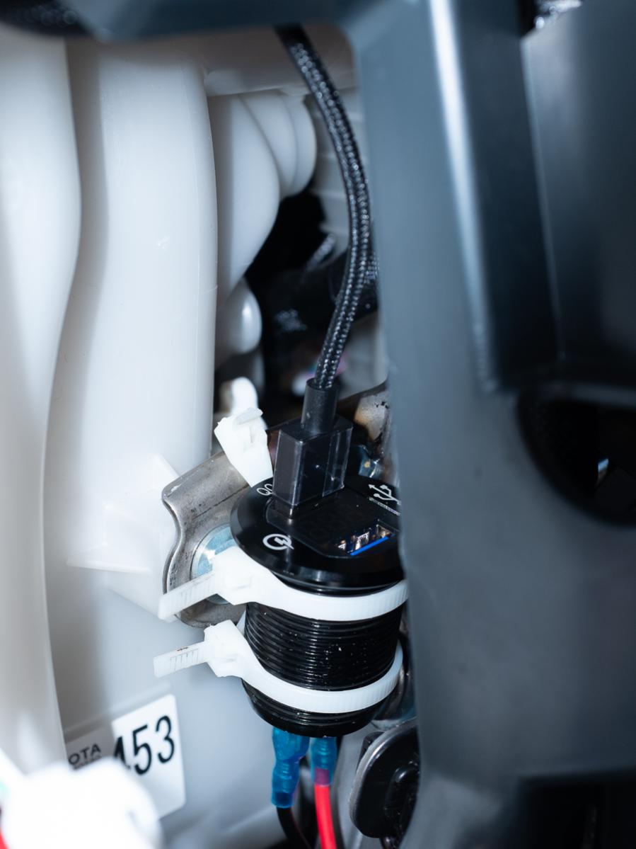

Secondly I wanted power for my iPhone run under the dash and separate from the Standard USB connected to the entertainment system. I tapped into the cigarette lighter power, it's already fused and connected to the key.
Here are my steps. (Photos show my how to)

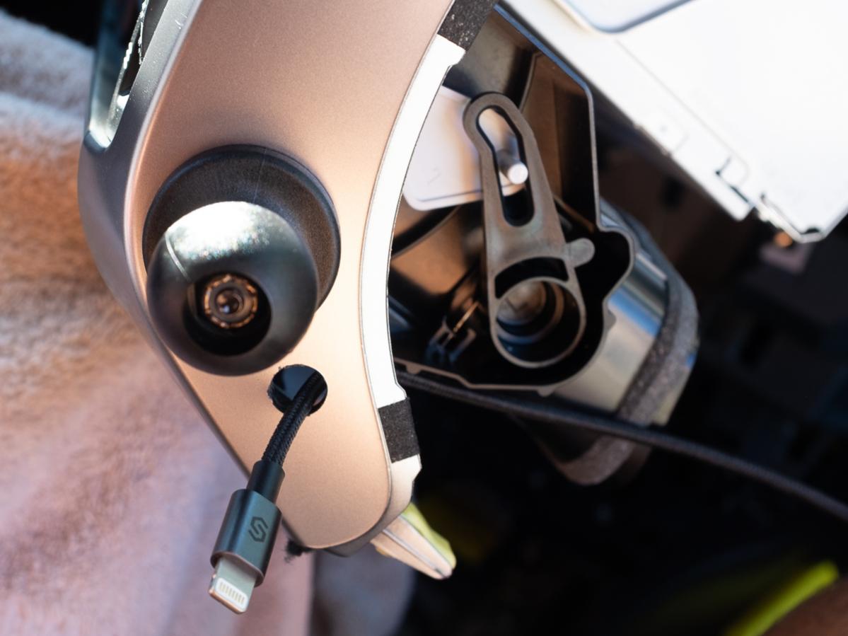

1. Used painters tape to protect the plastic and give me a rough position.
2. Pulled the dash apart including the area where the cigarette lighter is. I did not include these steps they can be found in this group and on YouTube.

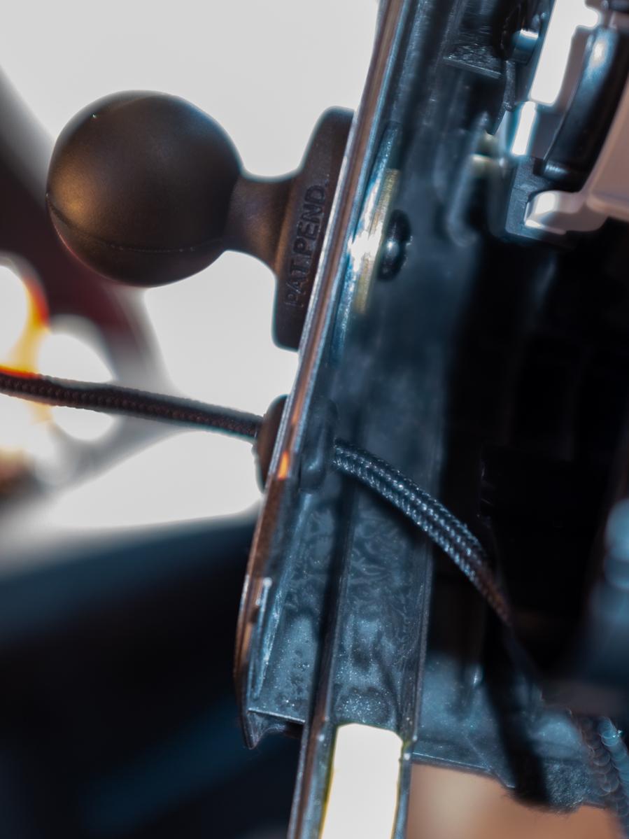

3. I needed to remove one wire from the entertainment system, I think it was the antenna wire. This allowed me to flip the assembly upside down and gave me more room to work on it from the passenger seat.
4. I figured out the best location visually, that was also clear internally. Note, there was barely enough room to use my low profile screwdriver.
5. Drilled a hole big enough to slide my iPhone connector through. I used a rubber grommet for a clean look. I did a practice test with a scrap piece of plastic to make sure I could get the plug through and insert the rubber grommet afterward. A little tight but worked well. I used a plastic dash removal tool to seat the rubber grommet. It was a pain, but worked well.
6. Made sure I had a clean path for the power cable to reach the cigarette lighter area.

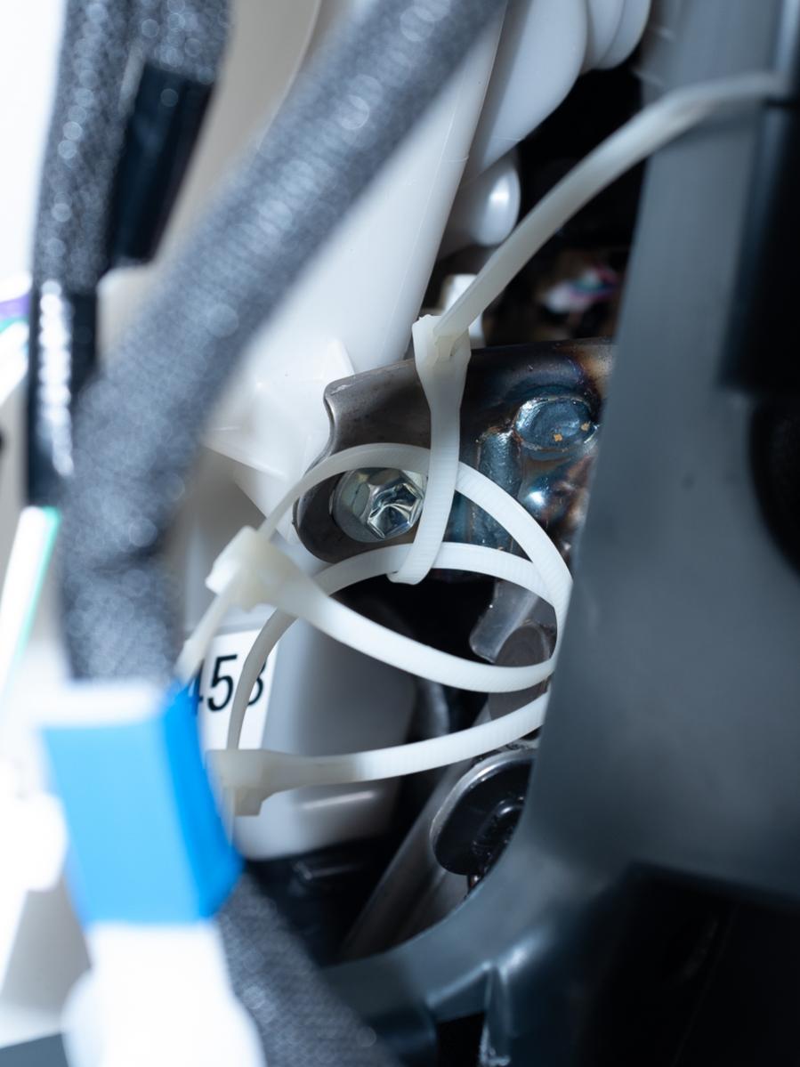

7. Used a cigarette lighter style USB power supply. After looking at all my options. I used a metal bracket that holds the air conditioning ducks. One vertically wrapped tie wrap with two horizontal tie wraps. The bolt worked well to space the horizontal tie wraps.
8. Connected my power by tapping into the cigarette lighter and staggered the soldered connections for safety reasons. I used electrical tape and put the cable protector back in position. Black and white wire is the ground.
