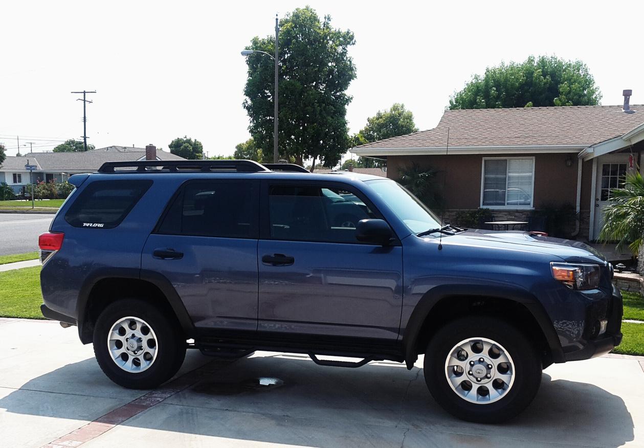

I put 5100s in front set to 0.85. I think if I had done 1.75 it would be level but may get a reverse rake when loaded. Photo is with 0.85. The rear is 1 inch higher measured at the top of the wheel well.

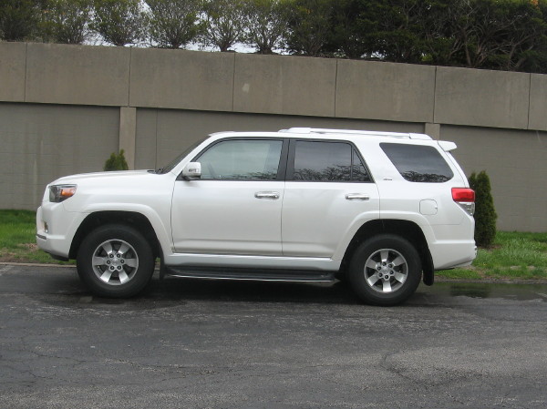

Here's mine set @ .85. It has a very very slight rake, but personally I'd not want the front set higher.

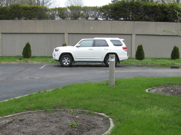

Of all the angles you could've taken this picture to show us the slight rake, you pick the one angle that blocks the entire rear wheel well with the only pole in sight. :doh:

Now you took a picture of it on a hill. Man can't you take a decent picture. LOL Just kidding.
What do you mean by the rear is 1 inch higher. I was under the impression that leveling meant to just raise the front. Why is the rear higher?
I set the 5100s to 0.85 and not to 1.75. This brought the front up, but not enough to level it.
That helped the nose dive and when loaded does not go reverse rake.
I also added Air Lifts and leave them at 5psi unless carrying more passengers and gear.
In factory form, the front is ~2" shorter than the rear (measured at the fender)...so if you only lift 1" up front you still end up with the rear being 1" taller, that's all :)
Keep it up b!tches, I've got plenty of pics.

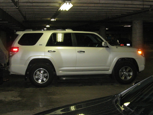

As to "leveling", you're right; .85 still has a little rake, but I preferred that to the 1.75 setting. I just didn't care for the stock rake, plus I wanted firmer shocks. The springs are just a little too soft also, but I don't care enough to fix that.

good grief, philsey, this picture is at an angle! LOL

Much better picture. That looks nice. I suspected the springs are soft too, but like you I don't want to replace those if I don't have to do so. Are you saying the alignment caster settings won't work and there needs to be some other setting?????
No. I'm saying that MINE had some steering wander from new. After reading here about how to improve this, I waited until after installing Billys and tires to have an alignment with the caster set to +4 deg.
