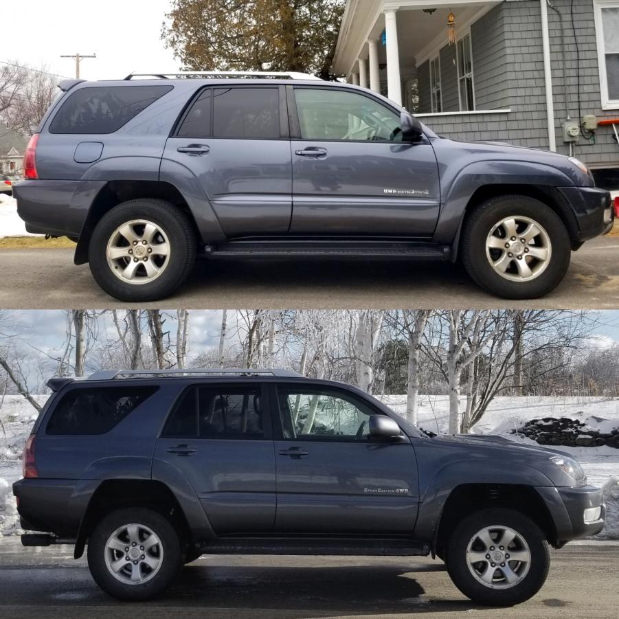

Here's my before and after on stock wheels and tires... toytec 2.5" springs front and Daystar 2"spacer rear on bilstein 5100s all around. It won't look bad IMO. I'll do tires and wheels eventually but I'm very happy currently.
What tires are those 265/65/17? I think if I get ome 884 and the bilstein springs I got with the kit 1.8 it should look about the same as that? How does it ride on the highway?

Yes, 265/65/17. It rides awesome. I opted for the Toytec 2.5" springs to get the height I wanted while using the lowest perch on the Bilstein strut. It rides better than the stock XREAS (which had no issues... just age)
At 1.8 you will have less lift than I do and I don't think stock tires will look funny at all. I don't foresee handling being an issue either.
