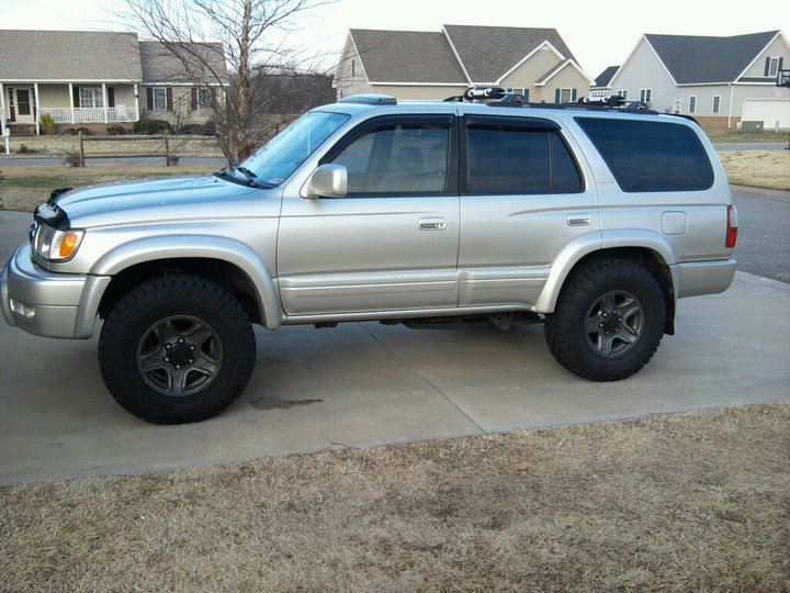

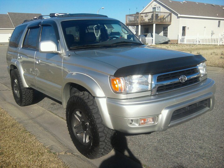

I have spider trax 1.25in with 265/75s with stock rims on mine an it makes it flush with the flares.
