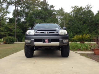

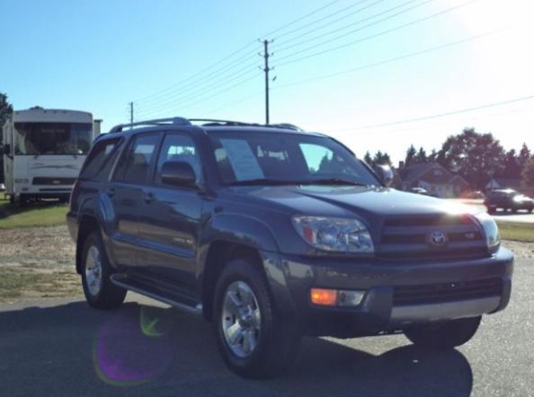

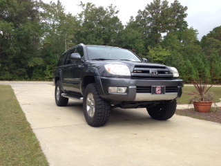

Got my 4runner 2 months ago and I have loved everything about it so far.
2003 v8 limited 4wd
first pictures are when I got it from the dealership stock, I've added 3 inch toytec coil spacers to the front, a front diff. drop, and 285x70x17 federal couragia m/t

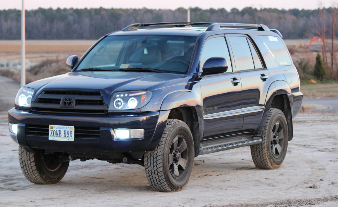

2007 Sport Edition
Front Lift: 2" Ironman - 1/2" shock/spring spacer - 1" Daystar spacers
Rear Lift: 2" Ironman (netted 2.5") - 1.5" Day spacers
Front Height: 40" street to center fender.
Rear Height: 42" street to center fender.
Wheels: 16" x 8" (0 offset/4.5" backspace) Pro Comp Extreme Crawlers Series 52
Tires: 285-75-16 Definity Dakota M/T
I posted some of these on some other threads as well...

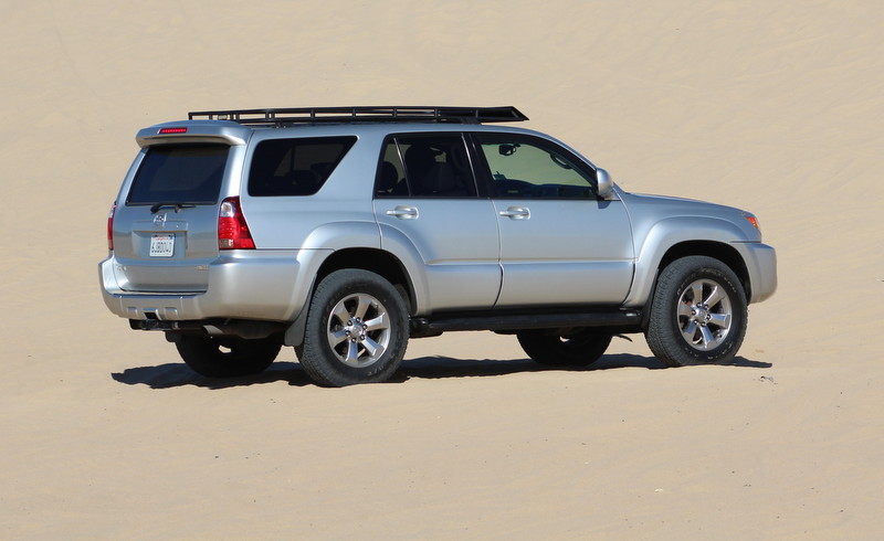

RR 39.5"
5100s and 885 coils up front with light racing upper control arms and 5160s and superflexes in the rear. Then also a daystar spacer in the rear on the driver's side to correct the lean.

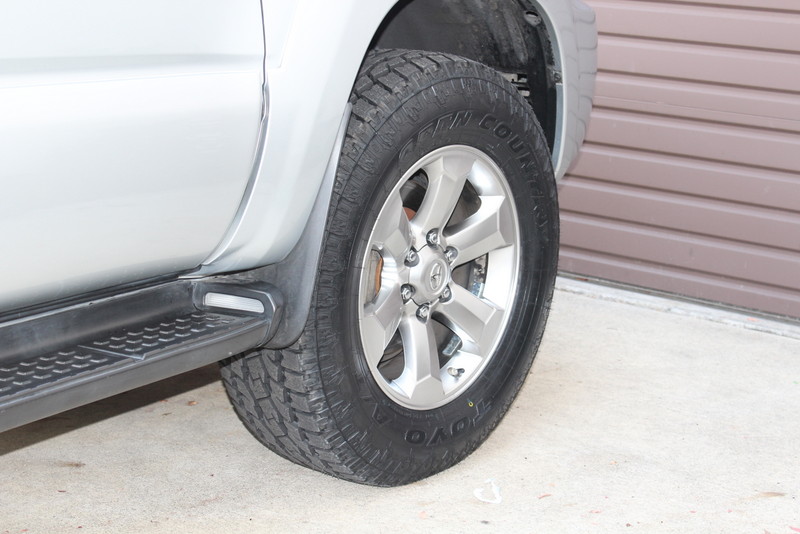

Daystar budget boost (1" spacer) front, FJ springs/shocks all around.
255/70/18 Toyo AT2's
