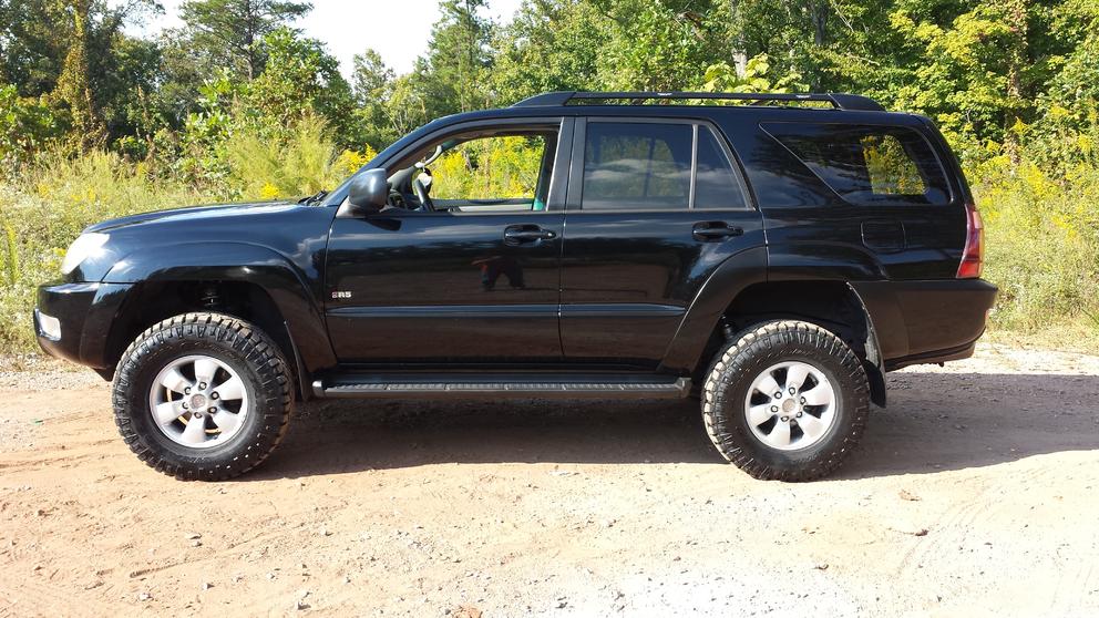

Lift is done. Got more lift than I expected.
Front before 31/3/4"
Front after 37"
Rear before 35"
Rear after 37"
Front - Bilstein 5100 set at 1.75 with TJM XGS coils. Was expecting 4"
Rear - Bilstein 5100 Moog FJ coils

Did you go with different tires or plan to? What size tires do you have on in this photo?

That is a lot of lift up front, are you gonna lift the rear or lower the front? Or do you like the baja look?
Trying to decide between spacers or new wheels. Might do spacers for awhile to save up for wheels. Plan is to upsize tires when the Nitto's where out. I think the tires are 265/60/18, they were on the truck when I bought it.

Did you do uca's or anything else? Or is everything but shocks and coils stock? And which coils are those? Link?

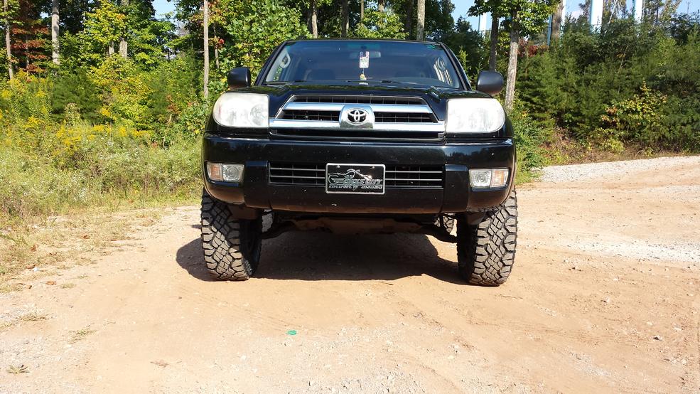

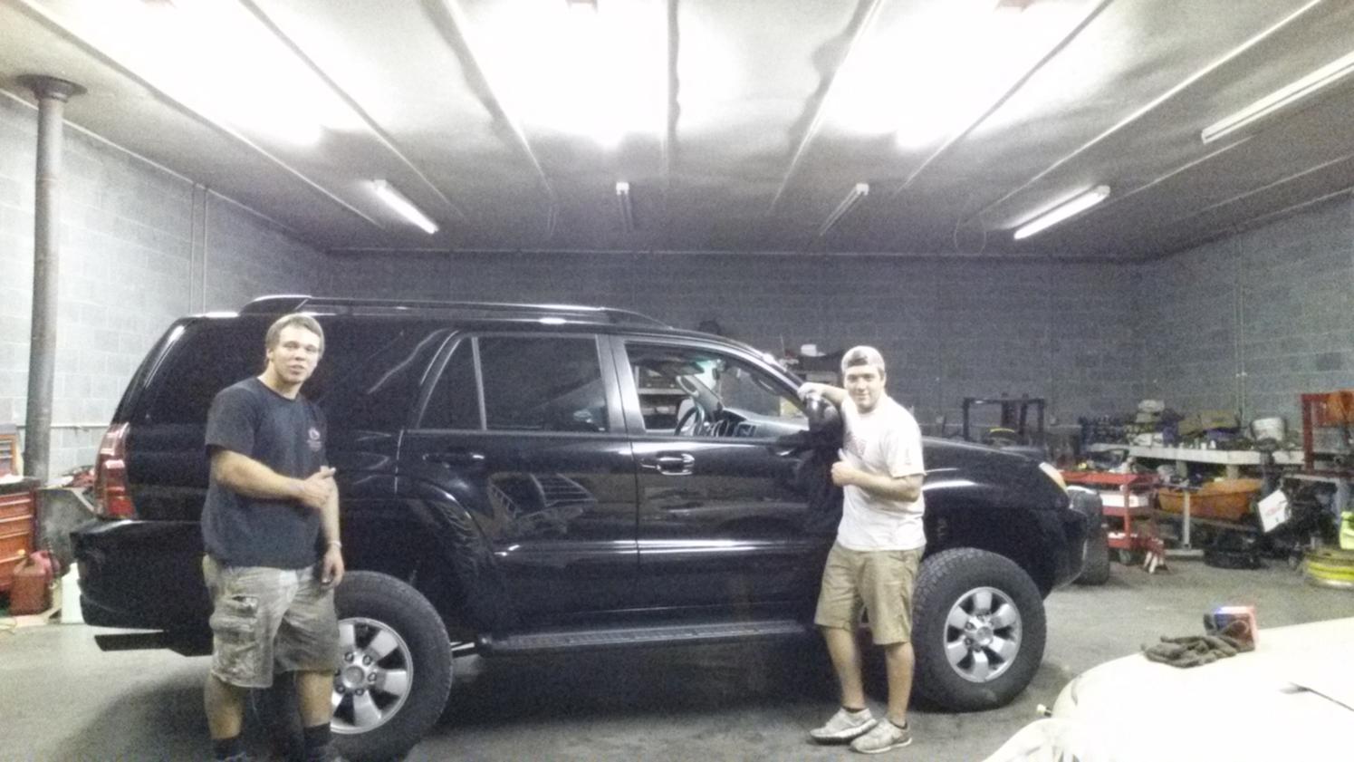

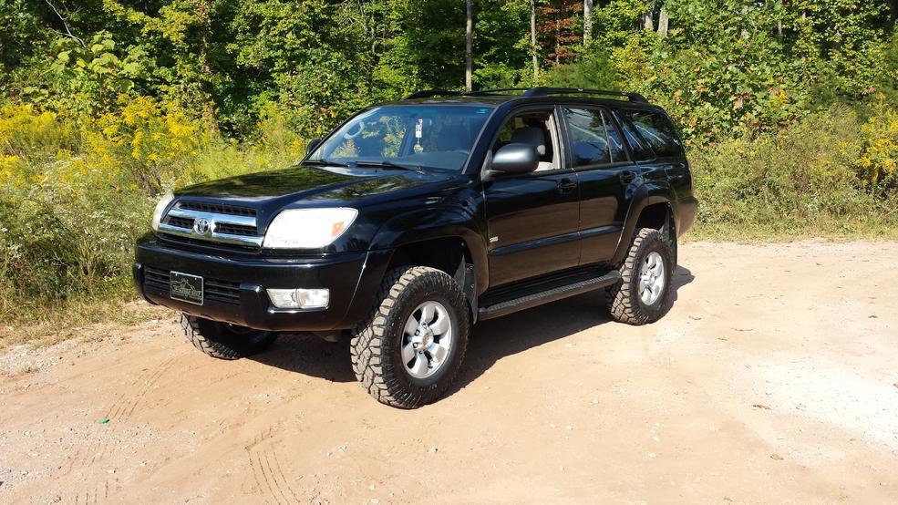

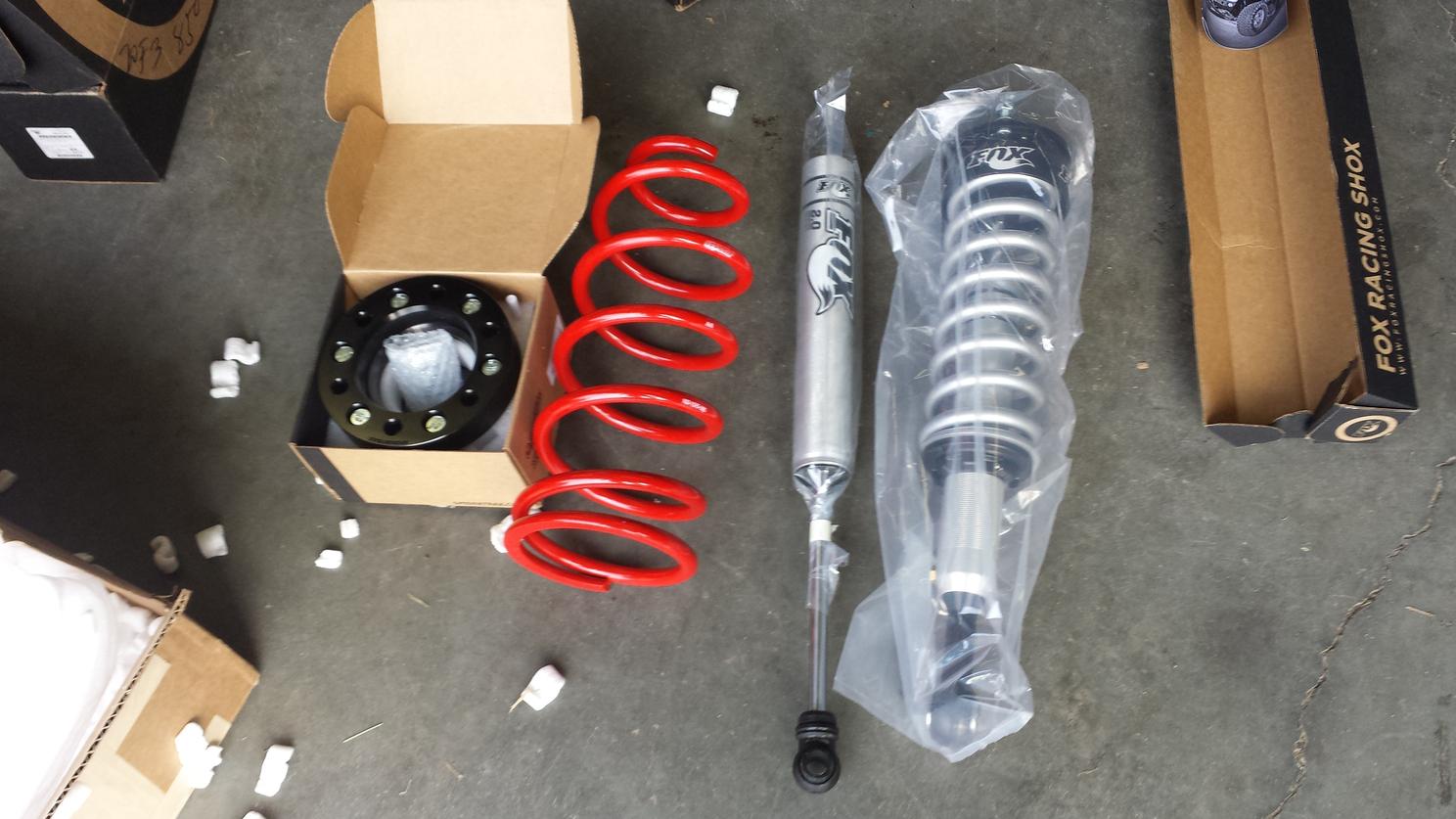

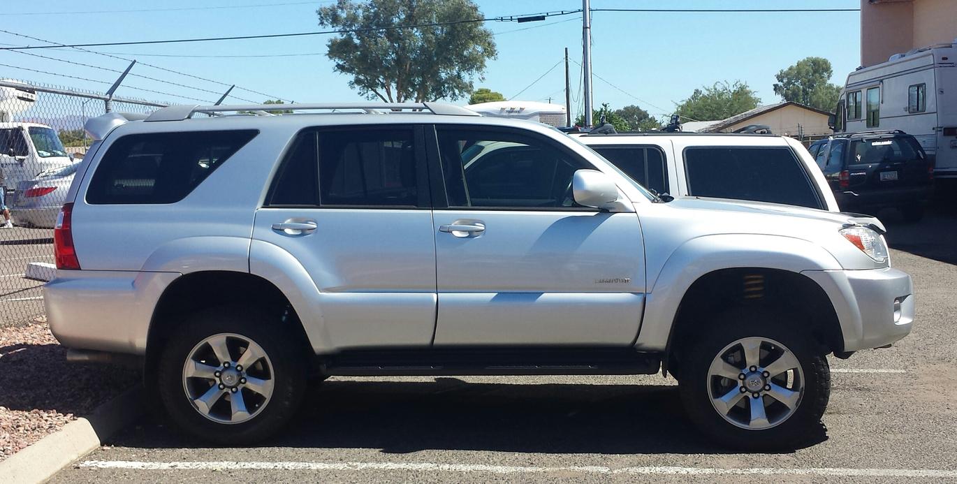

Got some goodies in this week and couldn't be more happy with how it turned out! :D
Fox 2.0 coilovers and rear shocks with Sway-A-Way 1.5" rear coils.
Spidertraxx spacers with 265/75/16 duratracs.

Everything is stock except as stated. Everything was good with the alignment as well. It is a 2WD so maybe that is why. The coils are TJM XGS lift coils (770FR881) for the T4R. I got them through Andy's Autosport for $186, that included tax and shipping.

Oh OK. Not sure if it makes a difference either. Looks good though!
