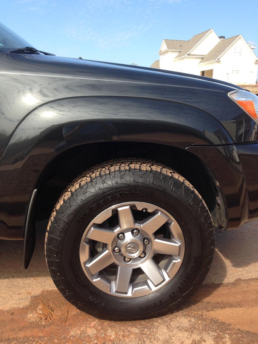

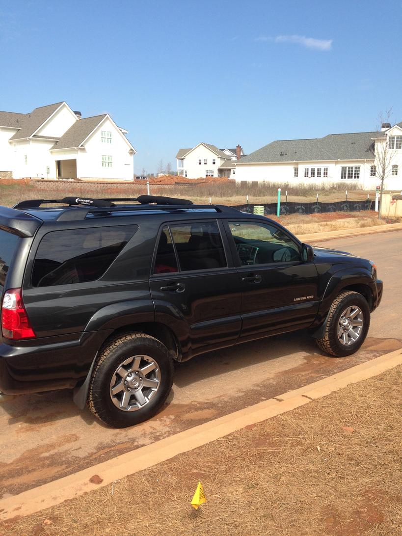

Got these on a few weeks ago, but finally got a nice day to wash and wax her.
2.5/1.5 Daystar Spacer Lift
Cooper Adverture A/T 265/70R17 on stock rims.

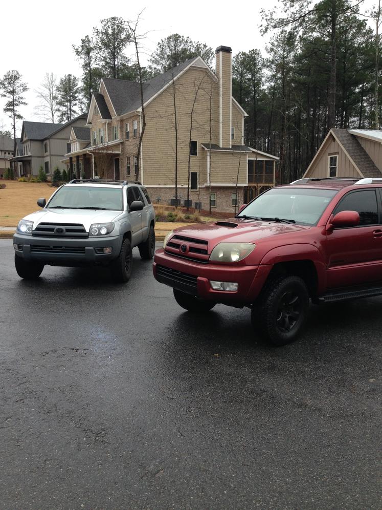

My twin!!
daystar leveling kit (2.5F, 1.5R), spidertrax wheel spacers, cooper adventurer at3 265/70/17 on stockers.

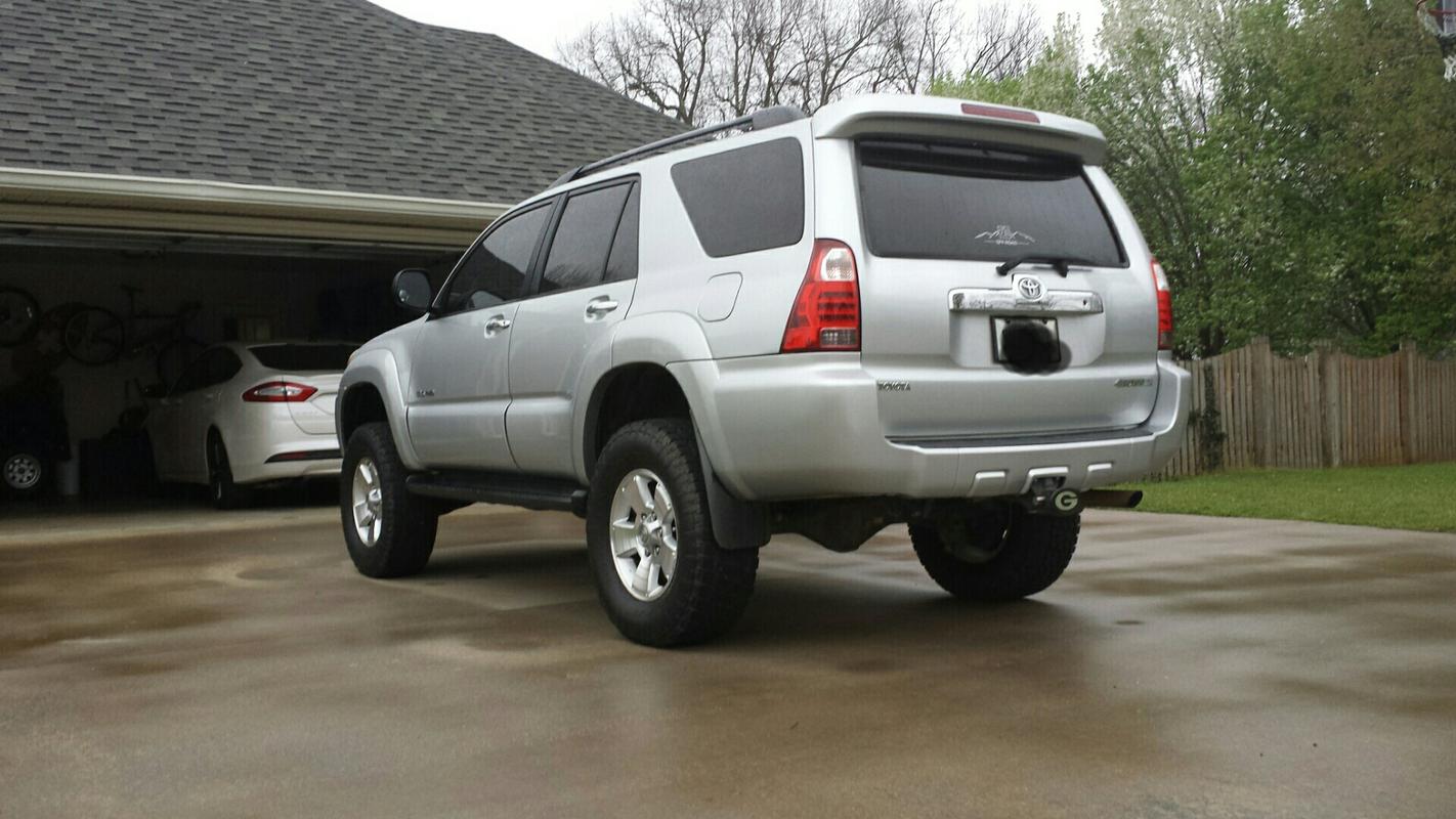

First contribution to the forum (been lurking for a while now). Had Daystars, Spidertraxx and a few small upgrades for a while but was never completely satisfied. I finally found the time and spare change to step it up a notch. Still got a ways to go, but I'm very pleased.....for now.
Added:
OME 885s with Top Spacer
OME 60020 Rear Shocks
ToyTec SuperFlex Rear Coils
1" ToyTec BL
Nitto Terra Grappler G2s 285/70/17
No rubbing after fender relocate and alignment

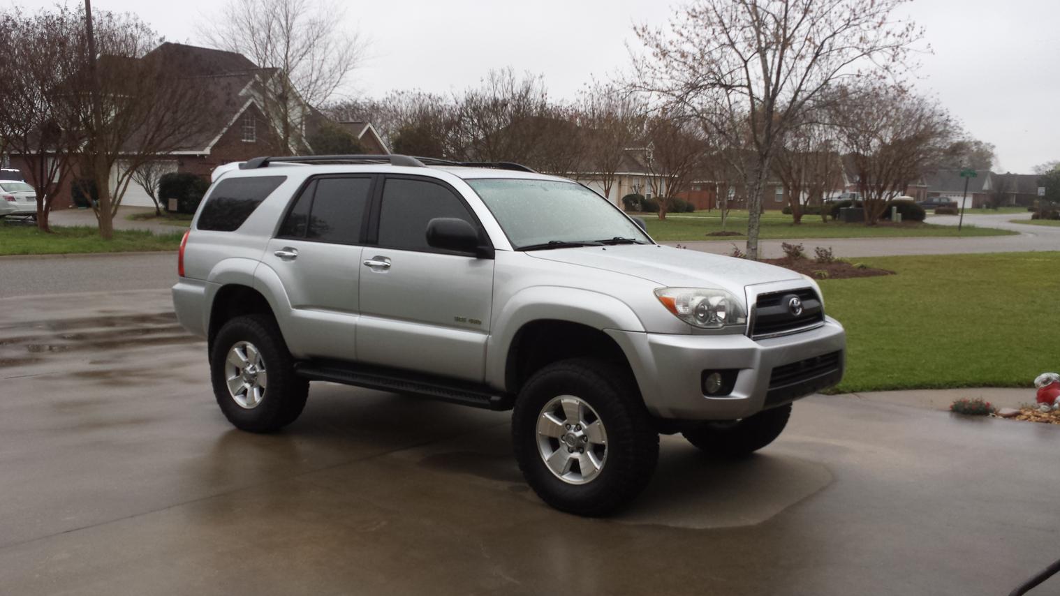

Leveled
Went with the Bilstein height adjustable shocks and brought the front up 2.5". Rides really smooth, 4Runner had 185K miles on the old shocks. I think I am done with the exterior for now though.

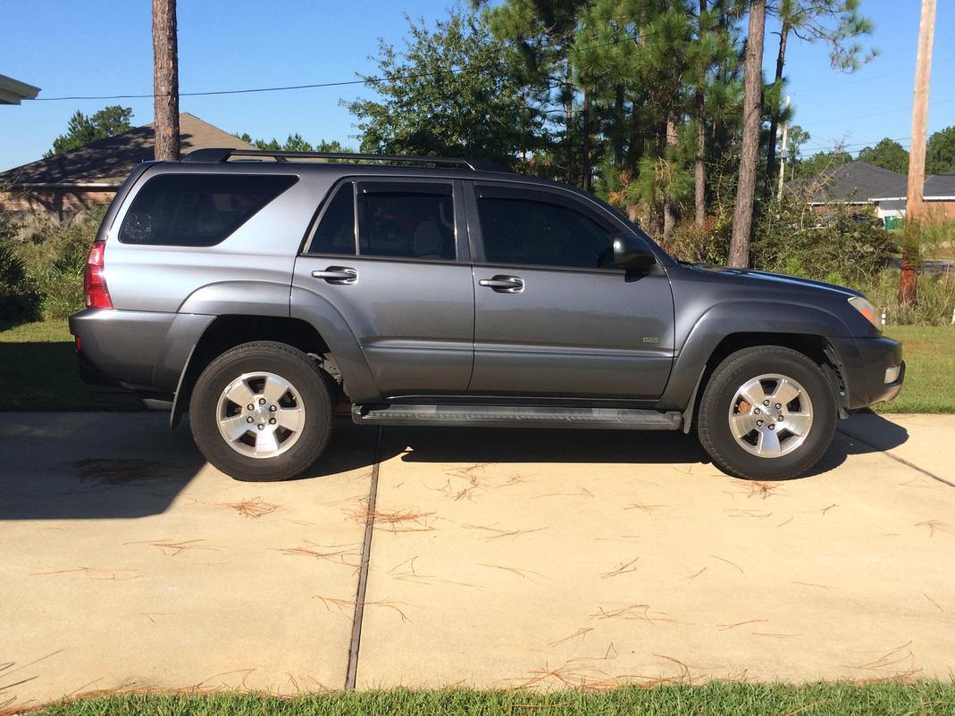

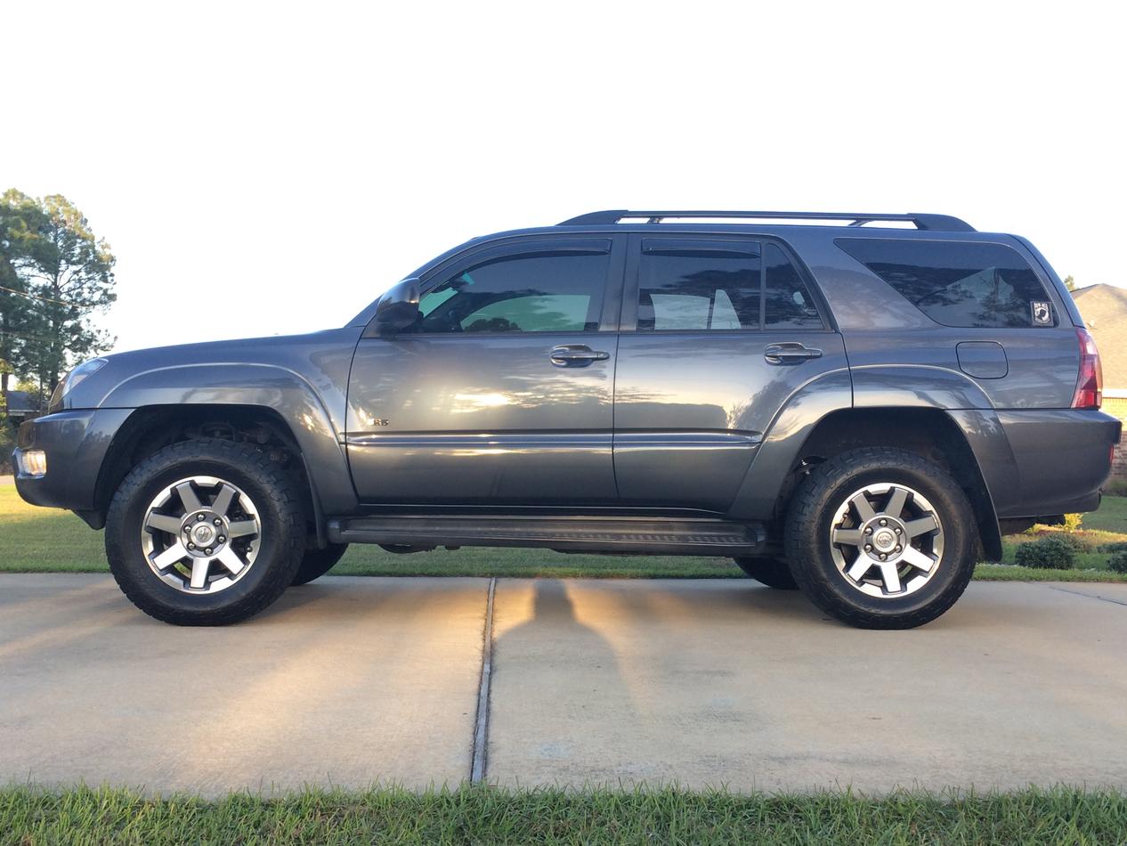

Bilstein 5100
Got the bilstein 5100s installed all around (front at .85) a few months back. Kept my stock springs for now, thinking of going with OME coils when its time to get a new set of tires. They ride great paired with the stock springs, and set at .85 the truck is just about level. Tires are 265/65 BFG Rugged Terrains.
