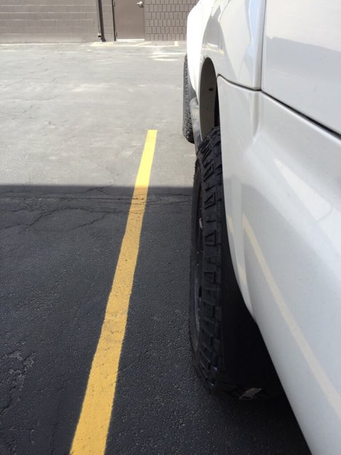

Nitto Terra Grappler G2
275/65/18

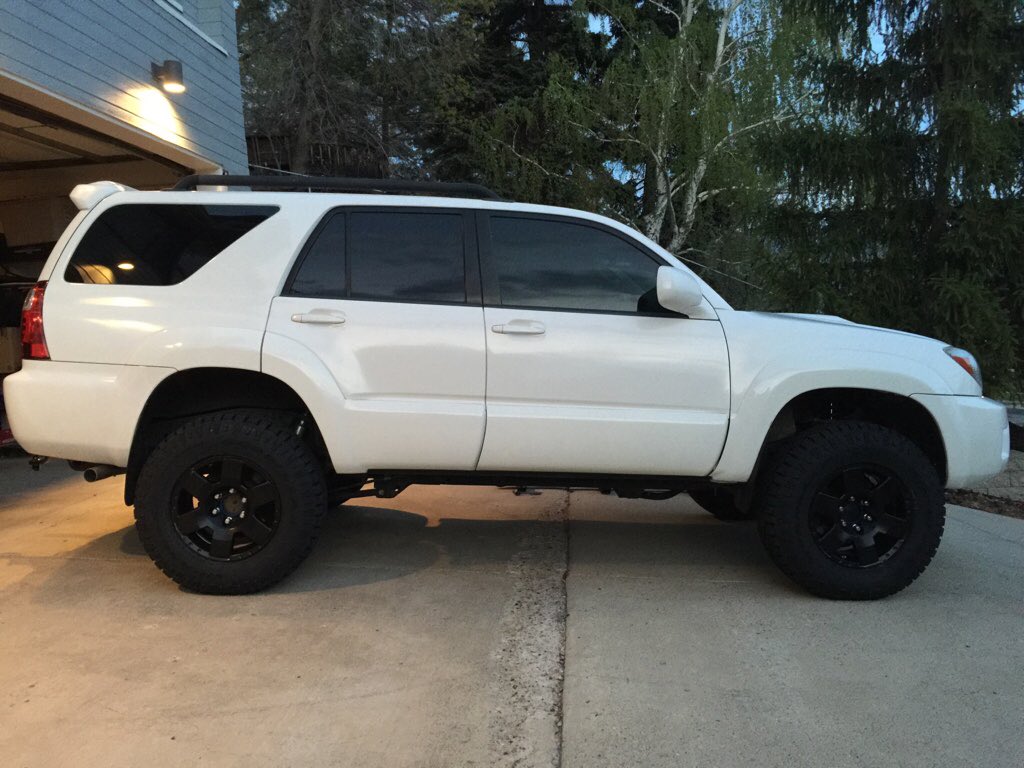

I installed my lift 2 weeks ago and I got my wheels and tires installed today. I had to go hit the trails to test them out.
Lift: Bilstein 5100 all around, Toytec 2.5" coils up front, Superflex rear coils
Tires: BFGoodrich AT KO2 275/70/17
Looks great! How much rubbing/where did you rub with the KO2s in that size?
And do you know if those new TRD wheels have the same offset and rim width as the FJ wheels?
I have only heard a slight rub when turning in reverse. I also haven't gotten an alignment yet, I plan on getting one this weekend. Then I'll do a full inspection on where it's rubbing and get back with you. I am not running wheel spacers either, I am sure it will help with that problem once I get some.

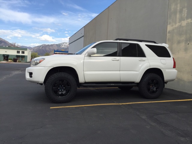

Figured I'd better start contributing...
Toytec 1" BL
Toytec CO - settled to around 2.5" (will crank up a little soon)
Metal Tech LT Stage 2 (w/modified Daystar rear spacers)
Goodyear Duratracs (275/70/18 - mounted with full vehicle weight sit right at 33" tall)
*Note - no wheel spacers, trimmed mud flaps/front wheel well/inner front bumper (not pictured), but setup causes slight rubbing on upper control arm at full lock, both directions.
**Note - running boards put back on as a deal with the wifey until I get proper sliders built/installed.
***Note - still fine tuning flex/articulation (e.g. sway bars/links) but that's probably better kept to a build thread. I'll start that soon.

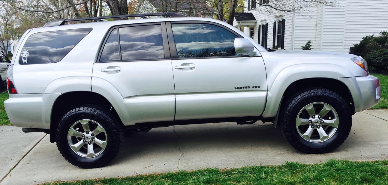

Got the bilstein 5100s installed all around (front at .85) a few months back. Kept my stock springs for now, thinking of going with OME coils when its time to get a new set of tires. They ride great paired with the stock springs, and set at .85 the truck is just about level. Tires are 265/65 BFG Rugged Terrains.
Nice wheels!

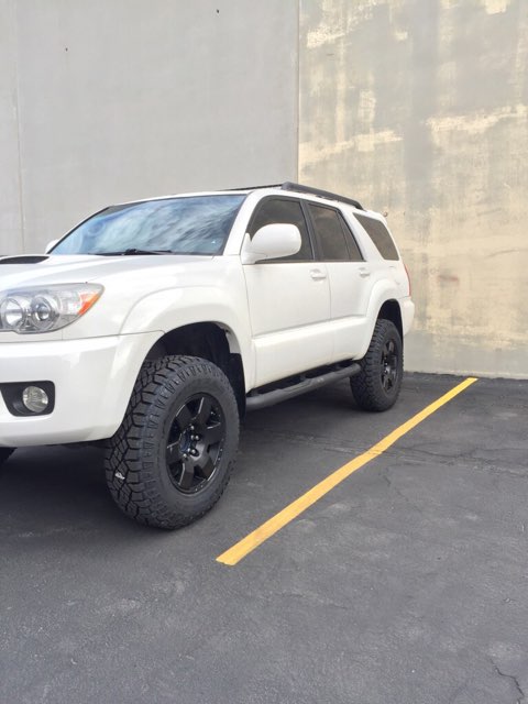

Just got my duratrac 255/75r17's mounted onto my powder coated FJ wheels. I am EXTREMELY happy about how it turned out. I didn't want to spend a ton on tires and I didn't want my gas mileage to drop by a ton. The duratracs fill the wheel wells without sacrificing too much gas mileage or the wallet. Since the FJ wheels stick out more I still get some poke beyond the fenders. Went from mom-mobile to badass today ha.
Still waiting on the TRD center caps

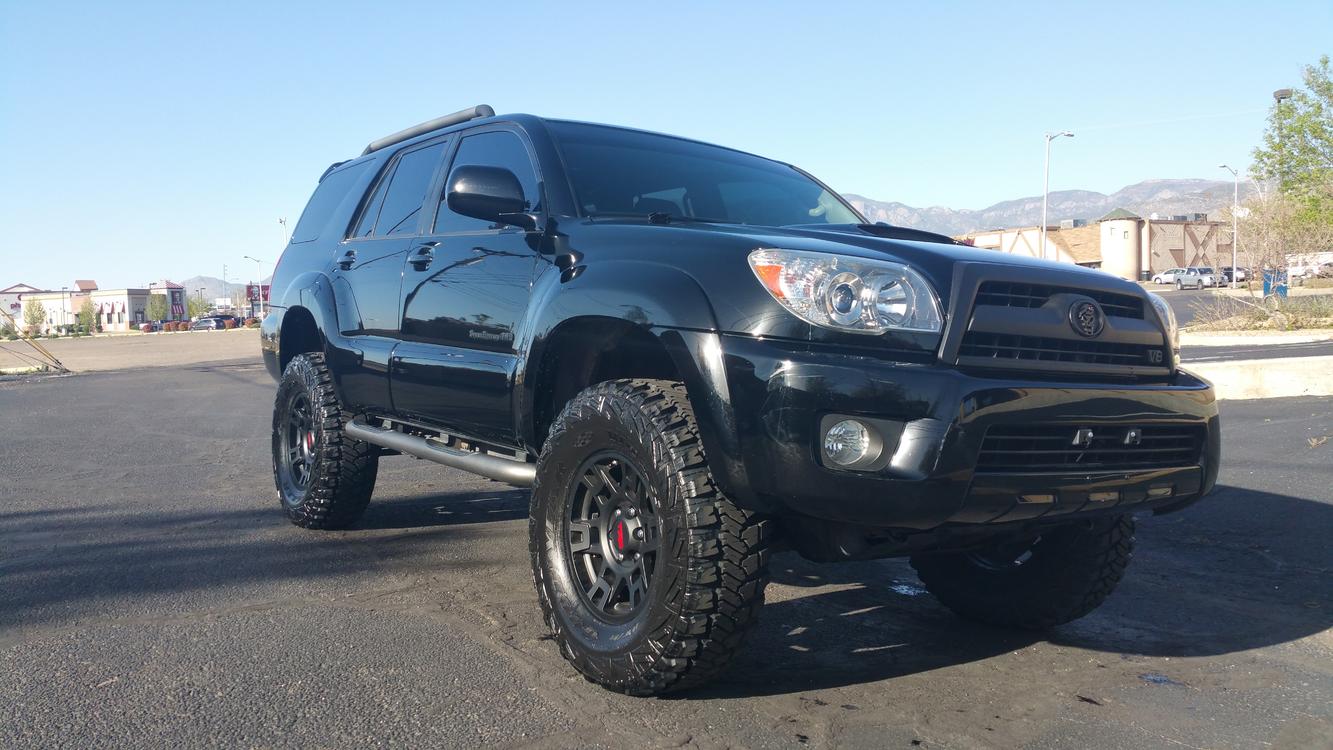

Goodyear MTR 305/70/17. TRD Pro rims. Afe intake. Boss 3 inch lift. Toytec 1 inch body lift. LR UCA's. Body mount chop. Black Ops Custom emblem replaces the stock Toyota Emblem. Plasti dipped grill and badges all the way around
