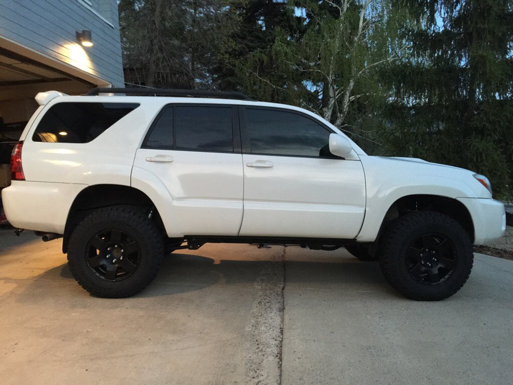

Yeah, yours looks good. The only reason I ask is because I got about 4" in the front with my 885's set on the 0 setting. The 884's are a bit softer but provide close to the same lift. I couldn't imagine my 885's on the 1.75 setting. Do you know how much lift you got from the lift in the front?
I'm kicking myself because I didn't measure before the lift but I can get the measurement for the front now if you'd like to know. Also, I did add spidertrax spacers and on have some rubbing on the drivers side during hard right turns.

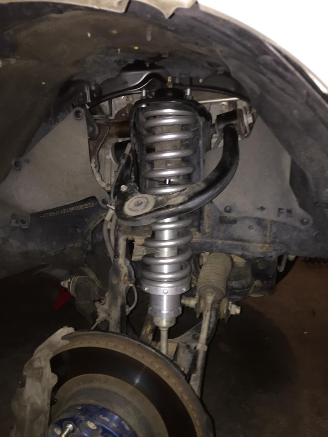

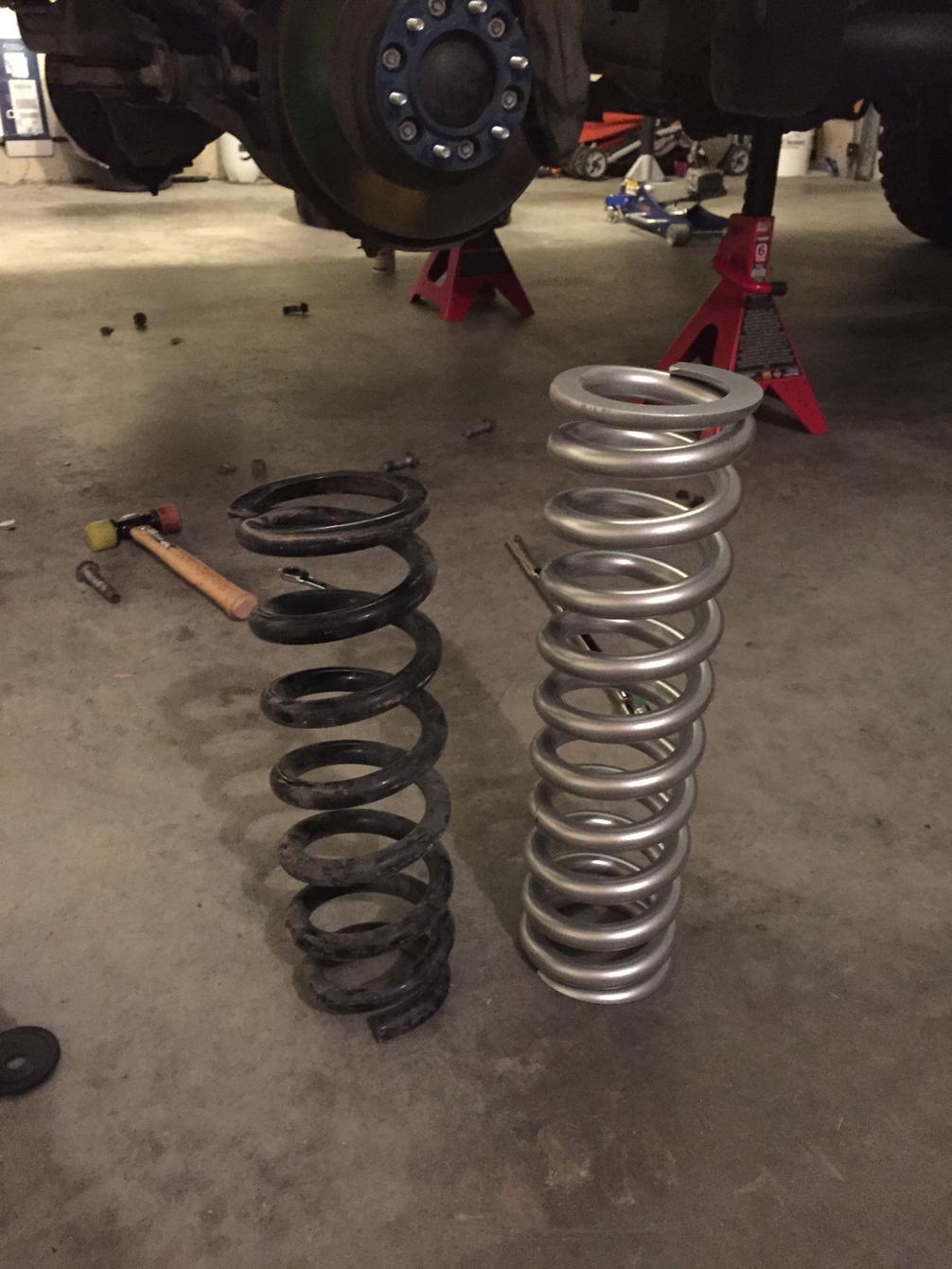

Installed toytec coilovers in front today. with 5100's rides fantastic. still running stock rears with 1.5 spacer. measure to fender is 37 front and 38 rear. Needed coilovers to offset weight of second battery and winch (yes, its there if you look close enough. lol) Very happy with it!

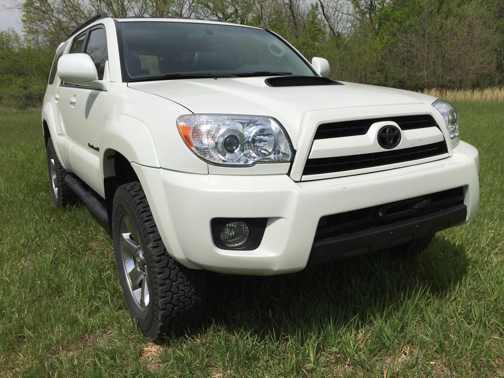

16x8 stealth custom series limted edition f5's wrapped in 285/75/16 Bf goodrich ko2's. Daystar front spacer lift. Rubs like crazy. Hope to remedy that issue tomorrow.

Alberta4runner, she is a thing of beauty. I really like the white on silver, never knew how good that would look! PS did you order your front bumper from demello direct? Any issues in shipping?
Thanks Theo! I love the white on silver, i've always had a thing for white rims so when I seen these I had to have them! Yes I dealt directly with Demello themselves. Took about 6 weeks maybe 7 with delivery. Shipping to alberta was around 500 I believe. Hope that helps!

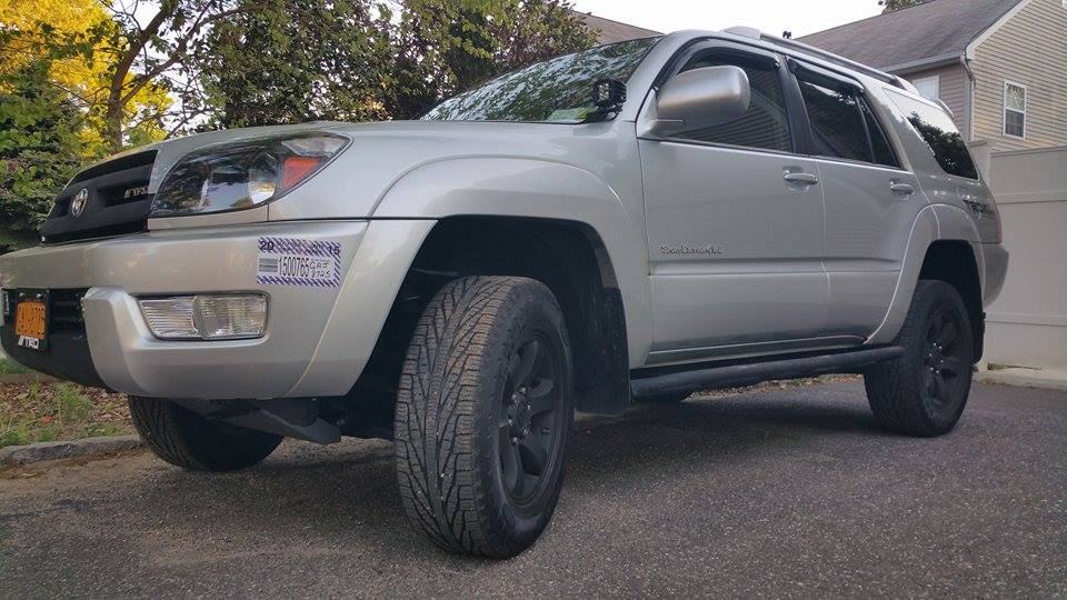

Heres my 04. three inch toytec ultimate, light racing UCA's. 285/70/17 duratracs, stealth 6 wheels.

Thinking about getting the same setup. Did you have any rubbing issues? What is the offset of the wheels?
I had minor rubbing issues which the body lift seemed to pretty much eliminate. I had to chop small amounts off the bumpers and fenders but nothing significant. The offset is -12 with a backspacing of roughly 4.5. I personally love the set up and it has worked out great so far.

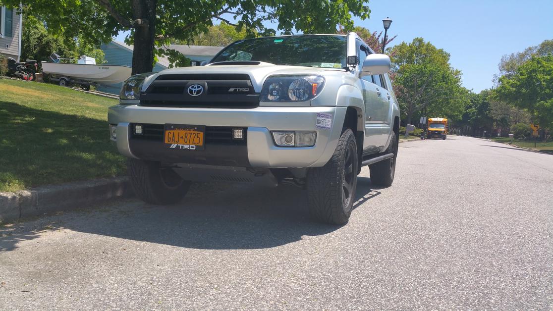

Been awhile since I posted here! Bilstein 5100's on 0.85 + Toytec 1/2" (1" net) in the front. I think it was a Cornfed 1" spacer in the rear.
(**So, in summary it's a 2/1 lift overall currently)
Toyo Open Country AT2's (P265-70-17) wrapped around American Racing ATX Crawl 17" Wheels.
I wanna go up another inch on the Bilsteins (front) and throw the FJ rears I bought on top of the 1" spacer in the back in the very near future. Also want some Duratracs this year!
Reason for the pics are because I removed the 12 bolts that were holding the stupid running boards on. Really like the look from removing them:
