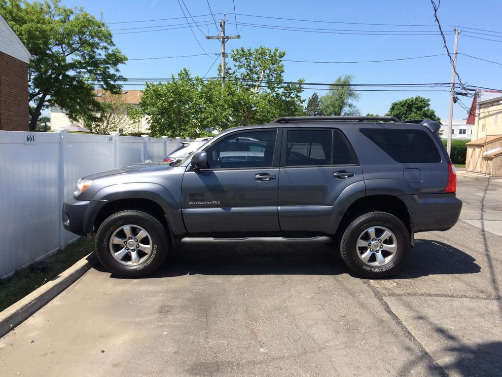

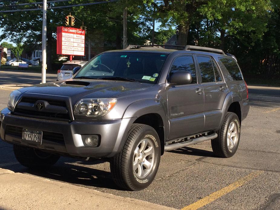

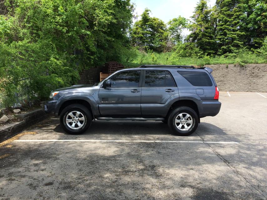

OK, first substantial mod to my new-to-me T4R.
Front: OME 884 / 90021 *
Rear: OME 895E / 60004
* 90021's are a new OME spec for our trucks and are supposed to have a more compliant ride than the 90000's

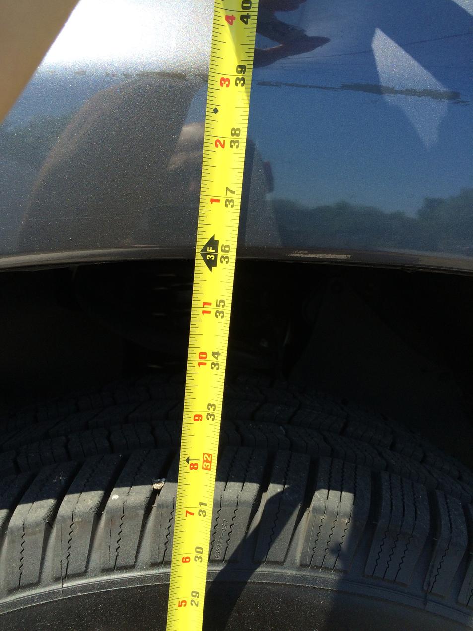

Pre/Post Height (inches) from level ground to bottom of fender at vertical center line of wheel. Day 1, no settling.
Driver front - 32.75 / 36.25 (+3.5")
Pass front - 33 / 36.5 (+3.5")
Driver rear - 35.25 / 37.5 (+2.25")
Pass rear - 35.25 / 37.5 (+2.25")
Stock suspension had 118K and man, this OME setup feels so much better. Granted, the stock setup was just flat out used-up, but the new ride is, in a word, reassuring. Also added Spidertrax and new CV axles as the stocks had leaky boots. On to pictures. I drove across the street to the Toyota dealer and parked next to a new 5th gen SR5 for before/after comparisons. My little 4th gen is a big boy now. :biggrin2:

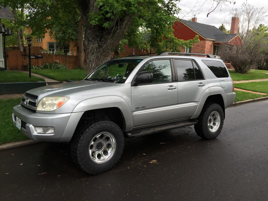

Lifted my 2005 this week. I gave her a 2" OME lift and American Eagle Ion Classics. They sent the wrong caps so I don't have those on yet. I kinda like it like that though, what do you guys think?
I'll have to replace the control arms to get rid of the slight drift it has. Next up: new headlights!
