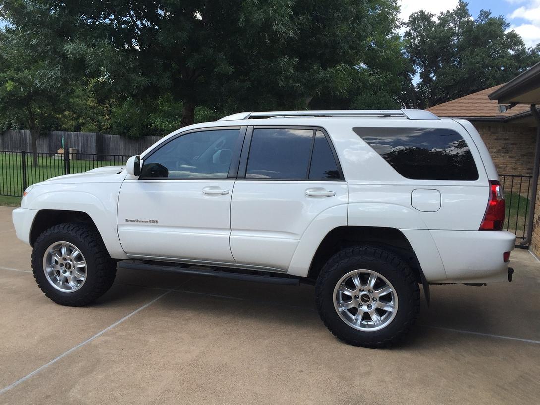

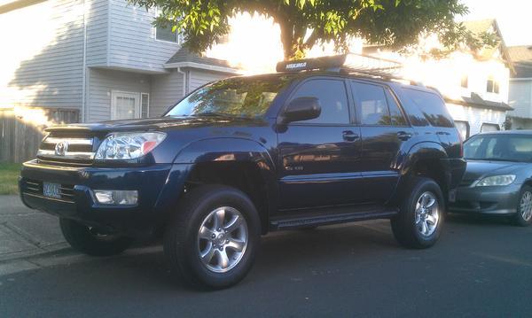

Hey guys... I'm sitting on FJ springs all around with Bilstein 5100s, fronts set at 0.85". Looking to put some SCS SR8 17x8.5 -10mm offset wheels on some 265/70/17 tires. Anyone know if I'll have any rubbing issues on this setup??
Fresh install. Bilstein 5100's all four corners. OME884 front. OME895E rear. I need to extend the swaybar endlinks in the rear asap. The ride quality is amazing. At 74K miles, stock springs were slack and all shocks were blown.
Next upgrade will be some SCS Stealths and KO2's. Can't wait.

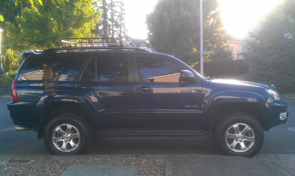

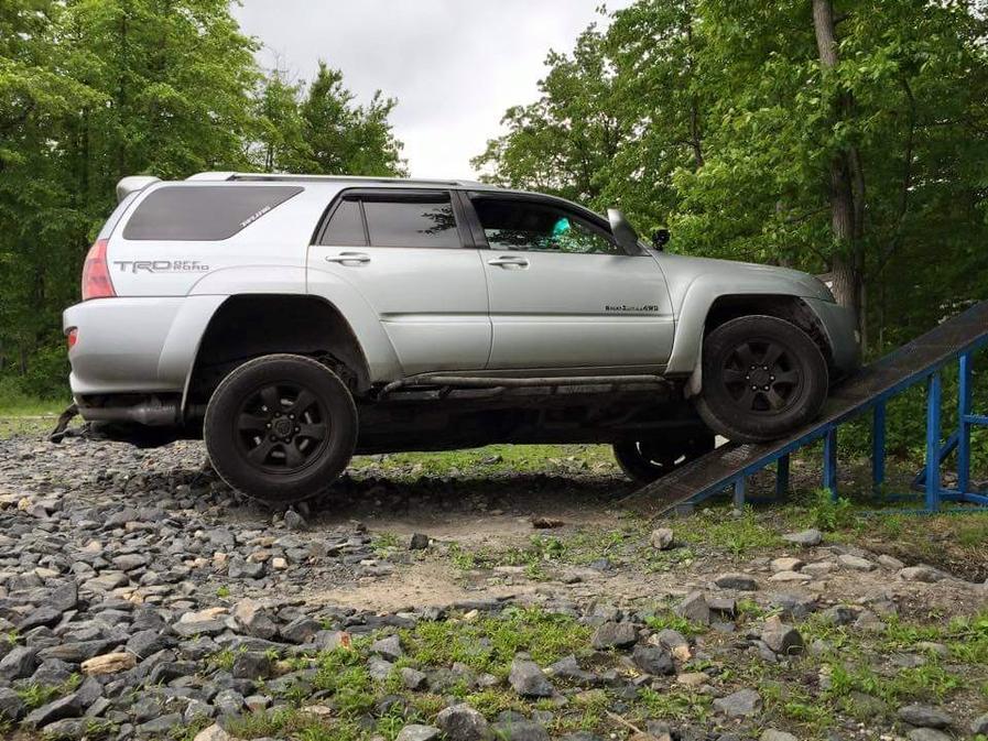

I switched from Michelin LTX AT2 tires yesterday. I am now rocking BFG AT KO2. The Michelins were great, but I wanted the sidewall protection that is on the KO2s.
My old tires and new tires are both LT275-65/18. I had a 285-65/18 test fitted in the KO2 and it rubbed the frame rails.

I am very, very, very..... VERY jealouse of your wheels...

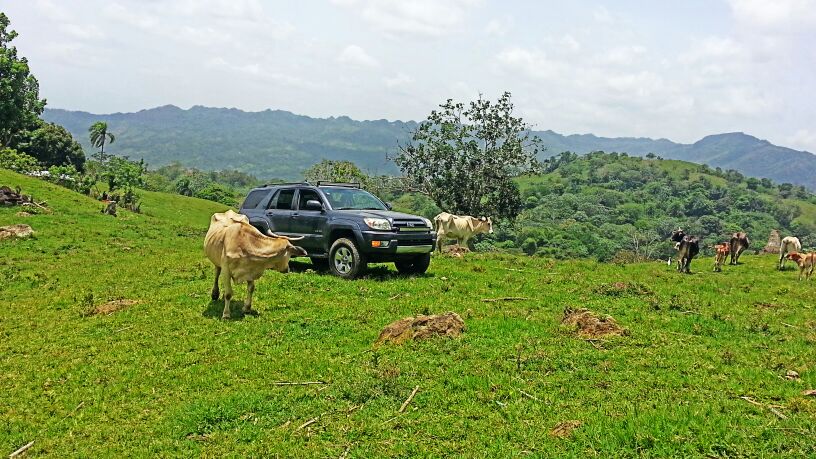

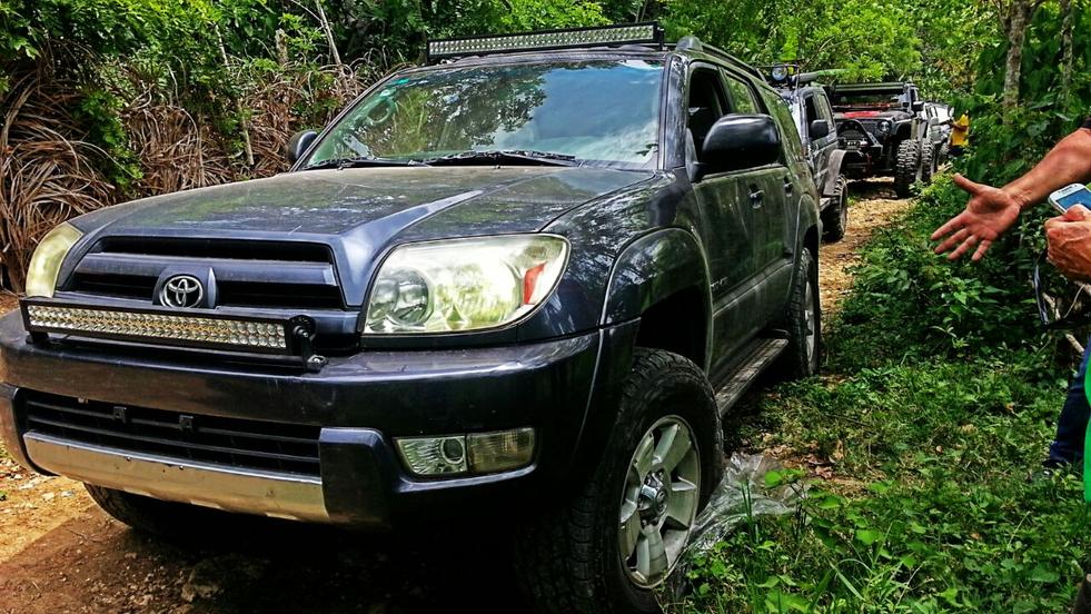

My Gray Baby
2004 sr5 4.0
275/70r17 tires.
3" front and back lift.
1.5" wheel spacers.
Rancho regular size shocks absorbers...and i love it !!!

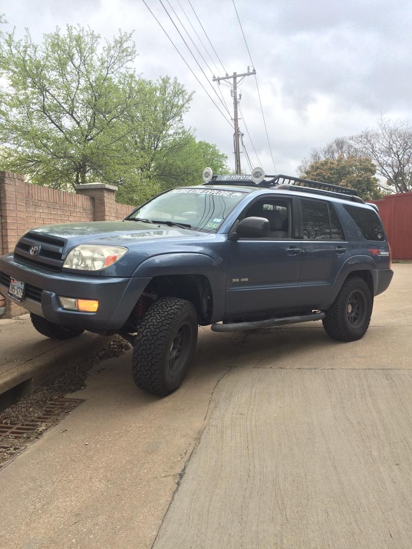

i feel like i need a BL to help clear my 285/75's :drama:
trimmed the fender and some of the inner plastic, push the liner forward, now thinking about chopping the mounts once i get my hands on a welder

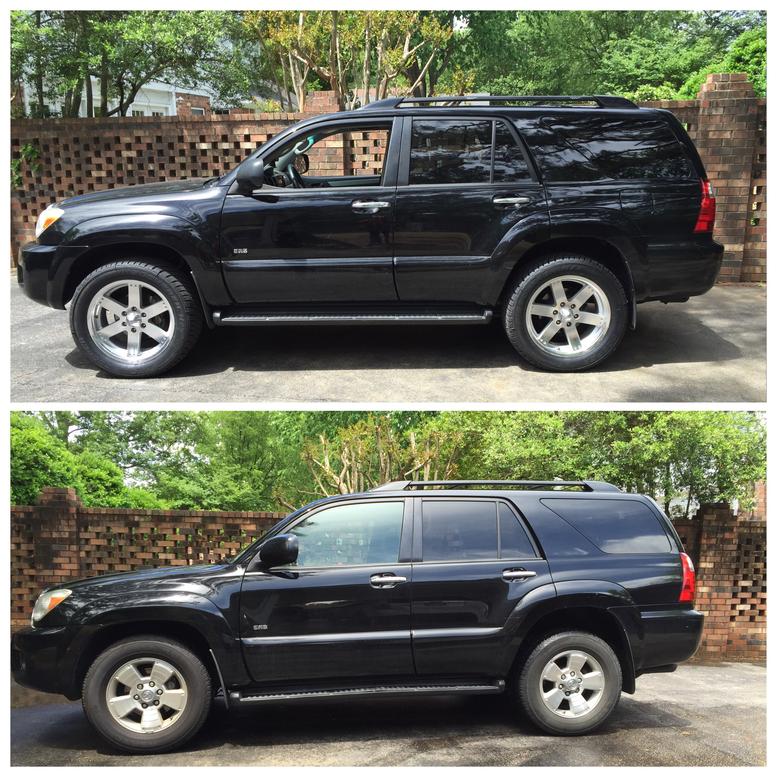

2007 4Runner SR5 2WD. I was trying to create a subtle higher end look appropriate for a base model 2wd that spends it life on road. Being on a limited budget I chose a set of used 20" eneki rims from a x-sp 4Runner, 285/50/20 Cooper Discover H/T tires. I replaced all of the worn factory shocks with KYB shocks. Daystar 1" spacer lift up front. I was really worried about rubbing and had a lot of people tell me it wouldn't fit with out trimming or more of a lift. With this setup and no fender well mods the front tire only bushes against the plastic wheel liner at full lock in reverse. Nothing major and is a very simple fix. What do yall think? Before and after....
