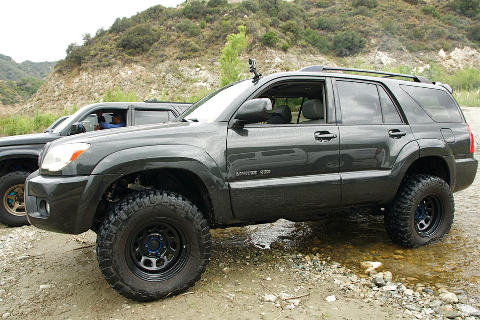

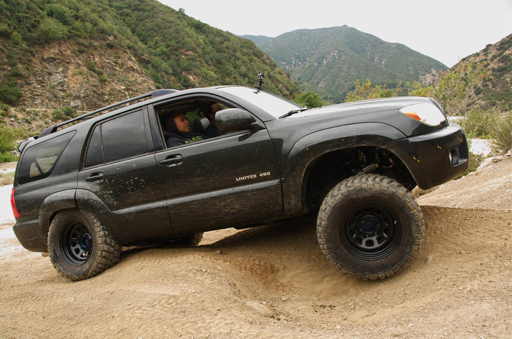

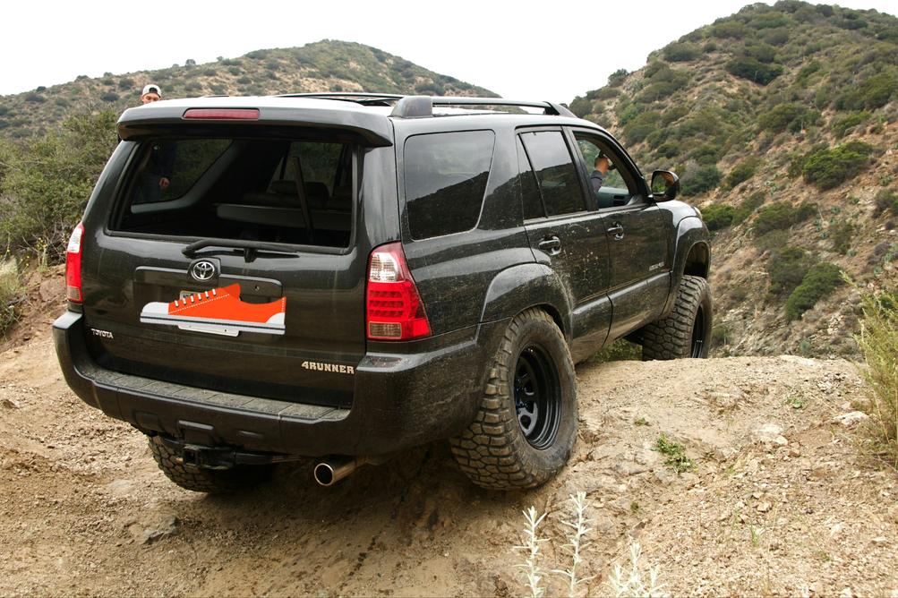

1. Icon Vehicle Dynamic front: billet UCAs, 3" coilover w reservoir & rear: 2" coils & shocks
2. BFG KM2s 305/65r17 x 9 Cragar steelies -19 offset w 1.25" spacers
3. Love the set-up but wish I went with 3" rear coils (soon!). I only have the front cranked to 2" to give it a slight rake when the cargo is full.

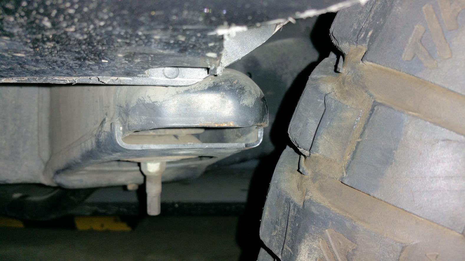

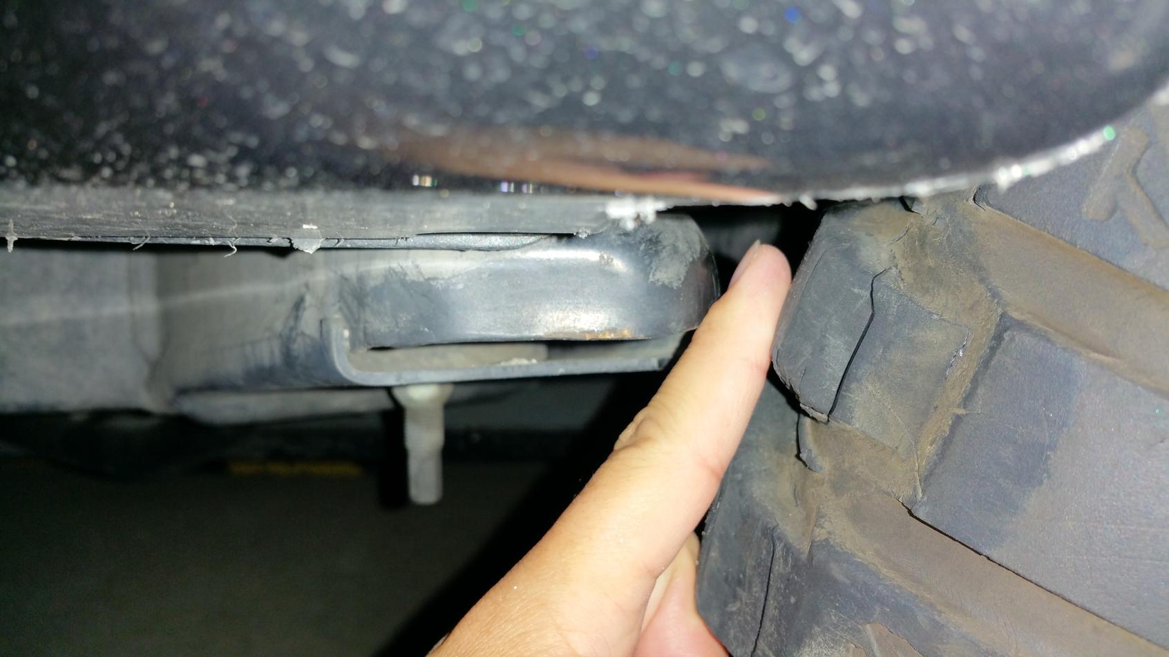

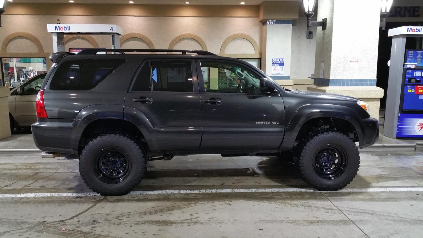

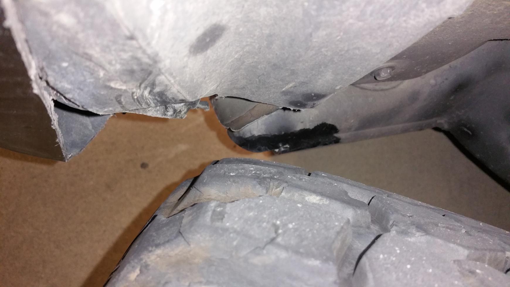

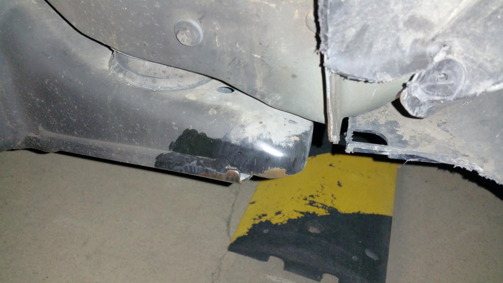

roro: Do those meats rub the body mount? Any pics of it on level ground?
Thanks!
I daily my rig with some wkend wheelin and it only rubs the cab mount when I'm at full crank and I back up quick or full crank over rough terrain going forward. I'll be raising my rig an inch all around and a cab mount chop is def on the list. Here are some pics
