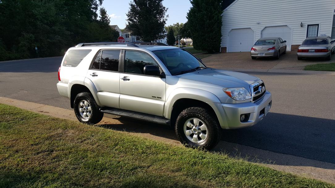

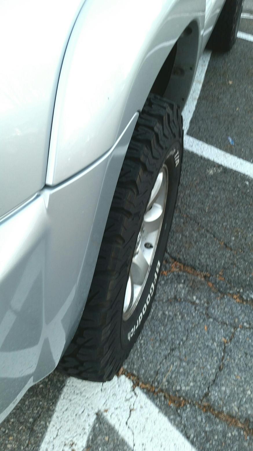

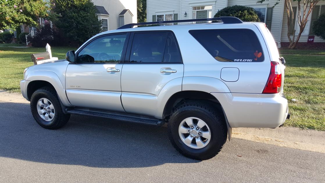

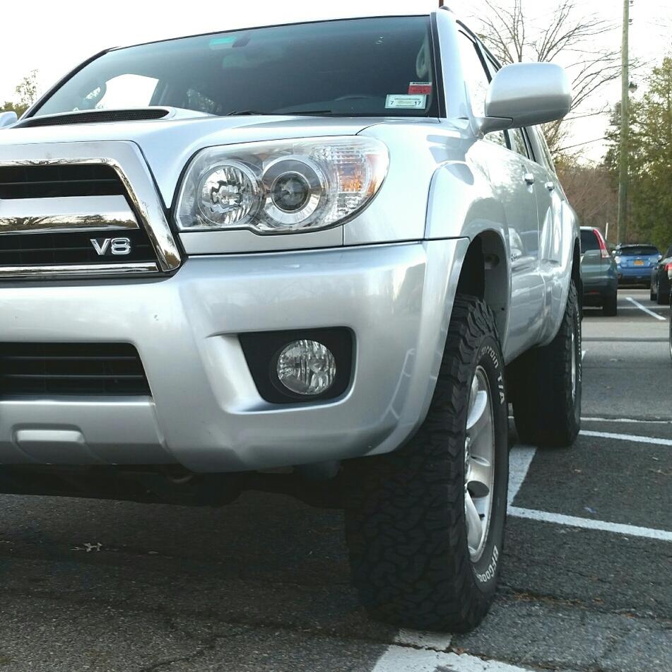

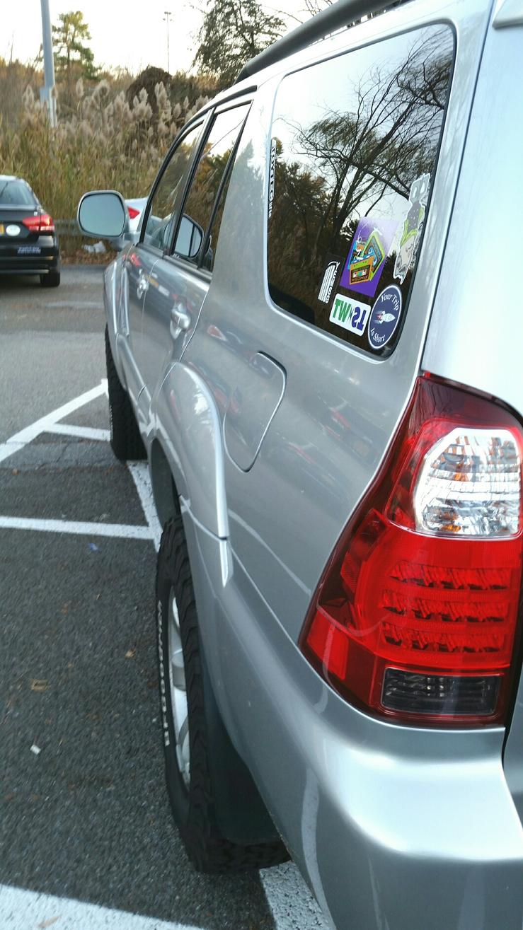

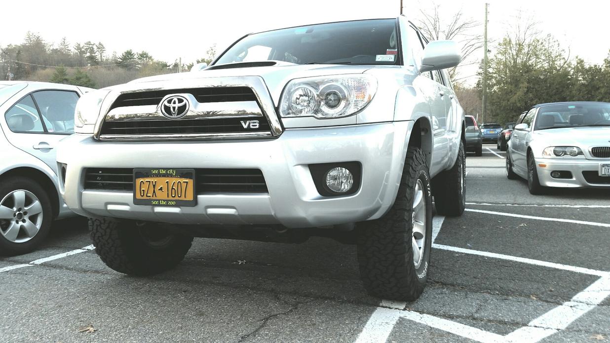

Finally installed Spidertax 1.25in wheel spacers at all four corners. The 275/70r17 BFG All Terrain KO2 tires rubbed a little bit on the front inner fender liner prior to install. The spacers have increased rubbing significantly. Seems like it can be fixed by pushing the fender liner forward. I believe drilling new holes and using the existing screws to secure the liner is the way to go. If you have done this or something similar, I would appreciate photos and/or suggestions on how to proceed.

The wheel spacers increase rubbing on the front inner fender liner because they are pushing the tire out of the wheel well. The rubbing occurs while turning the wheels. Before the spacers, it only rubbed in reverse up hills at full crank. Now it rubs forward & reverse with only moderate turns of the wheel.

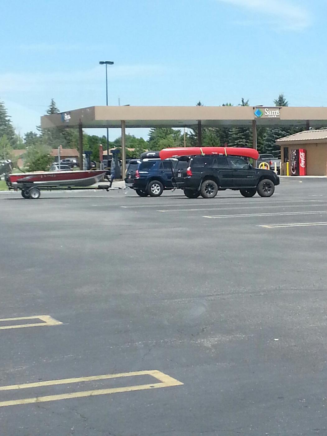

Parked by the stock T4R I always see when I drop my daughter off at school. Obviously not a ton of difference in height with the Daystar kit, but certainly noticeable next to stock.
Front: Bilstein 5100 w/ OME 885 Spring
Rear: Bilstein 5100 w/ Toytec Superflex Springs
Tires: 265/70 General Grabber AT2
Looks great! Nicely done. How do you like the Superflex rear coils? I considered them but I liked the full OME setup on my 3rd Gen very much. So I got the 895 Medium Coil for my 4th Gen.
How long have you been running that setup?
