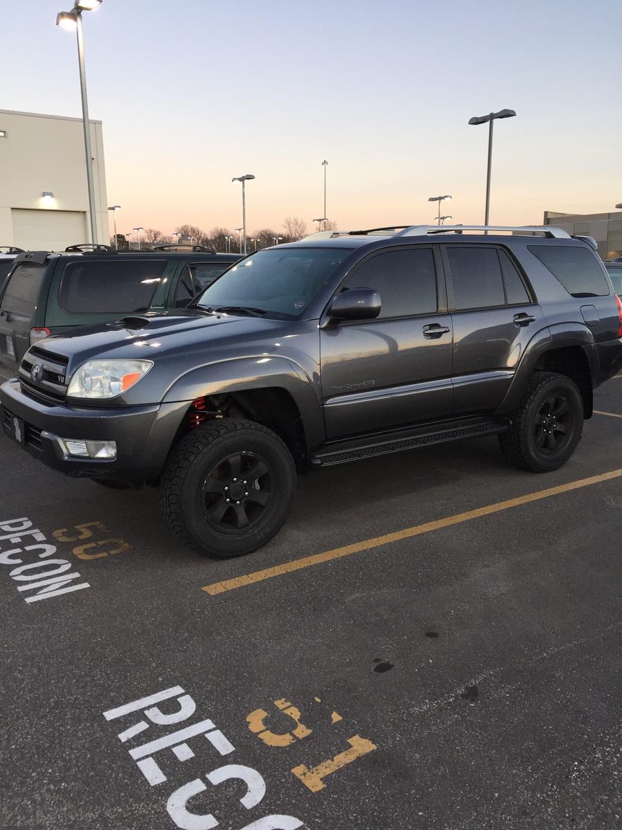

finally lifted!
so I sprung for the Toytec boss lift back in like October. a gizzillion things going on since then,but I got her done last tues. this is the only pic I have yet at the alignment shop lol!

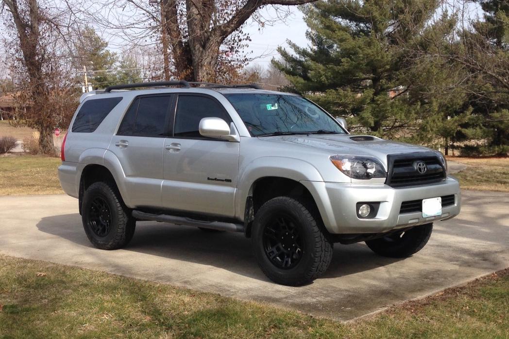

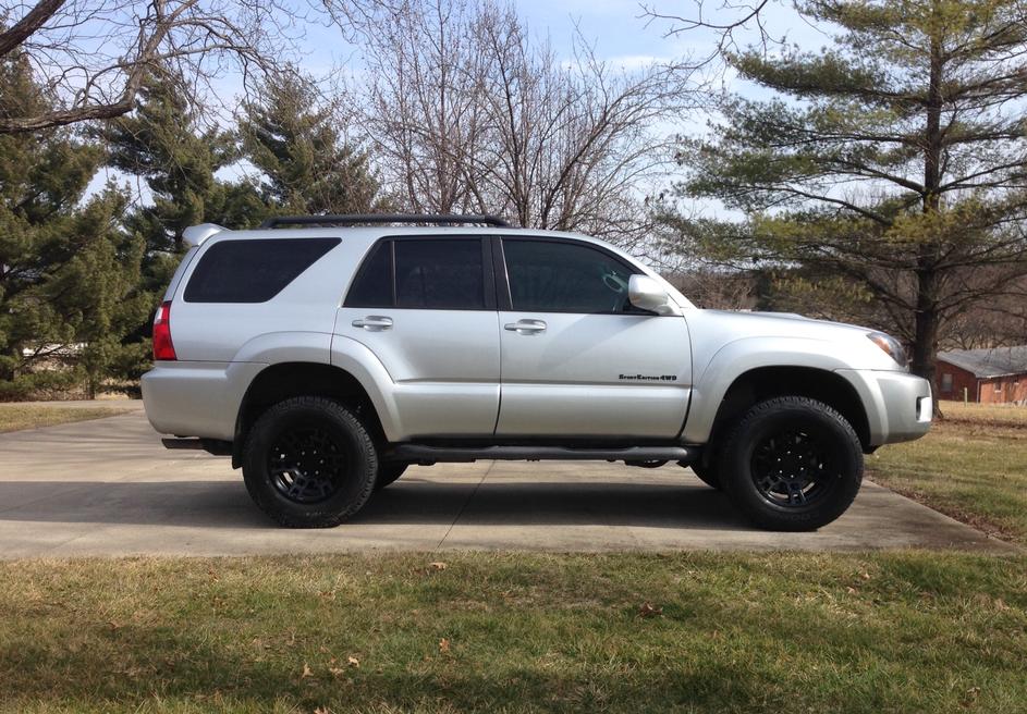

Had a busy day at the shop! FJs and Bilsteins all around, fronts set to 1.75, rear spacers cut at 1 inch on driver side and 3/4 inches on passenger. Cooper AT3s, 265/70/17 on Fx Pro wheels. Very pleased with the results.

I like it, looks good. Are those FX pro rims the same as the TRD PRO rims???
Sorry in advance i am uneducated when it comes to rims.
Thanks. The fx pros are from Fn wheels and are made to look very similar to the oem trds, but the trds are 7" wide with a positive offset and the fx pros are 8" with zero offset.
That is interesting... i had heard about the 7" width with the TRD and a lot of folks were puzzled by it.
At any rate. Your rig looks good.

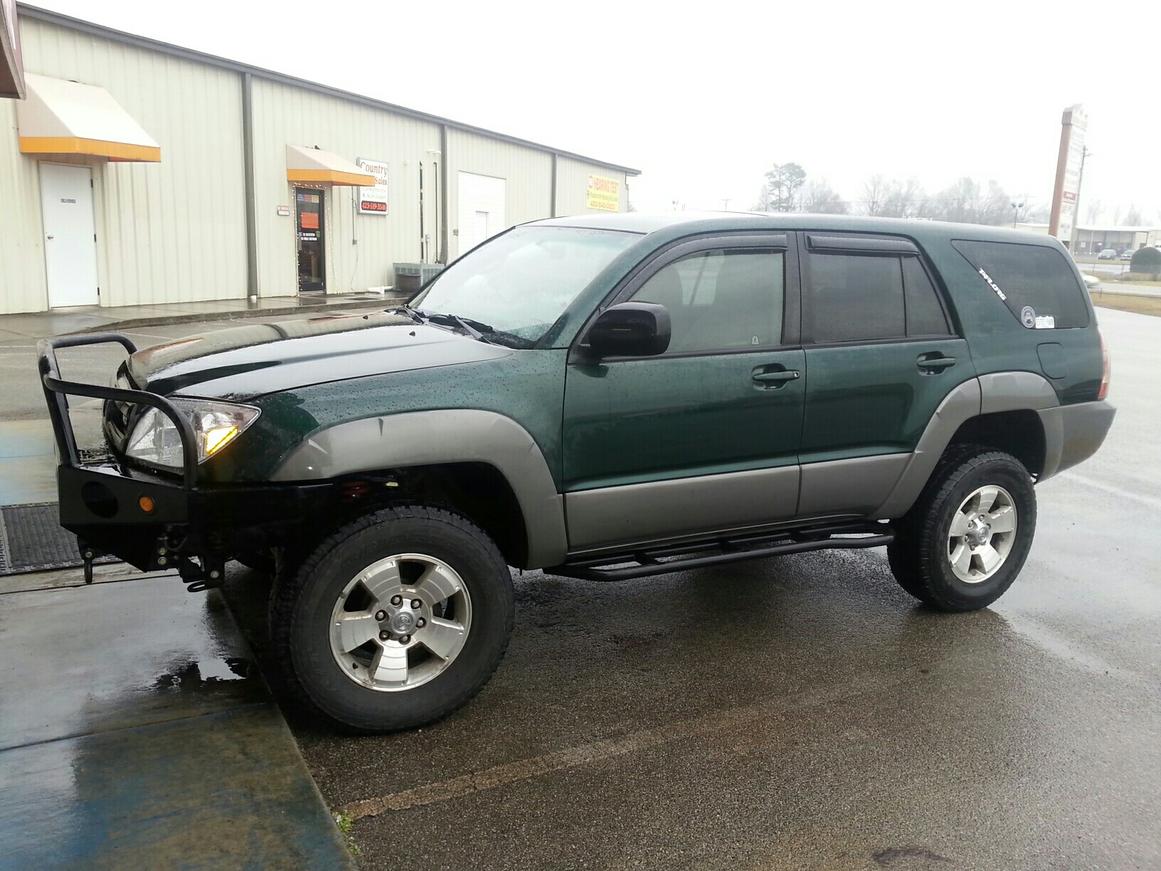

Front: Icon Remote Resi CDC, 700lb Coils
Rear: Icon 2.5 Remote Resi, FJ Springs
Stock sized tires
Expensive "Leveling" kit, but a lot more planned
IMG_20160220_145059_241_zpsgfnpm7xo.jpg~original
Blacked out trim
