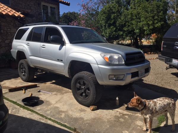

Ever since the 4Runner was handed down to me (8 years ago) I've been wanting to install this lift! 3" Toytec Boss Lift. Light Racing UCA's. Crown Performance Extended Rear Brake Lines. New CVs. Should get many more miles out of the rig! Now just need to fill those wheel wells up with some 285s and get an alignment!

That looks like a lot more than three inches of lift. I'm at about 3. With 295/70/17.

Came out to 4.5" higher all around (center of hub to fender) right after install. Not sure how as toytec ships front coilovers at 2.5" lift and rear springs at 2" lift. Should adjust/sag in due time.

It ain't gonna adjust/sag that damn much. That's a huge b!tch.
EDIT: Is it on jack stands in that pic?

I had to crank my front coilovers way down to end up at about 3" of lift... the adjustment collars are just about bottomed out. It seems like the adjustment range would be 2.75" to about 11" of lift! :confused:

Haha definitely right that it won't go down 1.5"
And nope, not on jack stands.
Once I get new tires and wheels, I'll definitely have to adjust. Thanks for your input!

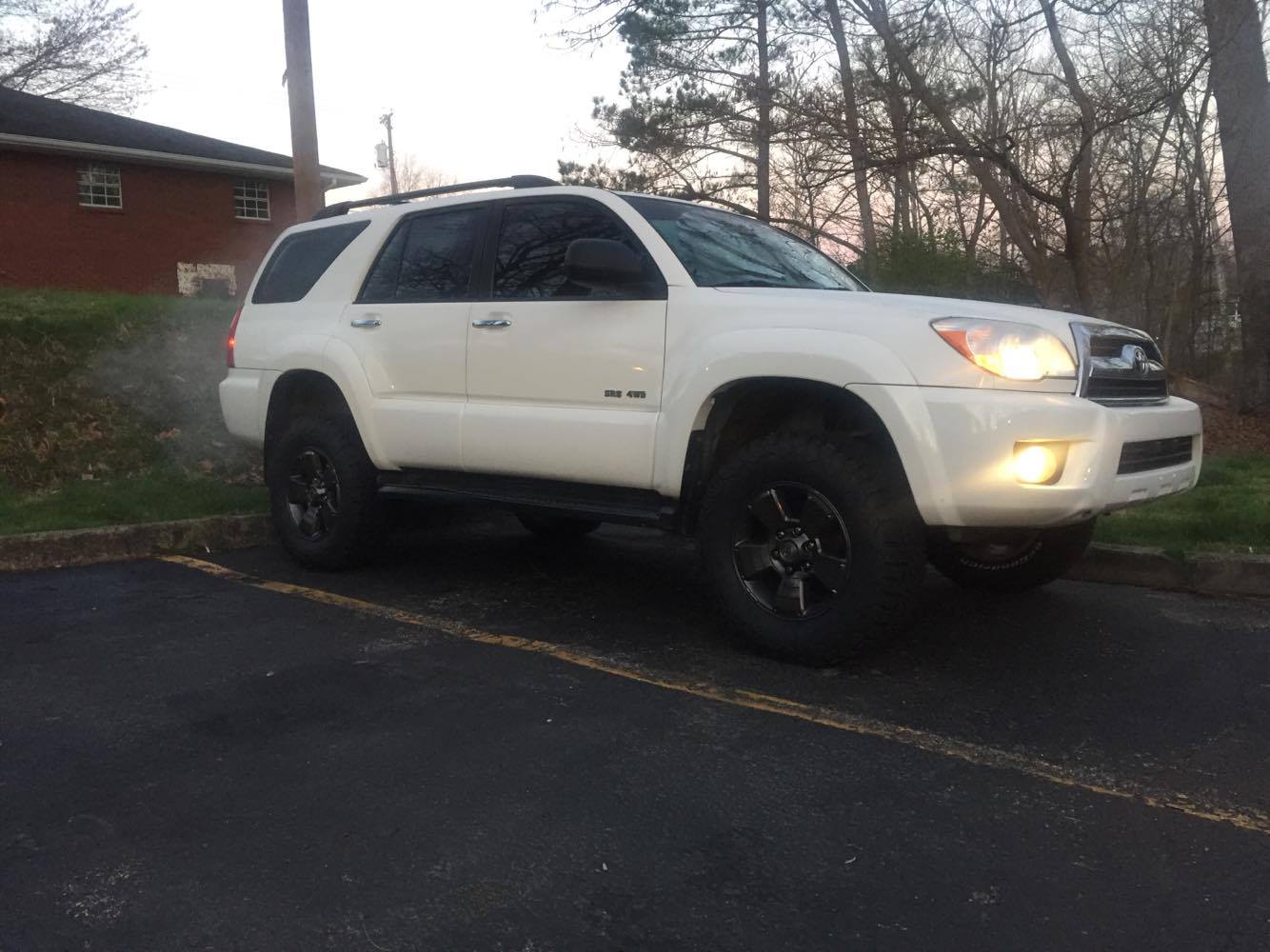

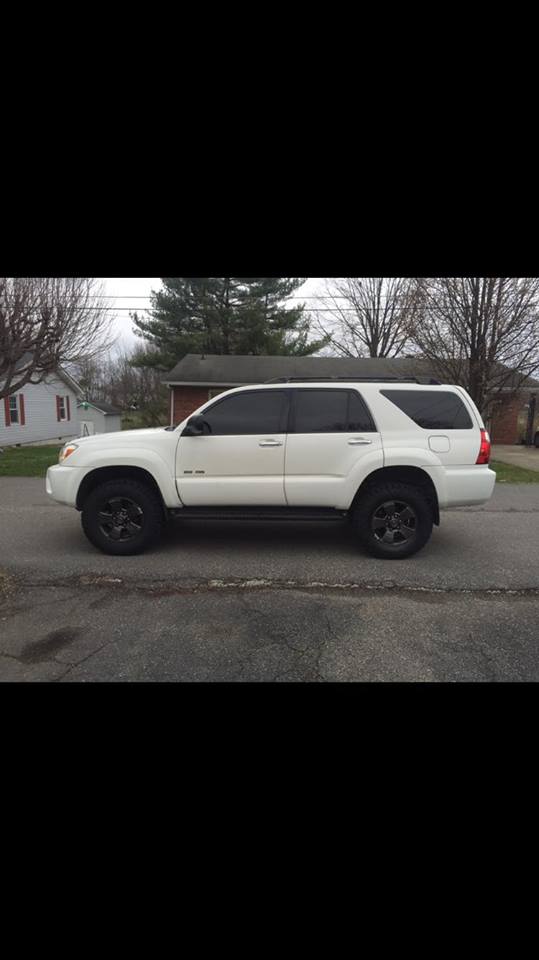

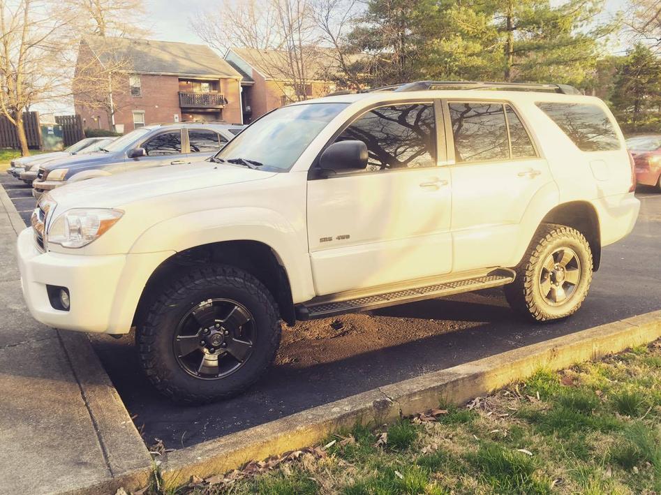

my 07 4runner have had it for about a month started with daystar 2.5/1.5 and fj springs, bought another set of 17" factory wheels with spidertrax spacers and 265/70r17 bfg KO2's hoping to do more in the near future. View attachment 197294
Not sure if you're keeping them on because you need them, but you should take the running boards off! Really simple, only takes maybe 10 minutes, and makes it look a TON better!

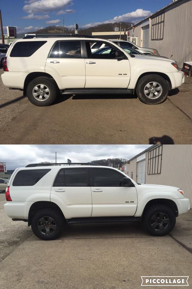

Just put on new wheels:
Bilstein 5100s at 1.75"
FJ springs, Daystar 1.5" spacer in rear.
Konig Six Shooter 17x9, 0 offset
265/70r17 Hankook Dynapro ATM
Before with stock wheels, same tires & suspension:
The wider wheels with 0 offset really push the tires out, I didn't measure or do the math but seems like 1.5-2" pushed outward.
