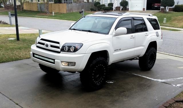

3" front 2" rear Toytec Suspension Lift w/ Bilstein Coilovers
285/70r17 Mastercraft Courser MXT
Love the way it looks!! Wish I could get a little more lift though to fix rubbing issues.

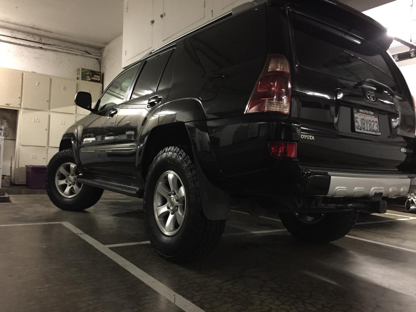

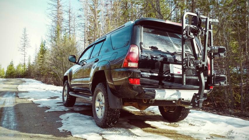

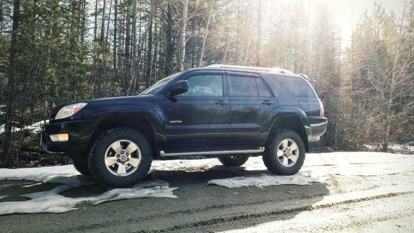

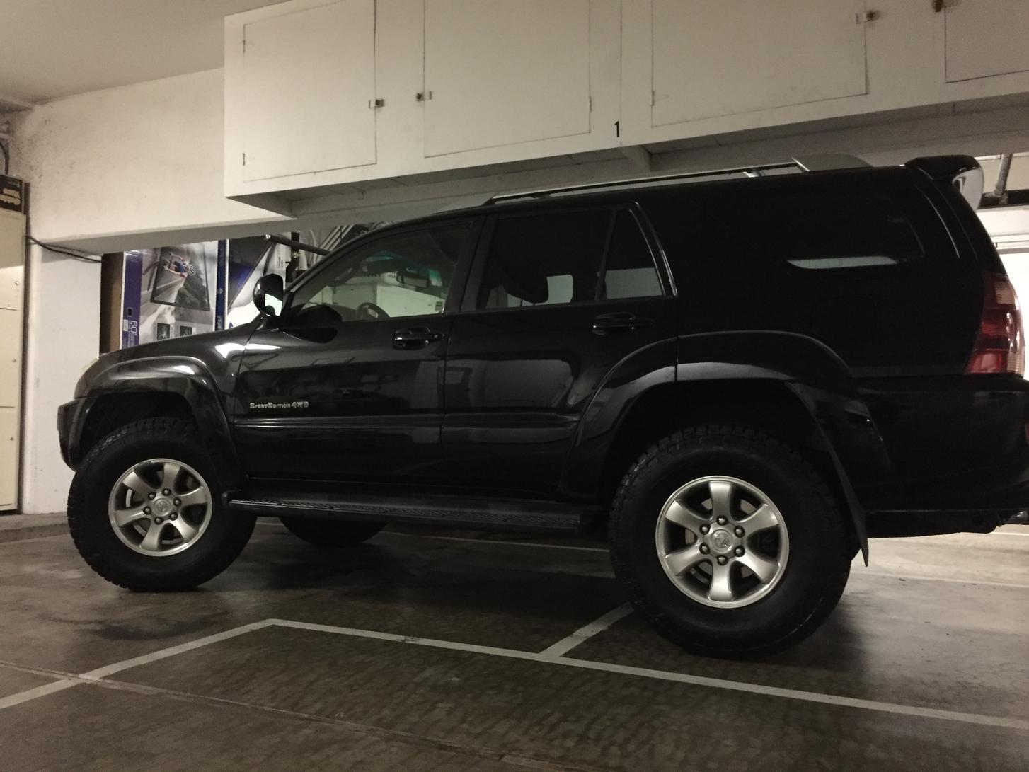

Here's my 2003 Limited V8 with 5100's set at 1.75", stock springs, RAS adjusted up, and BFG KO2 265/70R17

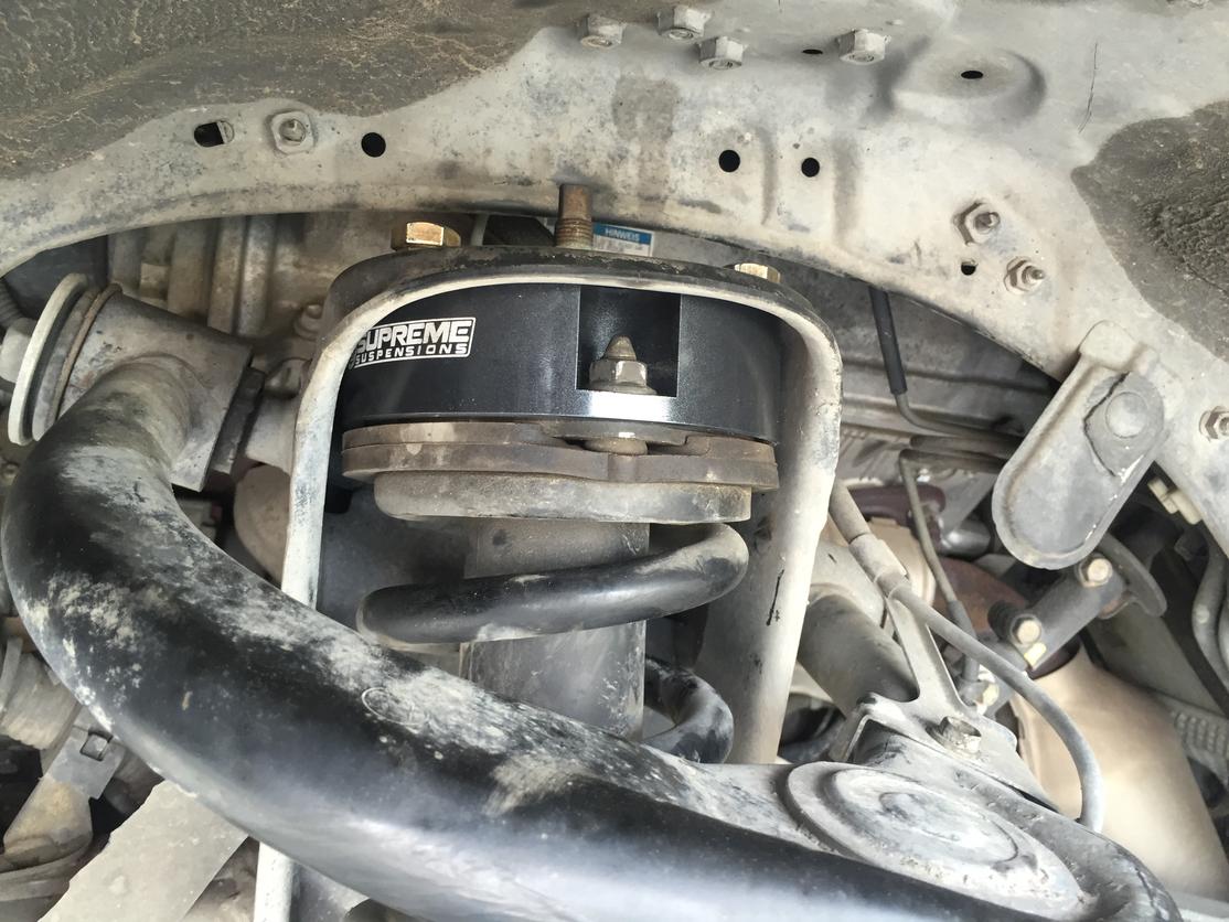

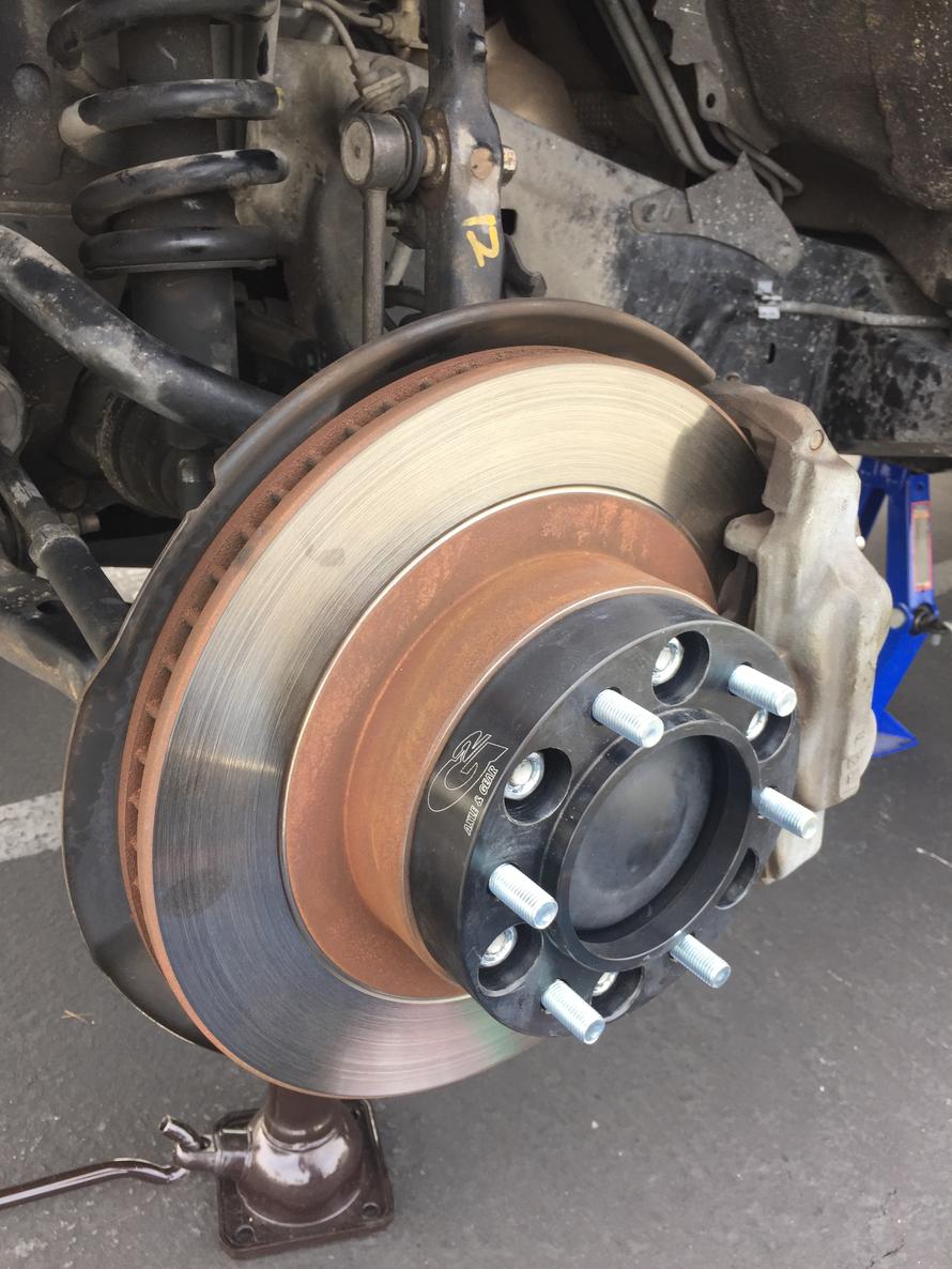

I have installed :
Supreme Suspensions - 3" Front Suspension Lift CNC Machined T6 Aircraft Billet + 2" Rear Suspension Lift Heavy Duty Polyurethane Toyo spacer
G2 1.25" wheel spacer
285/75r17 NITTO TERRA GRAPPLER G2 tires
I have had to do a significant amount of trimming to the point of almost completely deleting the inner plastic wheel well. I still have a little rubbing that I need to sort out and i am going to have to do a slight body chop and re-weld. Only thing i am worried about now is at max travel whether my wheels will rub on anything else. Looks like a fluid basin on the front passenger side wheel could get destroyed at full compression on that side.
Has anyone else put tires of this size on their runner? If so what did you have to do to make it work.

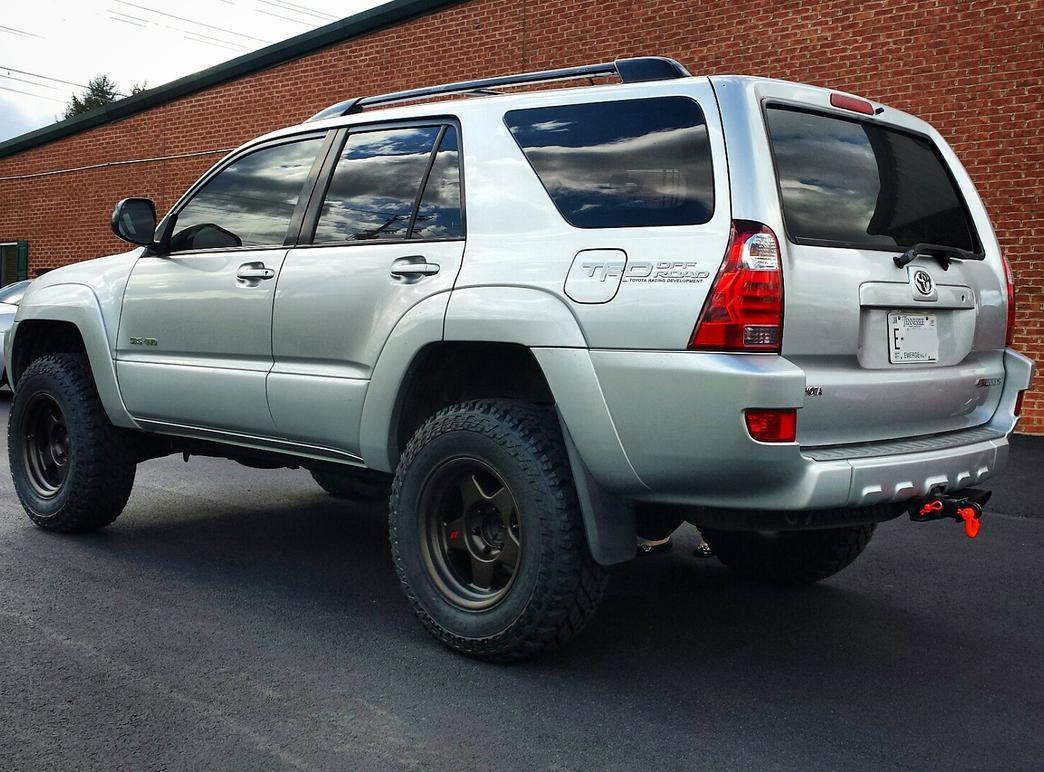

Icon lift and UCAs, SCS dark bronze F5 wheels, and 255 80 17 Cooper stmaxx

Holy moly those are tall, but I had to do the same, be extra careful going through deep water. Since I had to cut so much to fit 285/70/17 with NO LIFT....after I lifted my runner and down the road I go through a creek which wasn't so deep, water went in through the fender well and there goes my motor sucking up that water and it locked up.
But I believe your tire is about a 34 inch tall tire. It most likely will rub in other places when flexing out the suspension
