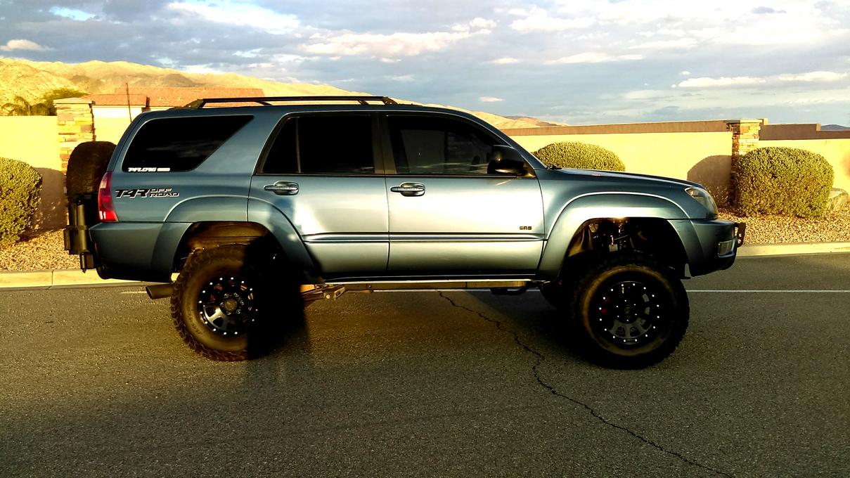

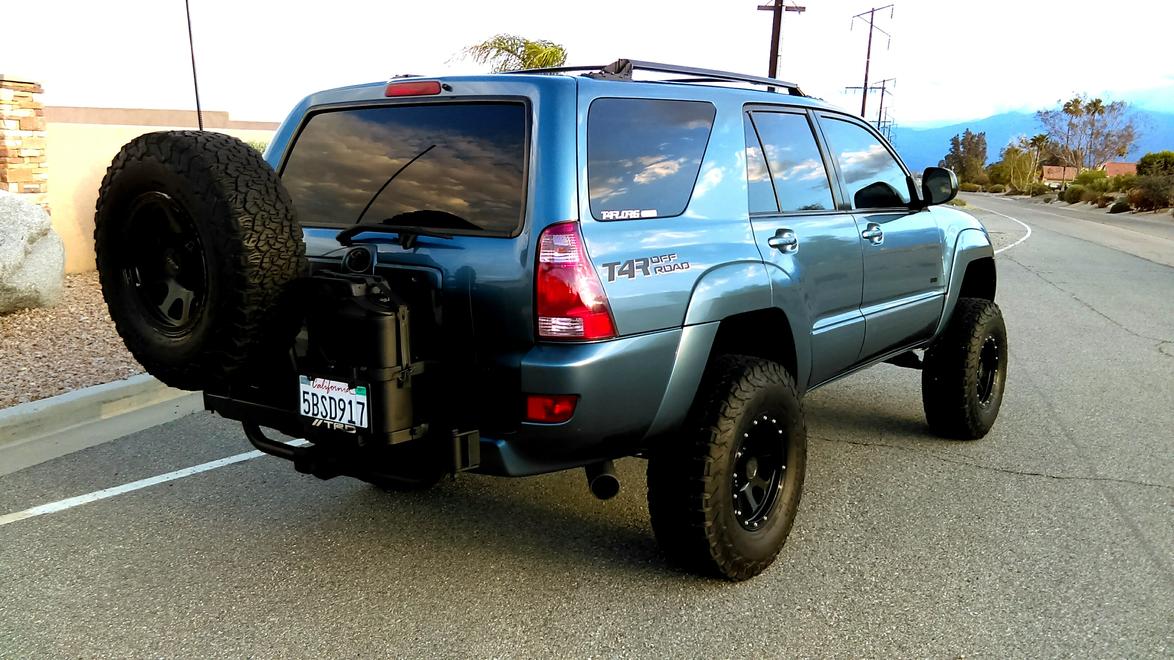

Nothing special here. Thinking of removing the mud flaps in the front and rear, not that it rubs. But maybe a better look?
Bilstein 5100
FJ 4x4 Trail Springs
265/70/17 BFG KO2
Great looking rig! What setting are your front 5100 set at?

5100's all around
Front 4wd FJ Coils and bils set on second perch
W/4" Lift Spindle's
Rear 4wd FJ Springs and 1.5" Daystar spacer
Tires are 285/75/16's (33") w/1.25" wheel spacers front and back
Installing this week 3.5" All Pro lift springs in the rear and Toytec 2" front coils

You went up a notch on your fronts?
Let me know when you get the 3.5 in the rear, can't wait to see it.
Well here is the reason why, I did the driver side up one last week to fix the 4Runner lean at our height it seemed to stand out more to me and when driving looking out over the hood I can see my rig slanted and when parked looking at it from the front you could see it clearly, so "that's what people see when I'm coming at them or sitting at a light"? I think to myself "oh hell no". but not so much from the back due to the spacer I'm assuming.
So I went up a notch to correct that. It worked and looked good put level on it and good to go... I thought, well I was as far as being level but it caused problems for me inparticuliar having one up higher than the other with body mount chop, no sway bars, and worn out strut top plate mount and cracked,flattened rubber mount isolator would cause the passenger side to make a pop kinda sound when doing a turn then kinda of a thud with a slight side shift on the front end when straightening back up out of the turn, well then periodically just every so often this depending on my speed of this turning event combined with side shifting on the front would make my locker think and react to engage for a slight moment only because the front only shifted out of a turn so once straight the locker let off so in that couple second window she would wind up but as fast as she wound up it had to let off so that quick burst of torque would result in the rear doing its own quick side shift with a thud out of a turn. Didn't cause any danger to steering or put in harms way it just woke you up, what the f was that? So I caught its pattern and then figured out the root cause ...me and ocd of looking right, and my blown out original strut mounts with over 250k on them hahahaha. So up to the second perch with the passenger side she went and all problems stopped.
What's really funny is literally just now my new driver and passenger side strut mount complete kits just arrived ..go figure.
Wasn't expecting a novel from that ...kinda question mark,did ya? Lol
And yes would be the first to know and see what the all pro's will do. Fingers crossed, brotha.

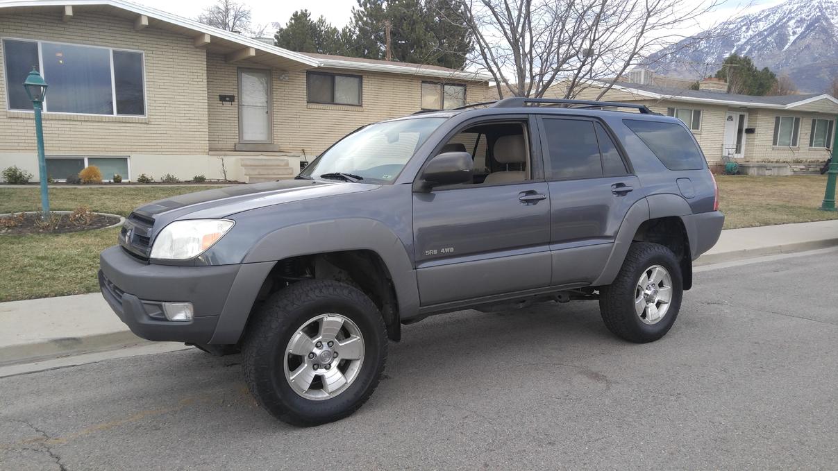

So, to clarify (For those that are trying to decide on a lift)... The rake you see on my truck is caused by using the Toytec Superflex 2.0 HD's, not the standard 2.0 coils. I should have double checked the order before installing. I'm going to be swapping them out tomorrow, and will post some new pics when I'm done. It should lower the rear significantly, as the HD coils are meant to provide 2.5" lift with 400 extra pounds. lol. Hope this info is helpful

i will be honest, the old owner replaced it before it sold to me, and forgot the setting. but i did measure ground to fender from a stock sport and mine. I am 3 inches up front and .75 in rear. hope that helps.
