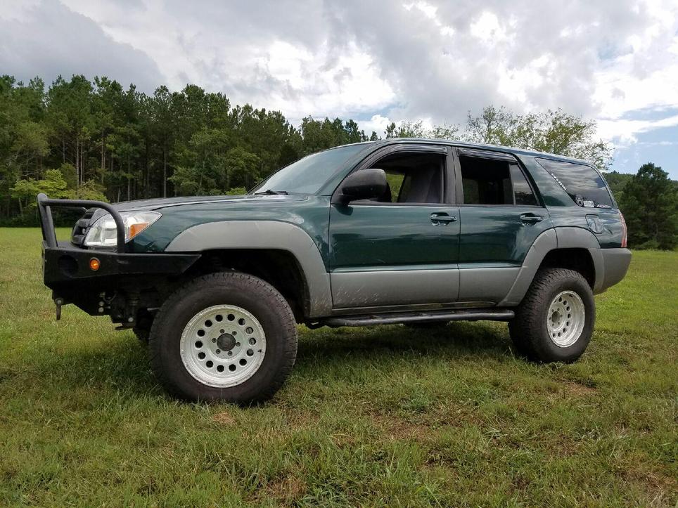

Recently purchased 06 SR5 w 110k on the clock. Talked myself into a modest discount as the shocks and struts were gone, which was great because I was planning to replace it all anyway. Today had the Toytec 3" lift with 5100s and Toytec springs all around. Here's an after pic, plus some crappy iPhone photos for a before/after comparison. Loving the change.
Previous owner installed 265/70/17 Goodyear Wrangler Authorities.

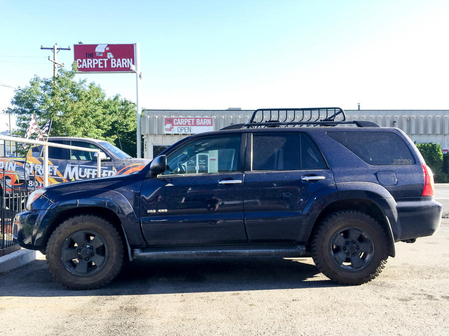

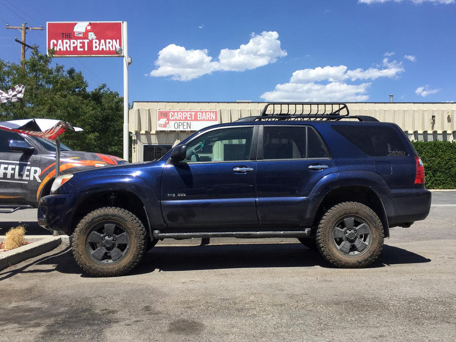

2007 Sport Edition with XREAS. Before and After. Cornfed Lift 3"/2". Fuel Maverick 17"x9" with -12mm Backspacing. Toyo M/T's 285/70/17's. Had to pull front side of fender liners forward and trim just a little edge on the front side of the bumper cover.
IMG_2388_zpssmptgvdv.jpg~original
IMG_2396_zpskul80pif.jpg~original

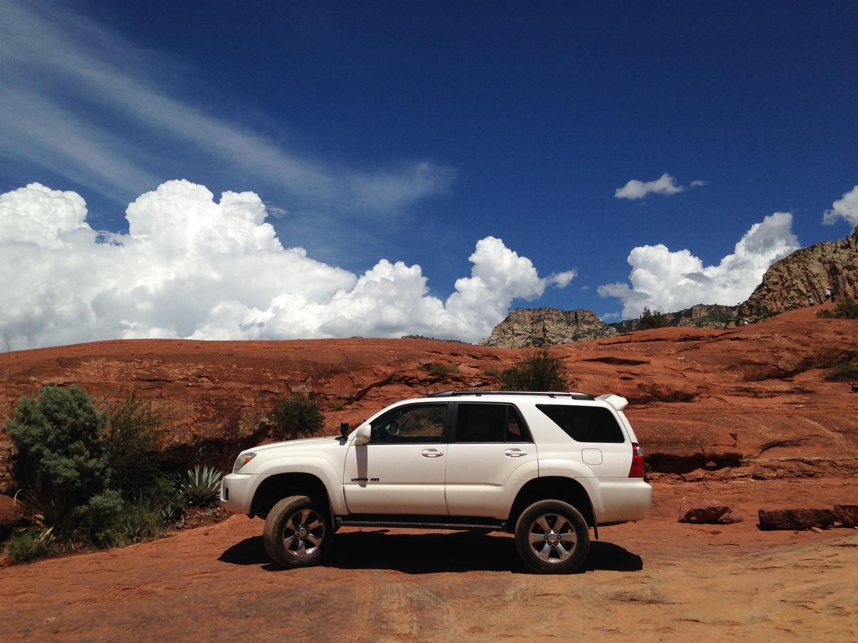

Wheels- FJ Steelies
Tries- BFG KO2 265/70
Installed suspension a few weeks back.
Front- OME 884/5100s set at 0
Rear- Superflex/5100
Before:
IMG_0200_zpsetldqzr7.png~original
After:
IMG_0338_zpsx1noixww.jpg~original

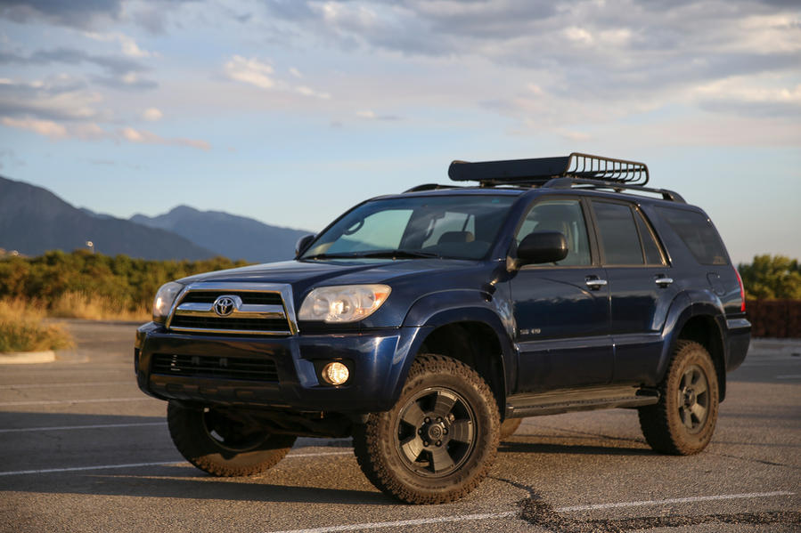

[MENTION=144934]cold_beer839[/MENTION] are your tires 285/75/17 or 285/70/17? My guess is 285/70. 285/75 are basically 34's. Looks good
285-70-17 BFG rugged trails on 17x9 Weld Rockcrushers. I wanted some new black wheels but these were cheaper and they will get the hell beat out of them anyhow.
