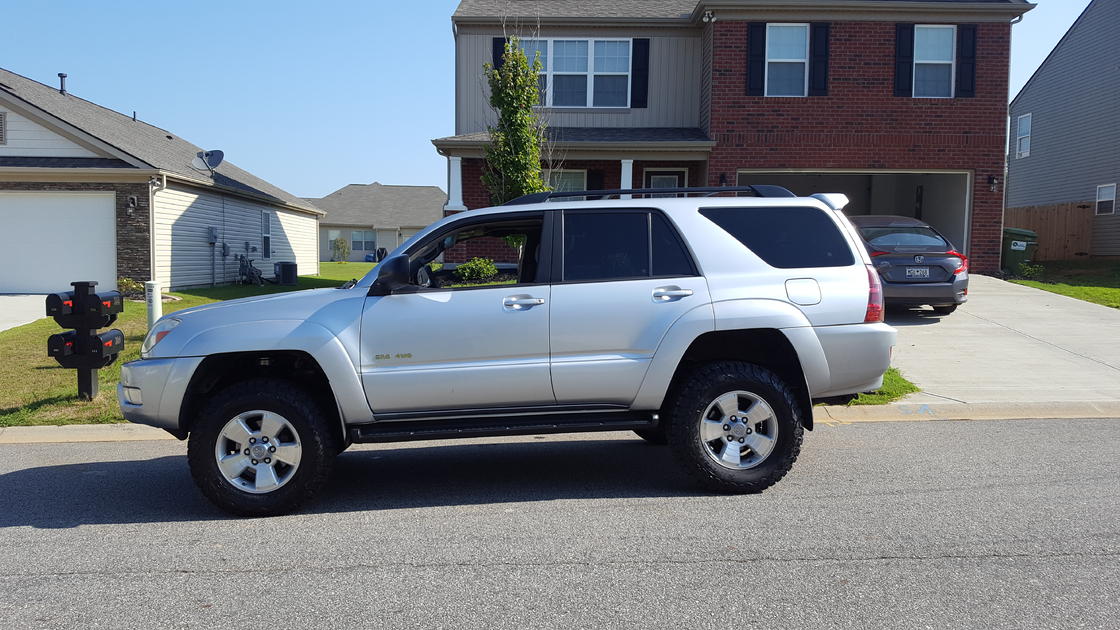

2004 V8 4X4
Suspension
All stock other than FJ3-RCC - 3" FJ Lift Kit W/Spacers & Rear ToyTec RCC2.0 Coils
Tires
265/70/17 bfg ko2

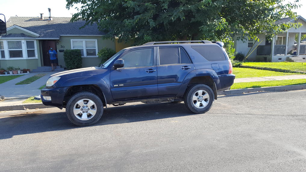

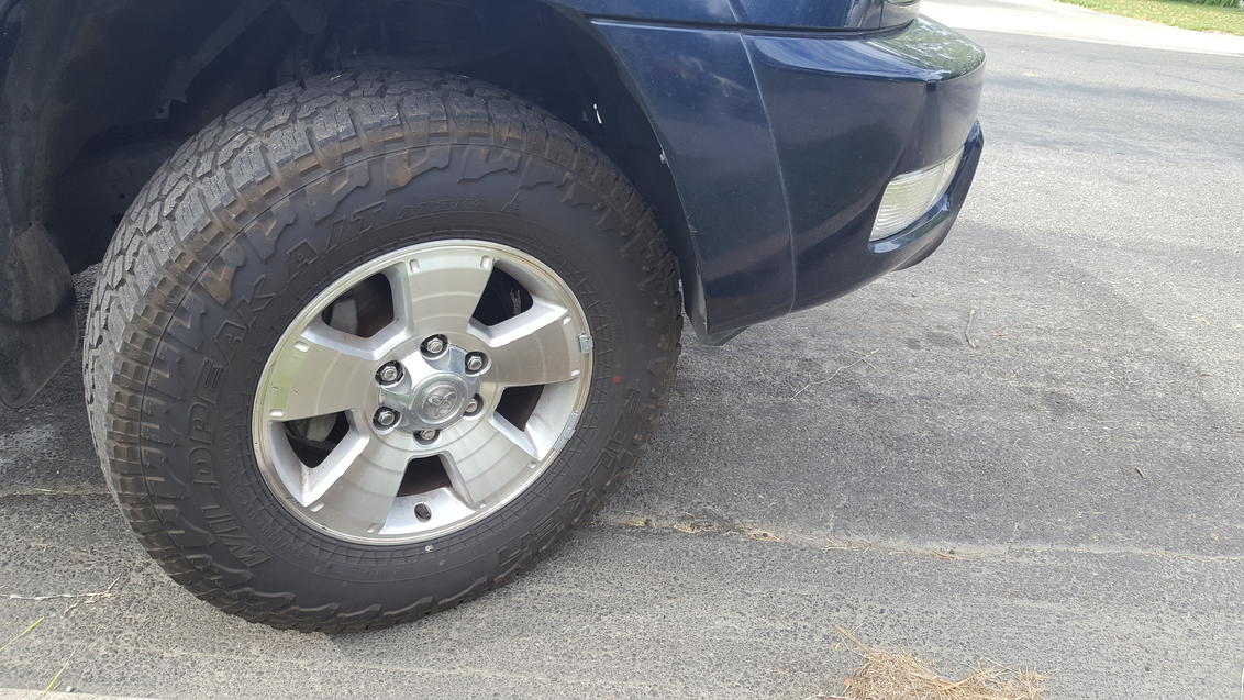

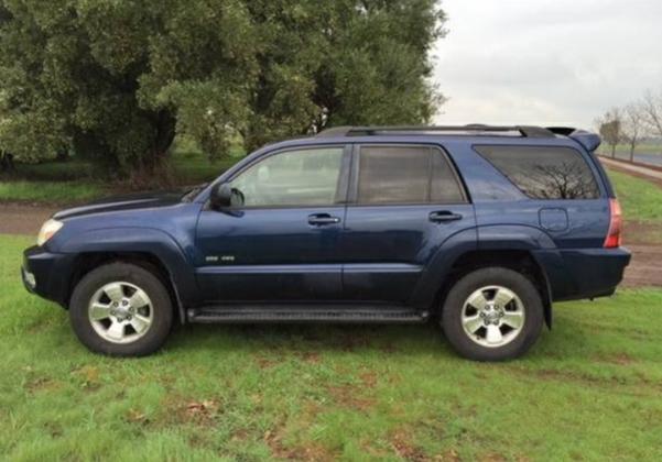

So i finally got around to putting my daystar 2.5/1.5 on. Didnt really want to go with spacers, but thats what was in the budget for now. Got 265/70/17 Falken Wildpeak AT3W and was hoping to not have to trim at all, but somehow they're rubbing? I did my research and figured it wouldn't rub, but it does on turns and in reverse while turning. Suggestions on how to approach the trimming situation? Anyways it didn't turn out quite how i wanted it, so ill probably just do the whole suspension next and go a little bit higher when i can afford to do so. Next on the to do list is get an alignment and put on my diff drop kit.
+ it's been idling at a very low rpm since i installed the lift kind of up and down, anyone else have this problem?
(I'm not the most mechanically knowledgeable so any tips/advice would be helpful and appreciated)

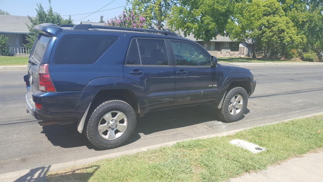

This is the picture that was on on the craigslist ad when i first bought it, since i didnt take any pics of it stock:

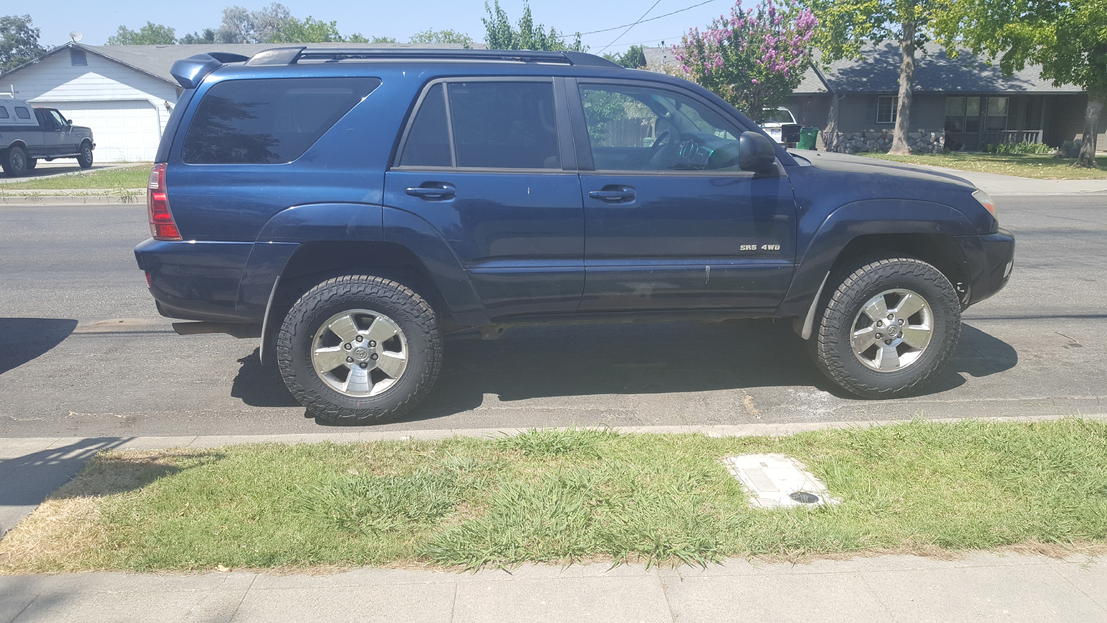

Right after the lift, but before the tires:

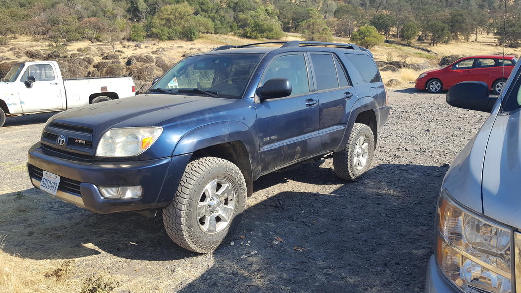

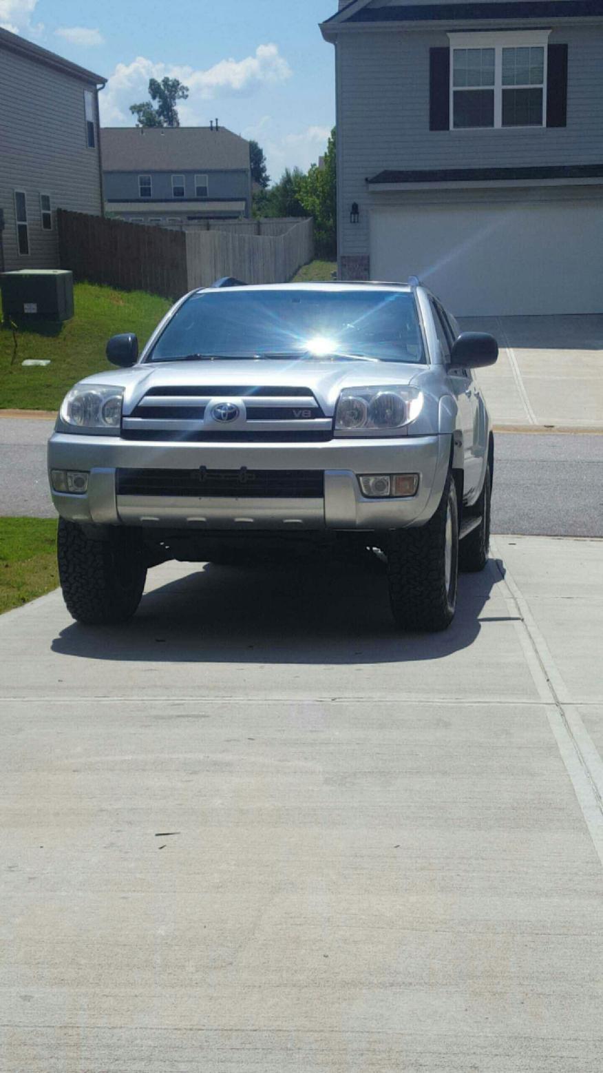

Lift + new tires

Where are you rubbing? Fenderliners can be molded once slightly heated (torch, hair dryer etc), you can also unscrew them and pull it forward and add new holes in the liner (fairly intuitive once you unscrew the liner)
I am running the same combo, was rubbing on the frame at full lock, I ended up picking up a set of FJ cruiser wheels to fix it. (5th gen wheels are cheap and also work the same as the FJ)(As do most aftermarket wheels, just more $$)
In this do you mean 5th gen wheels have higher offset? I'm trying to piece my build together before I start making moves and really like the 5th gen ones but want to make sure that in the end I am not going to need spacers.
4th gen has a 30mm offset. 5th gen/FJ 17" wheels have 15mm offset. The smaller offset pushes the wheels out a little more than 1/2" per side. Most aftermarket wheels I've seen will push the wheels out closer to 1" per side. (0mm offset) Spidertrax is another option, but not my personal favorite as it adds an additional point of failure.
See attached, pretty much flush inside the wheel well with FJ wheels. ~2.5"/1.5" lift, not really any rubbing worth mentioning after adjusting fenderliners. 265/70R17 Falken AT3Ws

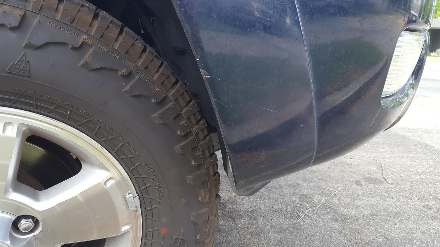

Its not even compressed at all and its less than half an inch from the front fenders when all the way turned. I'll look into your suggestions. Here's some pics:

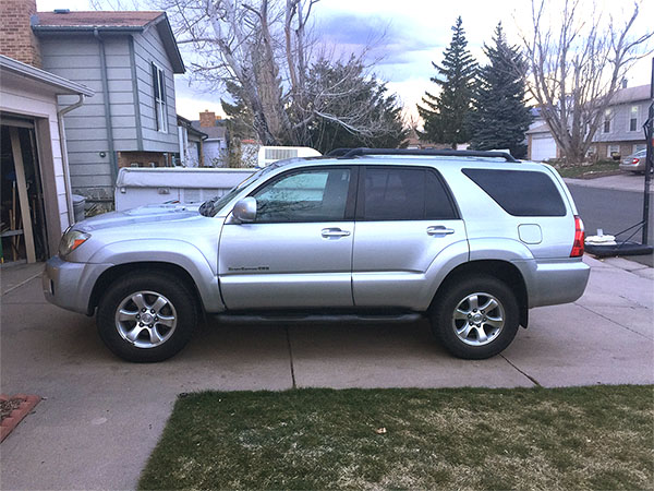

Finally put on my lift this past weekend. Bilstein 5100's on all 4 corners, OME 2895 Coils in the back. Stock coils in the front with the 5100 set to the tallest setting. Stock tires for now. And Spidertraxx.
Got about 2" in the back, almost 3" in the front. Love the way it rides. Those Billies are legit.

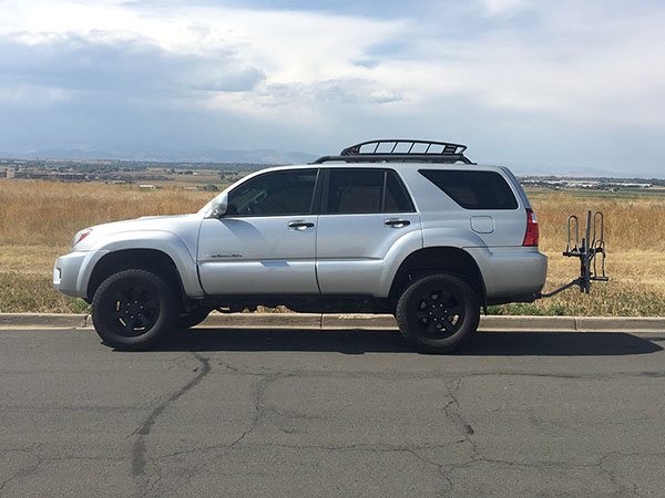

Moved to Colorado 2 weeks ago and finally got around to installing the lift, tires and wheels on my 06 Limited.
Lift:
ICON Ext Travel Coilovers
Total Chaos UCAs
ICON 2.0 Shocks
ICON 2" Rear Springs
Tires:
GY Duratracs 285/70/17
Wheels:
SCS Ray10
Had to do some body mount choppage and fender liner cutting/removal to stop the rub. One of these days I'll create build/adventure thread for now enjoy these pics.
Stock:
Lift installed:
As she sits today:
Bonus pics:
Sent from my SAMSUNG-SM-G920A using Tapatalk
These Ray10's look badass on the GG. Did you have to custom order the bolts to be painted black? it looks like they are silver on the website.
