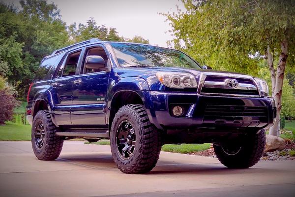

Long time lurker, first time poster. I've gotten quite a bit of help from this forum over the years, thanks! I would have posted a pic three years ago when I did my lift but I chickened out and didn't put on the tires I really wanted so the pics were kind of underwhelming. Those tires finally wore out and I feel I've now got something worthy of posting.
285/70/17 Goodyear MT/R
Ultra Bent wheels 17x9 +12 offest
Toytec/Bilstein in the front with OEM/Bilstein in the back
Spidertrax spacers
Notes/realizations:
  • No the spare doesn't fit, but it's oh so close. Had I gone with the Duratracs, maybe?
  • The wheels actually come with the proper 106.1mm bore so no need to worry about centering discs.
  • Lots of trimming, still more to do. Most of the plastic rubbing is easily fixed with a belt sander. Nothing but more lift or the frame mod is going to keep it from hitting the frame on the backside of the wheels though.
  • The Spidertrax offset negates the stock Toyota wheel offset. 1.25" = 30mm So a 0 offset wheel would have the same effect on the stance as Spidertrax
  • My suspension was so worn out when I did the lift, the combined effect of the new suspension and tires was close to 6" in the front and a little more than 3" in the rear.

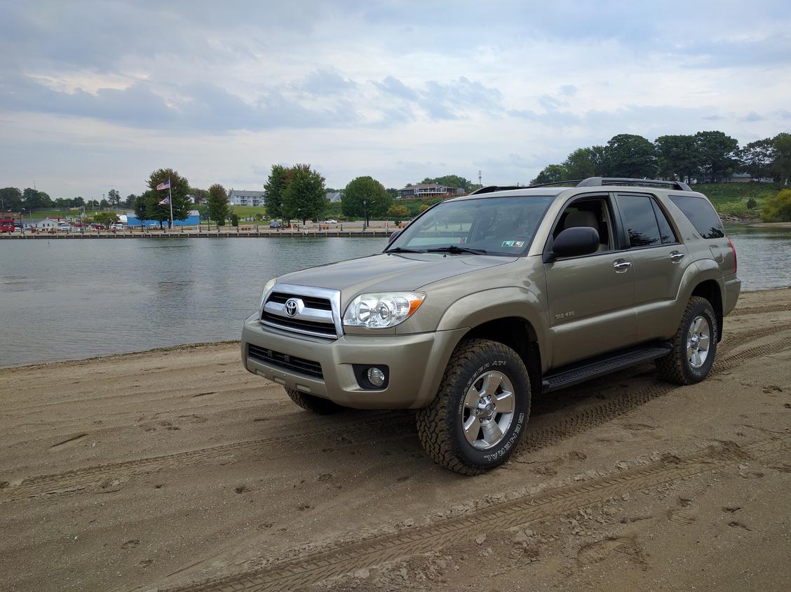

Here's mine. FJ springs and Bilstien 5100's all around. Front set to 1.75. I like the slight take but I think I my go up to 2.5 in the front and some slightly taller springs in the rear.

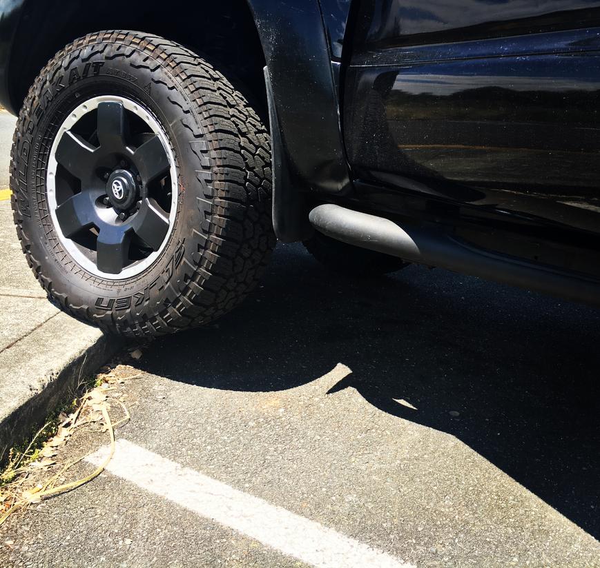

After adding 265/70 BFG KO2 and FJ cruiser wheels powder coated black chrome (looks more like gunmetal).

The gunmetal looks great! When/If I need to redo mine, maybe I'll go that route.
Front mudflaps gone? Rubbing?

I never had front mud flaps. I do have some minor rubbing at full lock but I think that's because I asked the dealsersgip to max out my caster so my front wheels are sitting far forward in the wheel well.
I like the gunmetal, but I kind of wish I would have stuck with my first choice...gloss black.
That looks like the same lift height I have when looking at the wheel wells, maybe it's just my photos make it look that way. I'm very happy with how mine looks now, I plan to keep it this way, much better than stock.
I think mine looks lower due to the plastic running boards. I've been wanting to take them off, but the wifey...:lalala:
Yours looks good man, with both setups.
