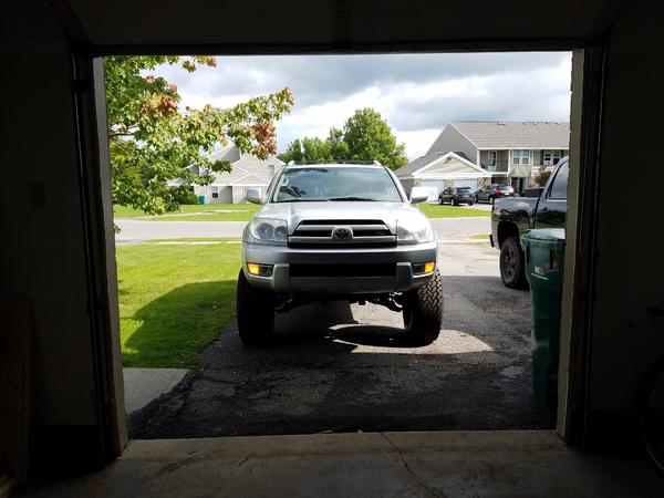

got the lift finished today.
Front:
Bilstein 5100s at 1.75
ome 885
spc uca
rear:
Bilstein 5100s
ome 895
ras to coil
wheels:
Black rock 17" steelies
285/75/17 general grabber at2
1.5" spacers
also have a 2inch fat pats body lift

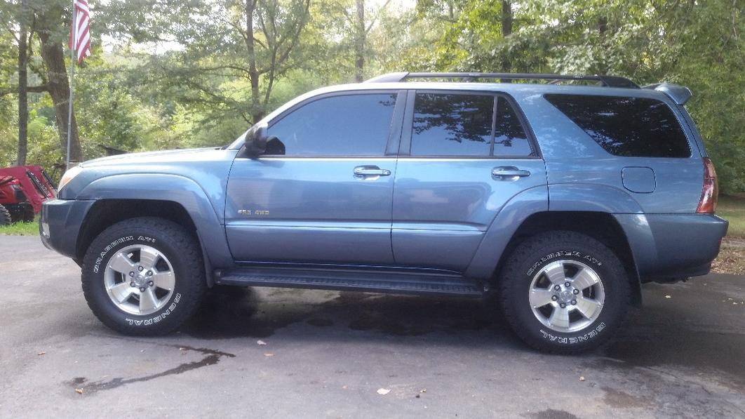

I really like the tread design and ride now. The tread on these is really similar to the Duratracs.
05' 4Runner Sport V8
Trail Gear Sliders
3" Toytech spacer/coil lift
New style Big O AT 285-70-17 tires
Spidertrax wheel spacers

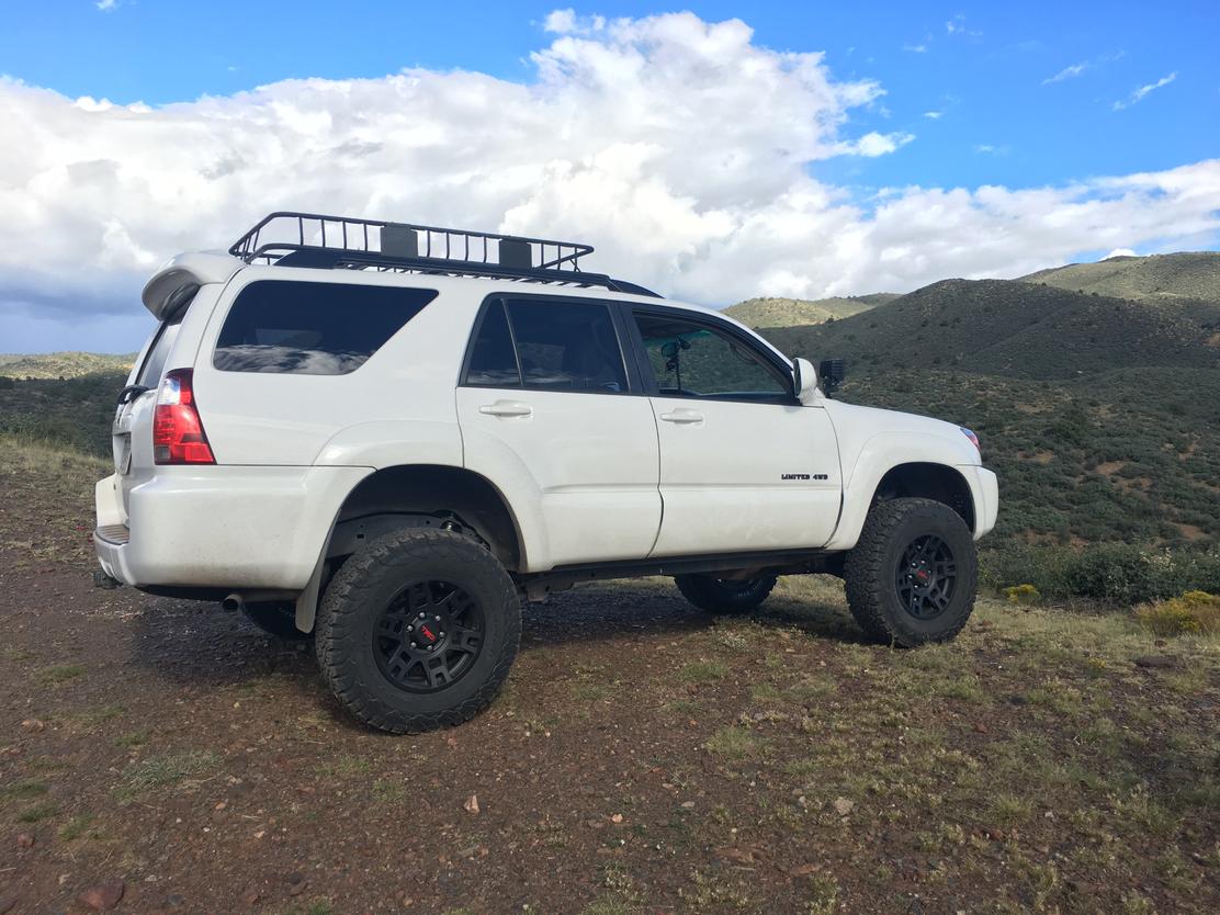

Replaced the worn out stock suspension the other day with 5100's all round, OME 883's up front on the lowest clip and Wheelers Offroad T12's in the rear. The T12 springs are a replacement for the Sway-Away 1.5" lift coils. Visually its a big improvement (no before photo sorry) but it still looks quite stock like which I'm happy with. I prefer the raked look and it retains that, so that's good when I'm loaded up. Hub to fender measurements are 22.5 and 24.5 inches.
The Bilstiens ride ok. They handle rough roads very well, but I'm undecided if I like the rear performance. I'm not sure the valving is appropriate yet....
Anyway, thought I'd throw up a pic in case someone is researching this combo for themselves.

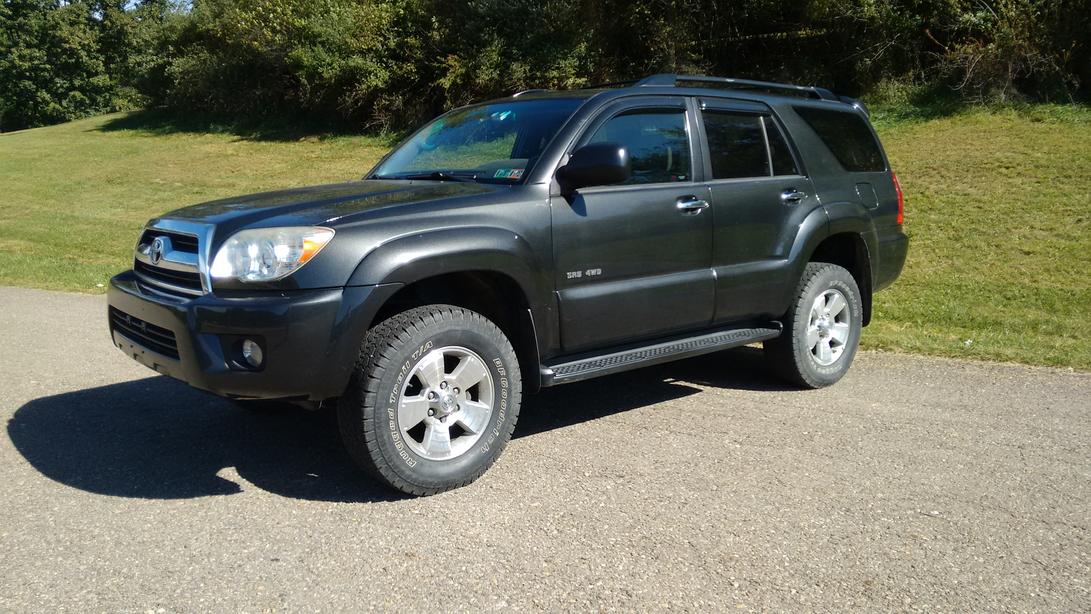

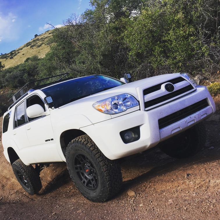

New treads. P285/70/17 Wildlpeak AT3W. Only 500 miles on them but absolutely shocked at how quite they are. Love them so far.
Looks great! Rub? Taken them off-road yet?
I have those in 265/70 and have 5k on them. You'll love them! Wish they were offered in 255/75 or 275.
P285, means they are no where near E load. P stands for passenger, good ride. E are LT tires.
[MENTION=63543]CrimsonCountry[/MENTION] was smart a few years back and got out of the rough ride :-).
Sorry, I missed the P. Yeah I'm familiar with what E is, I'm trying to hear from someone running E's. I'm conflicted between which I should buy. My main concern is puncturing a tire on the trail but if it will mean 15 mpg all on their own...maybe I can deal with P's. I got word direct from falken that both the E and P are two ply sidewalls but the E's are reinforced and have deeper more durable treads. The guys said the P's will show wear faster.
