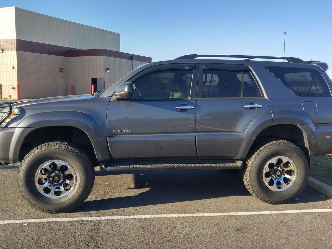

Daystar 2.5" front spacer and 30.5" KO2's. Looks and rides fine until I am able to upgrade!
Hey everyone. I am new to the site but been lurking for a while. Yesterday, I put on the daystar 2.5 and 1.5 on my Runner and also put some Cooper Discovery A/T's. Have to say I love the way it stands and just thought I should share.
