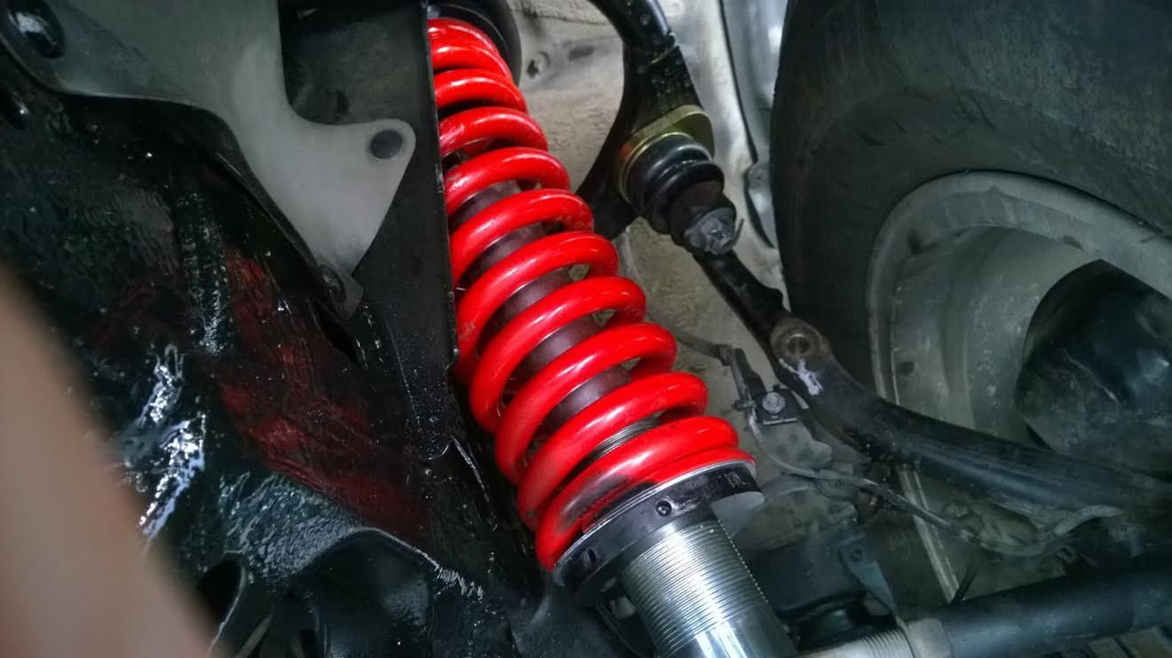

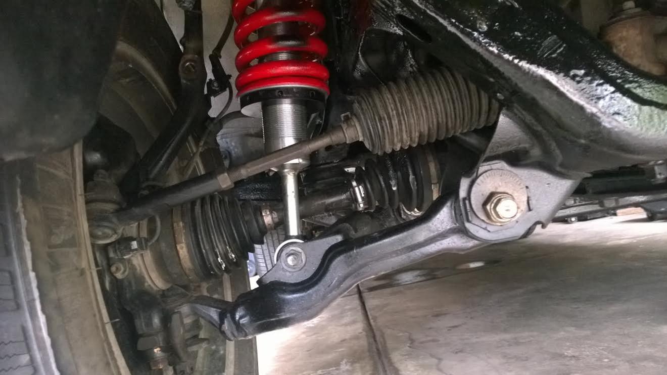

Hey! My first pic post. 2005 limited, 125K, I installed a boss 3 inch today. I have some concerns about the lack of clearance between steering knuckle and tire. Stock wheels and 265/65 r17s. I read a ton before launching off into this myself and I never read anything about this. Any ideas? Haven't had it aligned yet, but I can't see that much adjustment being possible.

You're at 3" with the Boss using stock UCA's, I have Boss on both my '07 and '08.

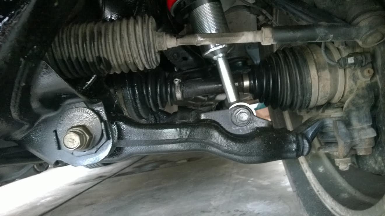

On the '08 I put SPC UCA's on so I could boost the lift up to 3". Here's a pic of the SPC UCA's with the Boss kit. The SPC's you move the balljoint inward and it gets that spindle inward. The pic is with stock 265/60/18 wheels and Mich LTX tires.
I'm far from an expert, but your CV angles don't look too good also. My belief is if there are a bunch of boot fins touching you have bad CV angles. Again, I'm not an expert but possibly the aftermarket UCA's help with the CV angles also. I'll add pics of my current CV angles also, I'm at about 2.75" lift with BOSS in front

Flip flop, thanks for the info and the pics. Yeah, I've got something wrong. I do have the diff drop kit installed. My BOSS kit is second hand, so 1. I don't really know the current setting, and 2. I don't have a spanner wrench to adjust them!
I measured my change at just under 3 inches and have read enough install stories that went to 3" with no issues, I'll reduce the lift and see if it straightens things out some.

OK, so this is pretty embarrassing, but I got it figured out. Second hand BOSS kit off of a Lexus gx470. I assumed that the max possible setting was the 3 inches recommended not to exceed. Further, I assumed that the coilovers were set to that 3 inch mark.
I jammed them in and observed all the crazy clearances. NOPE! I had lifted it 4 inches in front, thus jacking the steering knuckles and etc. I backed it off an inch and the clearances look a LOT better!

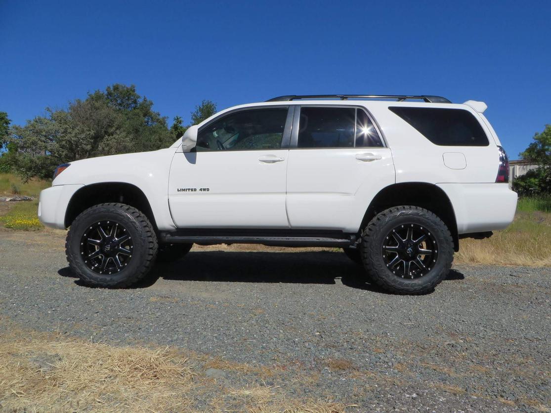

Jason
2006 Limited V8
- Stage II Icon w/ Tubular UCA's
- ADDCO Front/Rear Sway Bars FJ extended links
- 285/65/18 Toyo R/T's
- 18" Fuel Maverick in Gloss Black
- ToyTec Diff Drop Kit
- Euro/JDM style Headlights/Taillights

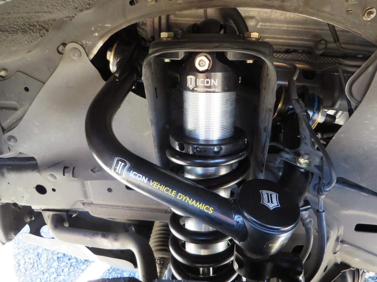

Having just done a 3 inch icon lift, Im asking myself the diff drop question. Both the cv boots are torn and I have OEM kits ready to be installed. But still wondering if I should purchase a toytec diff drop kit.
